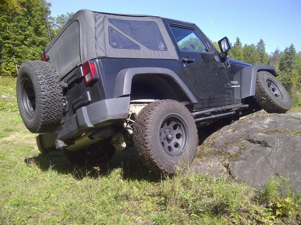

Not the best angle, but here is my rear G2 diff cover:
