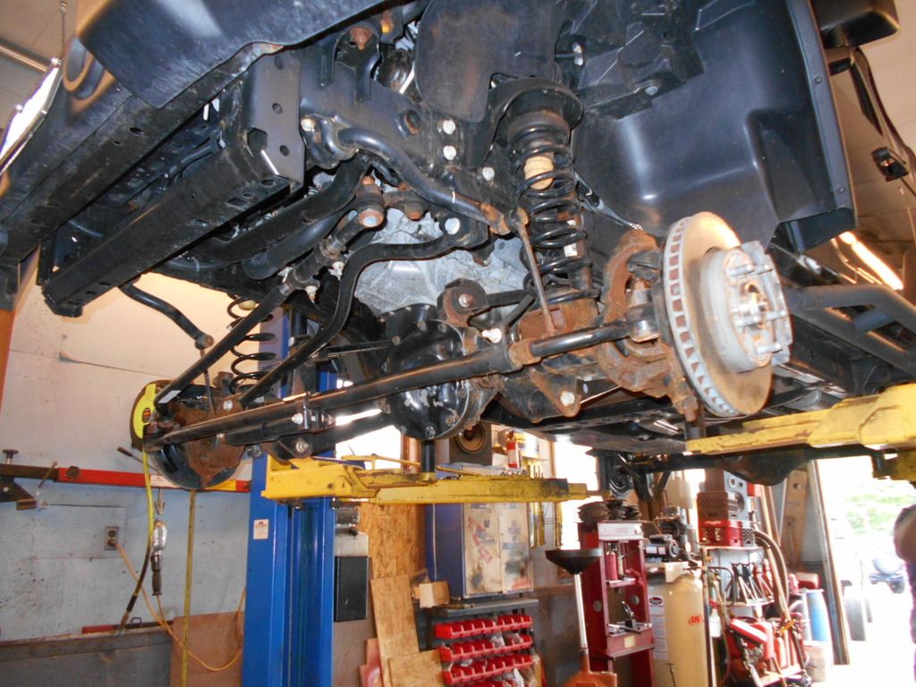

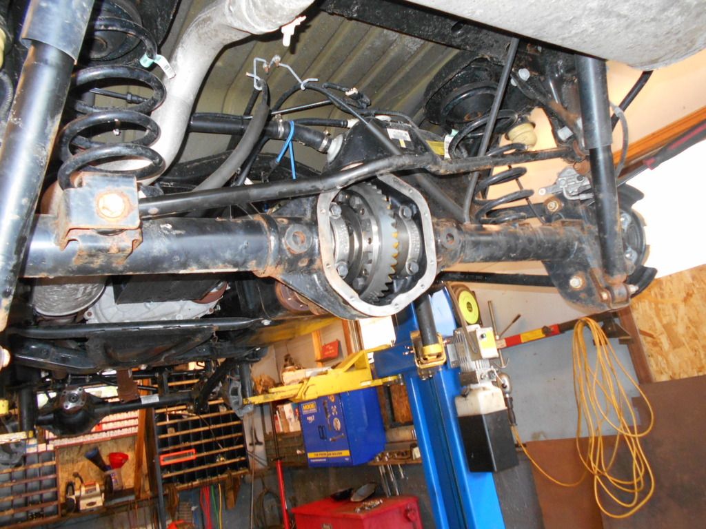

The JK went on the lift yesterday to get new gears and the shop was kind enough to take some pictures for me. It's a 2014 with less than 20k miles, one NH winter under its belt and the axles and joints are riddled with rust. What are you guys doing about rust prevention? Short of sanding down the rust and repainting, is there a better cost-effective way to do this at home? Thanks!

I am sure glad you posted the photo. I ordered my 2015 Willys and had it Ziebarted at the Shipping Port in Baltimore, three days after it came off the assembly line. The Jeep arrived here in Bahrain and the Jeep and I will be transferring back to Maine during November, just in time for salt and sand season. It may not be too late to address the issue.

My last JK (2010 w/ less than 40,000 miles) had very similar rust. It appears that the Jeep factory doesn't do a very good job rust prevention on its undercarriage. I like the reviews the POR15 is getting but really want to know if I have to clean off all the existing rust for it to work, or will be okay if the hard to reach areas are just painted over?
