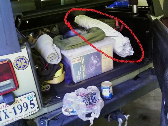

I lay mine so they're both face down, with the forward (rigid) edges together.
I have a hospital sheet (like a "single" bed sheet), and I lay the first window down on it, lengthwise, near the corner. (with the sheet lengthwise, too)
I fold the sheet over it, then lay the other window down on top of it
Then, I roll them both up beginning with the rigid edges. This way, neither window is bare to the outside, and neither is touching one another.
Here's an okay pic of the result. They stay in the back lockbox all summer long, and they still look like new.
I hope this helps

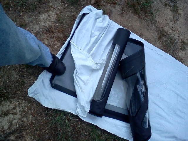

Here's a snapshot. Never mind my foot, but they've been rolled up tight for a few weeks, and tend to take that shape temporarily!
The two forwardmost edges(that fit inside your door surrounds), with the unbendable plastic, line up together, and form something solid to start rolling with. The bottoms of the windows are plastic, too, but they'll bend and rollup. Think of it like a sleeping bag...
