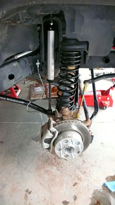

On to the front. Shocks and sway bar links removed.
Trackbar removed. Again, the new one is stout.
Teraflex bumpstops installed. They measure just under 3".
New trackbar installed.
Control arms and springs installed. The front spring installation was possibly the most challenging part of the install. The 3" bumpstops on the bottom perch made it very difficult to put in. We used some spring compressors rented from O'Reilly's (free) to get them in. I don't think they would've gone in without them.
Rock Krawler RRD 2.0 emulsion shocks. I went with these because I wanted a quality shock that is tough and rebuildable. For now, I chose to stick with the stock valving, but valving can be changed upon order or at a later date. It's also capable of accepting a reservoir if I wanted to add one later.
Sway bar links and shocks installed.

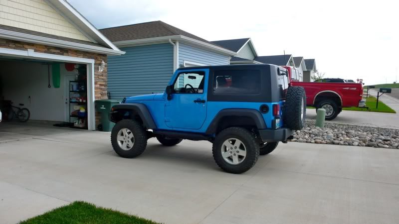

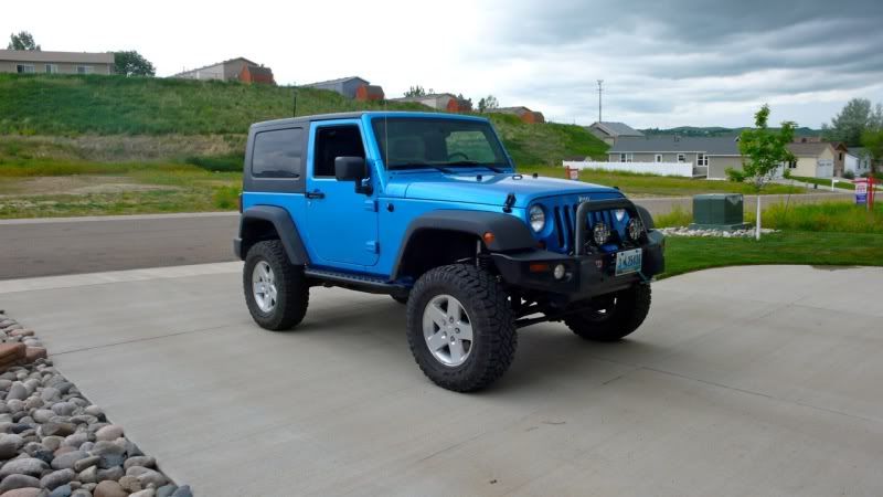

Here's the final result.
I've only got to ride it around town today, so only driveway shots for the time being. Planning a trip to the mountains maybe next weekend and a offroad competition in a few weeks. I'll post here if I get some pics.
The ride is incredibly smooth. There's much less body roll, and it feels like I have much more control of the Jeep than I did before. Any bumps are almost instantly absorbed without rattling the Jeep. Tight turns are handled well and are easier to manage.
I tried to drive as aggressively as possible around town and a short stint on the highway, but needless to say, I haven't got to comprehensively test the system out yet. From what I've seen today, I'm incredibly satisfied with how it drives and look forward to some more serious action.
