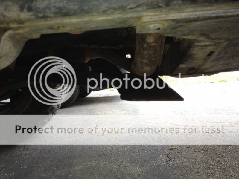

Just to add, I know people do better with pictures...
This was after ONE trail ride on what I would consider a moderate (5-6) rated trail. I usually only play with 8's and 9's.

Are those steel?

Yep, steel

Ouch - that's not fun. Thanks for the info and pics.

A 5-6 trail can be done in a STOCKER? 8-9 is about a 4-4.5 hear we use the 1-5 scale not the 1-10. I run lighter side of 4 trails and every once in a time ill follow our HC group if i feel stupid.
For you to do that on what we call a 3 rated trail. Is way out of normal, much more to this than you are telling. I have had my Jk through 4.5 the damage was every where else but the RR skide. If you got a rock there that big and fell on it hard enough to do that how did it get past the rear axle and any thing else with ripping the heck out of everything else.? You running the hammers?

This isnt the first case of this there was a guy on jkforum that high centered on a boulder and the same thing happened, there is no reinforcement behind the RR skids its only a sheet of metal.. I have high centered on my stock skids and they have held up better than that.
