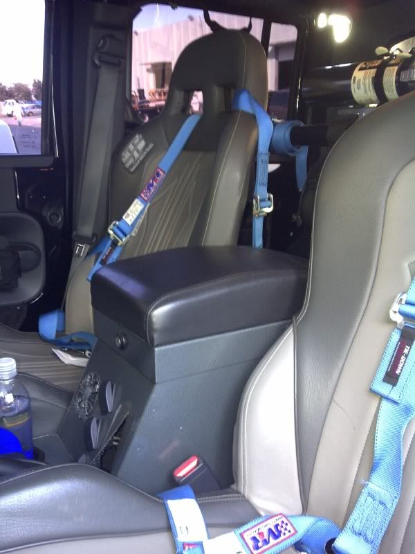

The real questions are: what seats are you getting? are you getting 5 point seat belts? how about some pictures?

My seats are from Twisted Stitch... Vortex-XL model. The XL doesnt recline, but you can get XLR's that do. No sense in reclining mine since there is a harness bar right behind the seat.
I am using M&R Racing Rotary Cam Release 5 point harness but I also adapted the factory seat belt for normal driving and light wheeling. The 5 point belts are really restrictive and don't really allow you to look around much out the door/window when crawling... Use them mainly for the steep climbs/descents and any higher speed stuff. They give you a much more confident and "Safe" feeling than the factory seat belts, that is for sure... they keep you glued to the seat.

That is one sweet looking interior Hitmoney.

Is that the tuffy full console? If so...can you post up a few good shots of it? Sorry to distract from topic...

No, that is the Max-Bilt console.
