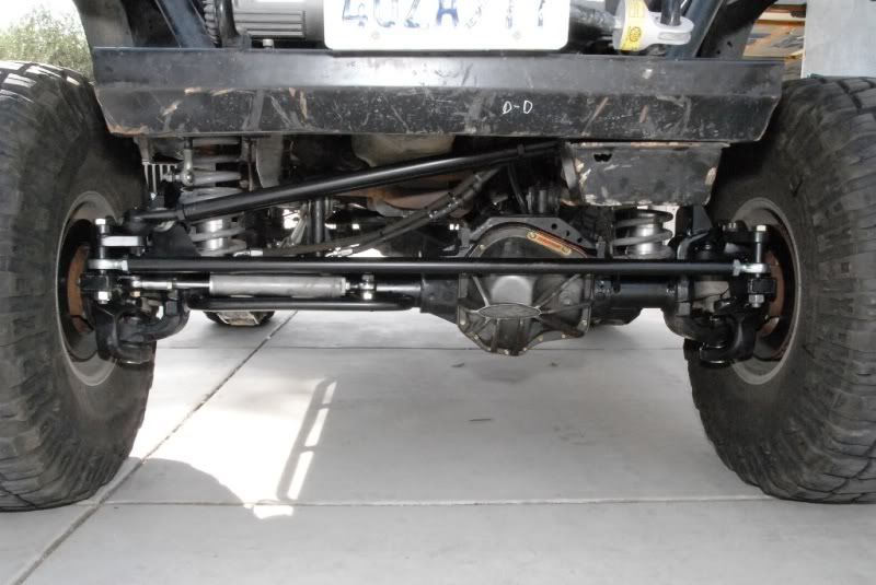

Originally Posted by wranglerboy13 View Post
I hear "it's not necessary right away" and I get confused. Does that mean if money wasn't an issue than you wouldn't put a high steer kit on or you can live with it. I worry about my girlfriend driving it to be honest. Hopefully she doesn't read jeep forum haha. If there were any kind of driving quirks associated with driving my jeep lifted (flighty steering, bump steer, etc) I wouldnt/shouldn't trust her to drive it and that wouldn't be realistic. I wish I could find someone local to me that has a minimal 3 - 4" lift and see how a "cheap" lift feels and I could go from there. I have no idea how a lifted jk drives haha.
The receipt for good steering is to keep the drag link and track bar the same length, parallel and in the same plane. other factors, like caster, come into play as well...
here's an example:
notice how you can hardly see the track bar? it's perfectly behind the drag-link. That's how it's supposed to be.
here's more info from a steering guru (mrblaine on this forum): http://www.pirate4x4.com/forum/jeep-...l#post11091762
