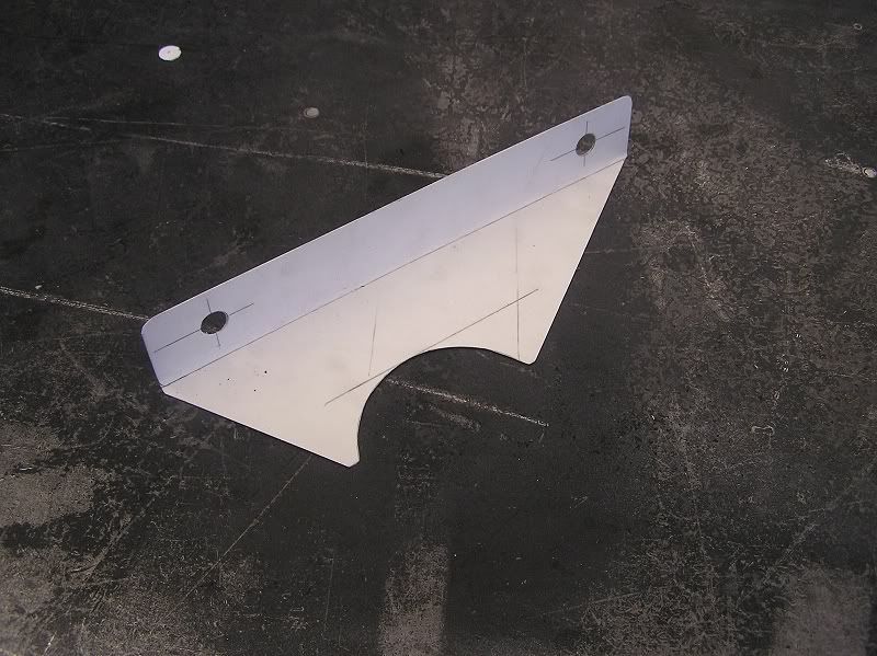

First I made a template.

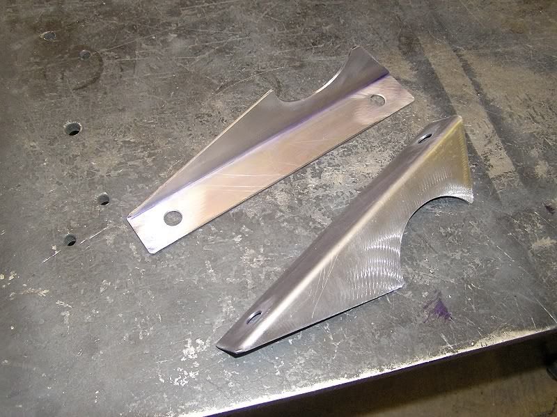

Then cut and bent into brackets.

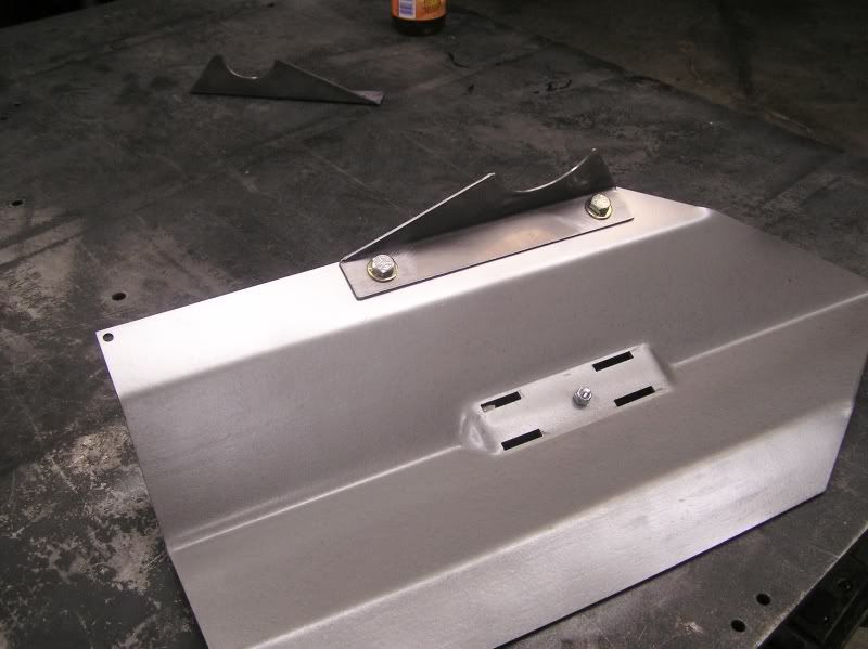

Now Iím going to mark the holes for drilling into the shovel part.
Just making sure the bolts line up.

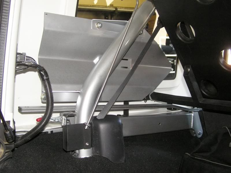

Here it is mounted to the Jeep. The shovel brackets are welded to the sport cage. Sorry, I have no pics of them being welded. I forgot to take pics and donít want to remove the top just to take some. Below the shovel part is more of the Pull-Pal. Again, forgot to take pics.

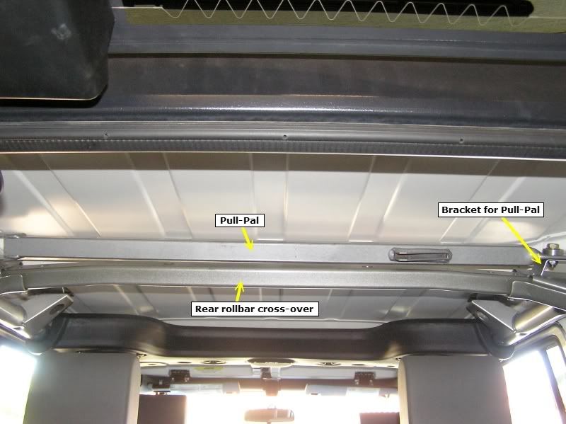

And here is the real long part of the Pull-Pal. I just welded a couple of simple brackets and mounted it up and out of the way.

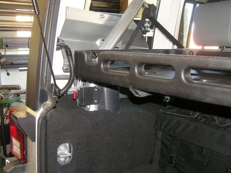

And finally a pic with my rear basket lowered and locked. The side that the Pull-Pal is mounted to is just wasted space. Thatís it. Feels good to be rid of all that hassle of storage problem.
