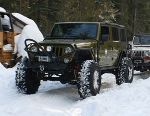

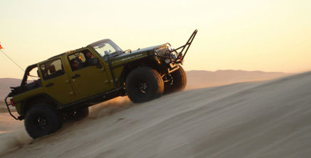

Rock Crawler Project Update...PICS
I got tons of messages to repost my pics. I am reposting all the eye candy you can oogle over. I only ask (as to why I took them down before) that we keep the slamming to a minimum. I've seen the pics copied and posted on other forums only to hate/slam on again, so please, just keep to a co-jeeper respectfully...
Here is the buildup...all done myself...(and no Im not a jeep shop....and not trying to steal your business) a modified 4" (temporary) Skyjacker suspension in the rear and 7" in the front, RE 5.5 ordered for Jan 29th shipment and Rancho RS9000's going in this week, 38.5 x 16 Super Swampers on 15" Rock Crawler wheels. Stinger is 1.75 DOM .134 wall, exo cage is 1.5 HREW .125 wall, spare tire mount is hinged at the bottom and pined up top to swivel down. Exo cage was design for body damage only, not to support the weight of the Jeep. ICOM tranceiver, Uniden CB, and TomTom GPS. Hardtop sold, interior carpet removed, and Warn 9.5ti with PIAA's up front. K&N intake modified from a Jeep Liberty (all that was avail in Nov.) and glasspack/Magnaflow exhaust. My favorites in order; Rocks, Trails, Snow, Water, mud.....then wife, kids, etc., etc...Jeep is NOT daily driver, towed only.
BTW, if you right down the pic number and pm me your email, I'll send you the high res pic (1-4mb) if you need wallpaper or to photochop your tires, wheels, color (must be trimmed to fit your monitor) note: at your own risk, no liability if you knock off a liquor store...
The BUILD
http://www.egeardirect.com/jk/Build%20Up/
Here is the first trip to Pismo.
http://www.egeardirect.com/jk/pismo/
Next trip to Frank Reines
http://www.egeardirect.com/jk/Frank%20Reines/
This was to Hollister
http://www.egeardirect.com/jk/Hollister/
This is Bear Valley. By now I modified the front suspension 3" higher to level out with the weight of the winch up front. This day I was the camera man so there are only a few pics of my rig.
http://www.egeardirect.com/jk/Bear%20Valley/
07 JK Rubi 4DR, Rescue Green, 38.5 Swampers, Exo-Cage, Modified K&N, Glasspack, modified 4" Skyjacker

Thanks for sharing, RockHog.
Not only is the work you've put into your JK impressive, so is the effort you've made to document it. An outstanding job on both accounts.
Every build project has its strengths and weaknesses. Now that you've seemed to have reached completion, what do you think are elements of your JK that are working well? Conversely, what would you do differently if you were to start over from scratch?

very nice. not a fan of the stock jk. but now i've finally seen one modded fairly well, it looks like i could get used to them.
nice job.

Best JK i've ever seen. It appears to actually get wheeled too. That's one large B Bar on the front. looks great Nice tow rig too
