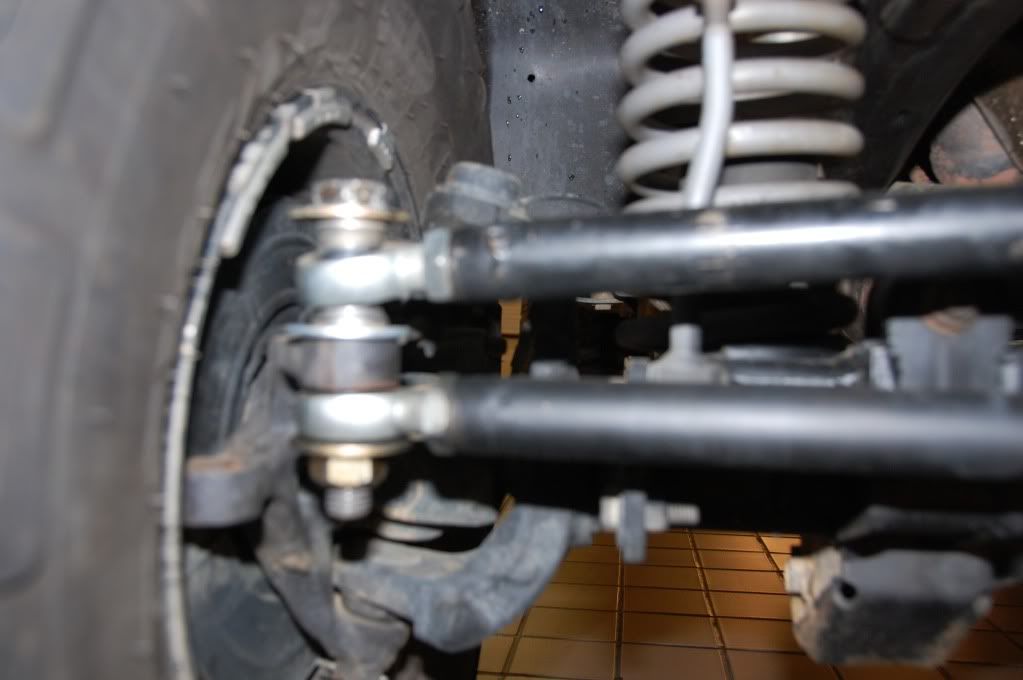

hey guys, i'm just curious what you are doing in regards to the drag link when using the poly performance track bar brace/relocator. i installed a skyjacker drop pitman but the angle is still a little off and as a result there is minor bump steer that i am not OK with...it looks like the pitman still needs to come down about another 3/4". i know some people have done the drag link flip kit. did that get the drag link and track bar parellel or is it about the same as the drop pitman i'm using?

I have a Poly flip draglink and 3" weld on trackbar bracket on my Prorock 44, it also has Reid highsteer knuckes. No bumpsteer, and I havn't put the Fox steering stabilizer on and probably won't. It drives nice. 37" old school MTR's for tires.

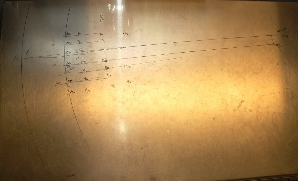

Just some information on steering angles and bump steer. When you get down to the nitty gritty on it, it is not that you need the drag link and track bar parallel, you want the arcs of the two parallel in the "ride zone"... Taken from Welcome to the Genuine Bullet Proof Steering System Solution!

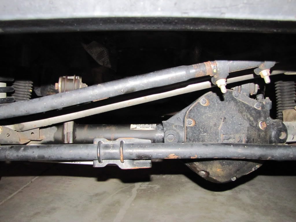

here's a crappy cell phone pic i took the other day. that stabilizer is getting removed for hydro

ok I see why you are having bump steer, that steering stabilizer relocation bracket is supposed to go with the PP flip kit to compensate for how much higher it mounts the trackbar. Do you see how much it raises the track bar compared to where mine is in the pic? I know a pitman arm is needed after 4+", Im just saying its never the correct way to handle the situation...With hydro assist you wont have a problem....Wich one are you getting? I have been looking at the econo version but havent heard much about it...
Im willing to bet without that relocation bracket there would be no need for a pitman arm or the flip kit. Sense you already have it I would just get the flip kit that is recommended to go with it anyways...I was looking at the same one and researched it a little and found out it needed the flip kit as well so I didnt end up buying it.
Here is a link to the flip kit, http://www.polyperformance.com/shop/...t-p-16410.html Notice it says
Requires use of our Jeep JK Front Track Bar Bracket wich it looks like you already have...

take some measurements of the mounting bolts to the ground, then draw it out like below. This will allow you to draw the arcs of your bars. Once you measure the distance between the arcs you will know why you have bumpsteer. If the distance is not the same for about 4 inches above and below your ride height you can adjust, redraw and remeasure on paper. This will help determine where you need to make adjustments on your rig.
I have heims on each end of my links so it was easy to add spacers. With ball joints this will be a little more difficult, but at least you will know where you need to go. With my setup I have 1.5 inches between the bars at the frame end and 1.75 inches at the axle end and have absolutely no bump steer. I had them exactly even and had just enough to make me know something was not perfect. Hopefully this will save you some time.

yea, i already took my measurements. the drag link needs to either come down or go up (depending on teh end) like an inch or so. great write up btw unfortunetly with the current setup there is no way to make adjustment

hey, do you have any more pics of your front end setup up in regards to the drag link and tie rod? just curious what you have going on there
