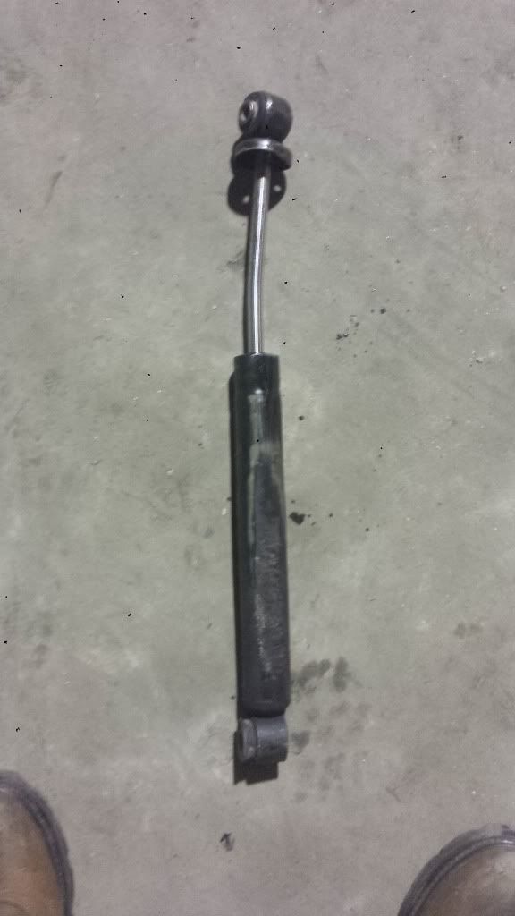

Took off my steering stabilizer finally, or what was left of it.
Also I thought my death wobble was over until my trip to long island Saturday. Seems my rock krawler bushing was bad, luckily ruff stuff 7/8 heim threads right in, grinded down the misalignments a little so it would fit, and checked to make sure as the heims swing wouldn't make it hit anything, and all good. Can finally say the Jeep feels like it did before the accident!
