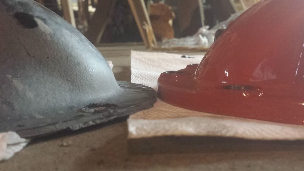

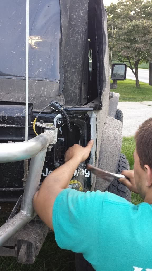

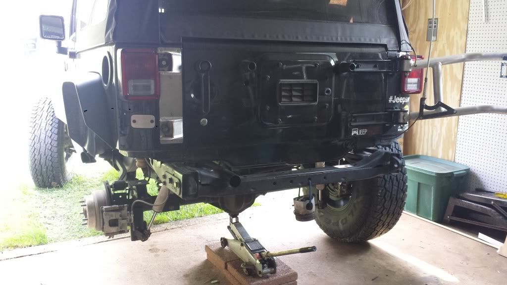

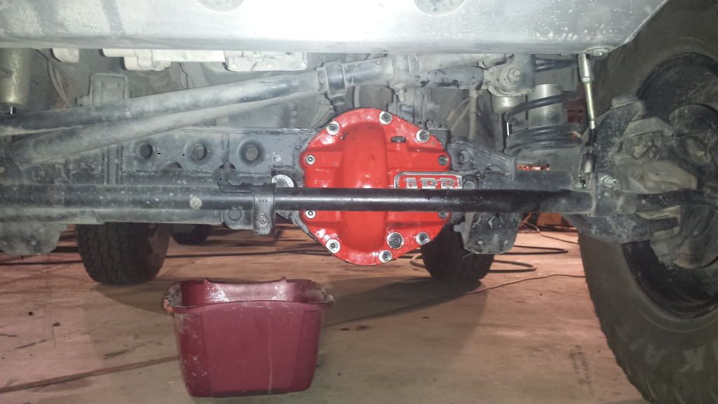

Madr it out ti the pine barrens as I said last weekend, got my diff cover fron arb on, man this thing is thick lol. Got a little damage in my right rear, and my bear bear bearing but everything is fixed now for the most part. Edit: forgot the pics got the tires rotated today also

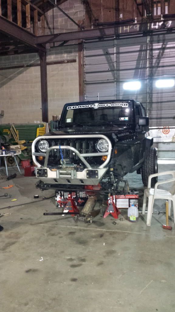

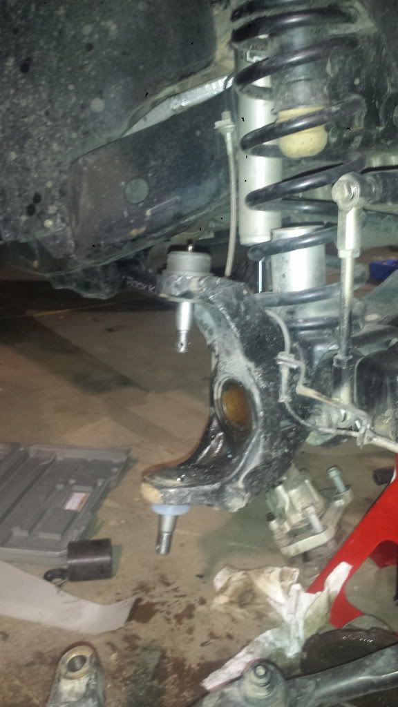

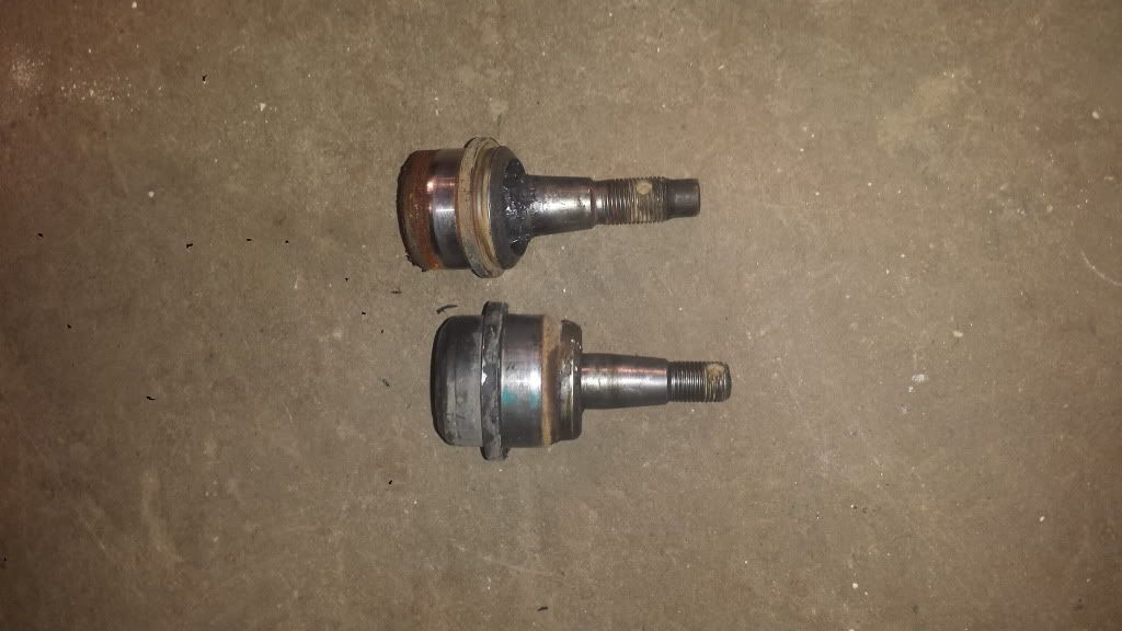

Got the synergy ball joints in this week. Got the installed yesterday. I was getting a tiny wobble and I could tell it was them. No big deal and the price wasnt too bad.
Used the harbor freight kit and it worked well, biggest thing for me was to get a good amount of pressure on them, thrn wack the c with a large hammer, I used a 4lb laying around anything over 1lb should work well. Same technique for removal and install. Stock ones had some play when removed. And wobbles gone

post #172 of 372 Old 09-15-2013, 05:01 AM

Originally Posted by spyder6 View Post
How long did it take you to do?
Once dissasembled probly 10 minutes per ball joint
I think the most aggrevating part was getting the wss bolt out. Haha
Edit; from start to finish 3hrs. But with all hand tools

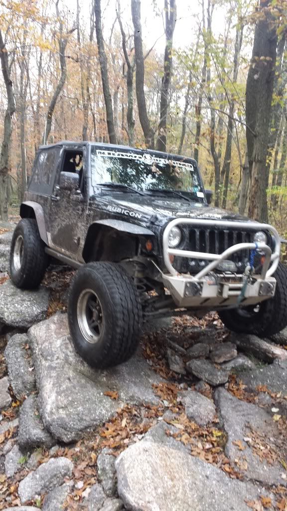

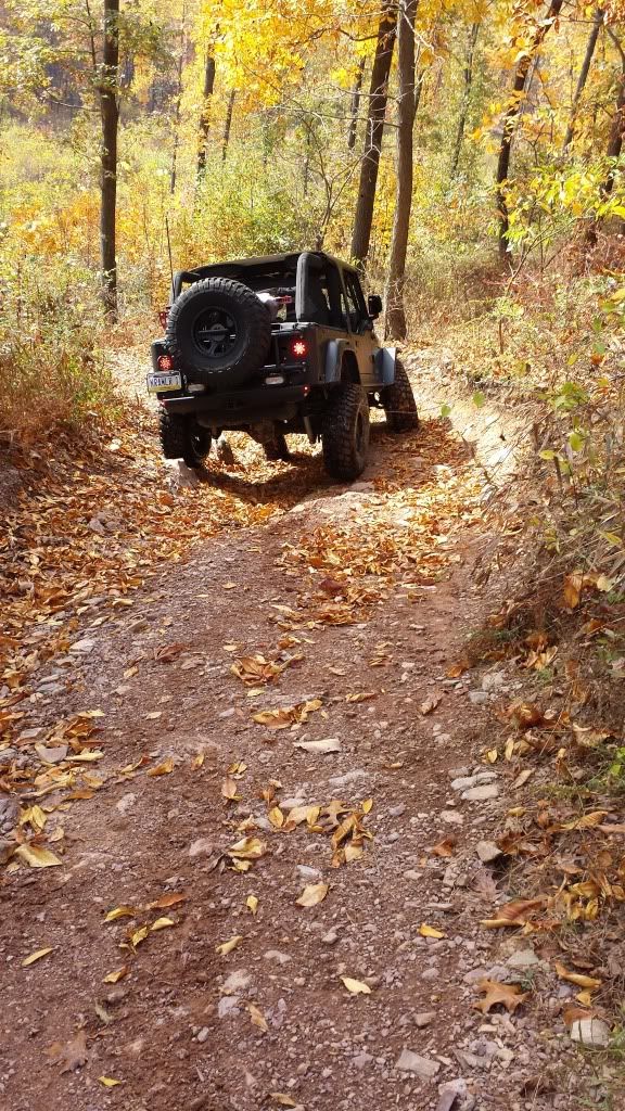

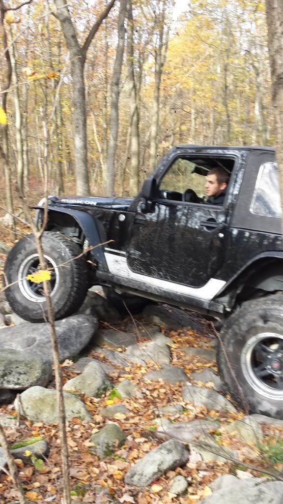

Got a trip out to rausch this weekend with seven slot society

Damn, that looks like a blast.

sure was, and will be again this weekend
