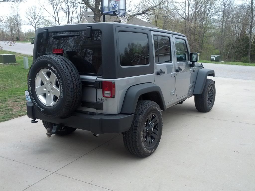

I already replaced four of my wheels but my spare is still factory so I think I am going to plastidip it so it doesn't stick out like a sore thumb.

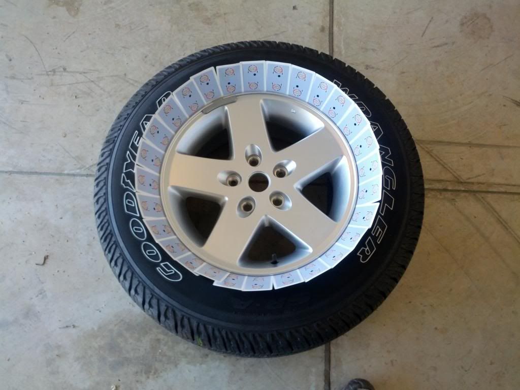

x2 on the rustoleum paint. i used playing cards inbetween the rim and the tire, and used the method of clean, sand, clean....then apply a few coats. Yes.....you can't peel it off like PlastiDip, but you can just paint over it. Any nicks can be touched up pretty easily.
The only warning is when you go to balance your tires, tell the shop to do an "inner" balance. This will place the silver wheel weights on the inside of the rim (invisible) instead of the outside (stick out like sore thumbs). I chose to stick with factory lugs instead of aftermarket black lugs for a bit of contrast....but may change.

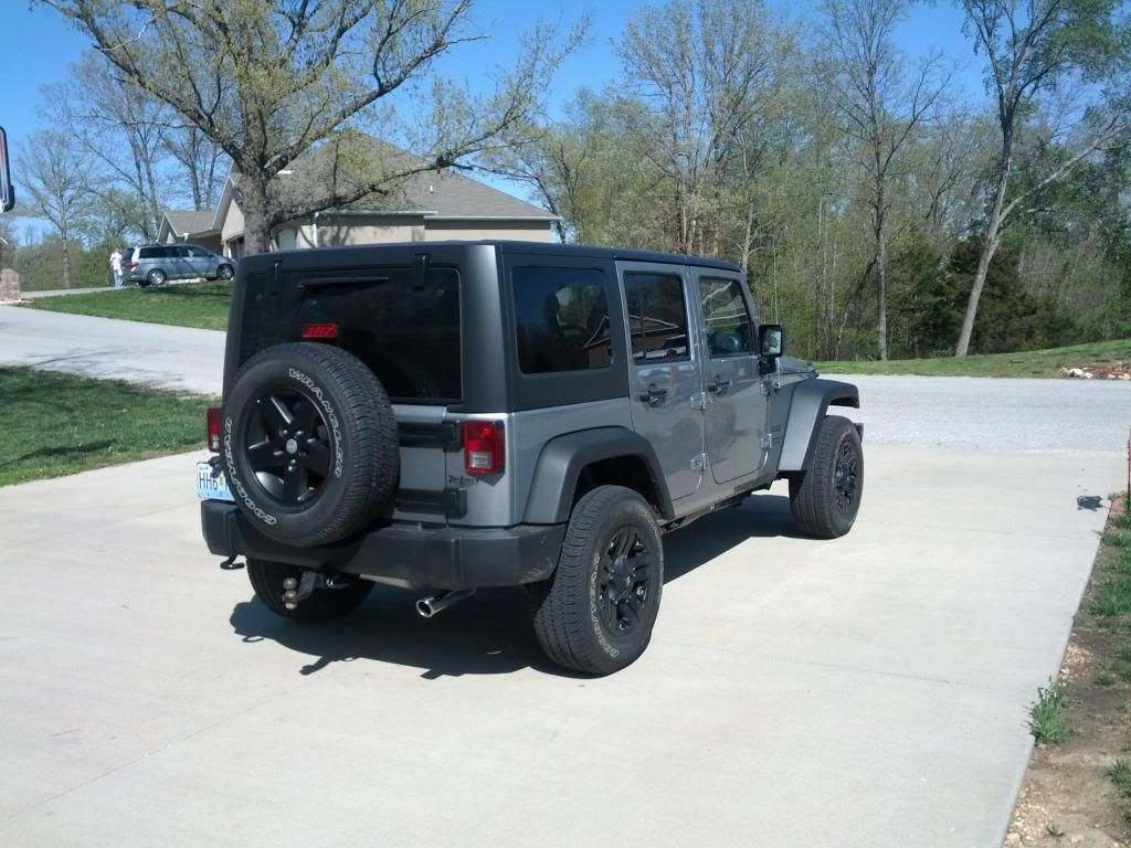

I plastidipped my spare today, it was easy and turned out pretty good for a 15 minute project.

Looks good dude
