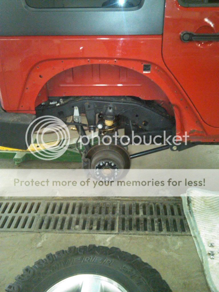

So I got the new springs installed, teraflex 3" springs, as well as the adjustable rear track bar.
I did not use the retaining cup (or whatever its called) in the rear, that mounts above the coil. This kept the front and rear level. I'll hold onto these in case I need them after I eventually install a heavier rear bumper VV
Also because I couldn't get them off of the Teraflex budget boost spacer
So the spring hits the upper perch like this
I would guess (I was too absentminded to measure) that I netted an extra 1-1.5"
I think as she sits, she could fit 37s without issue, other than needing a regear.
I did not adjust the front LCAs, hoping that the difference would be negligible. I'll put a few miles on her tonight to help determine whether I will need to do so. Getting the extended bump stops back in was a PITA by the way...I ended up soaking them with wd40 and wedging a piece of 2x4 between the coils and under the bump stop, then jacking the axle up until it forced them in...hopefully this little tidbit helps someone out down the way

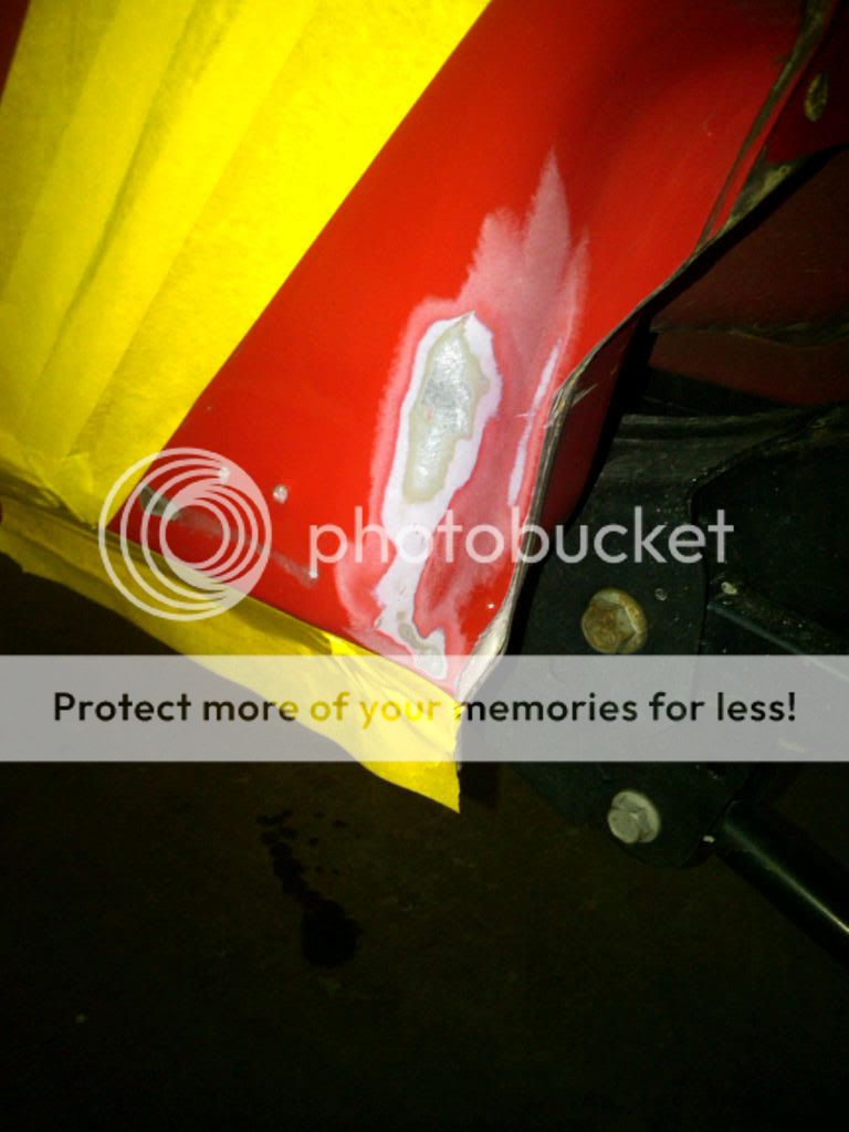

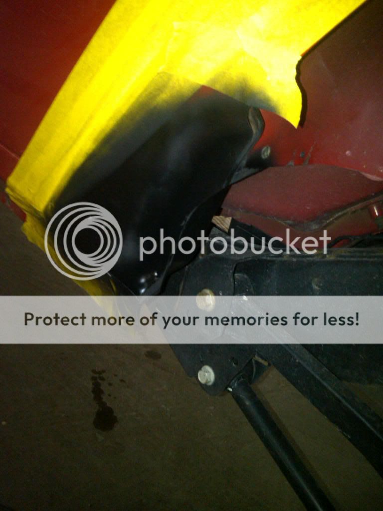

Got it back in the body shop today...I was too squeamish to make the cuts alone
Removed the rails and drew out the cut
Filled the cut with body compound and sanded down
Hit it with a couple layers of engine paint
I'll be dropping it off at LINE-X tomorrow tomorrow to have the entire surface where the flares mate and the inside of the wheel wells sprayed, as well as the front grille. We're holding off until after LINE X does their job to cut and remount the rock rails.
