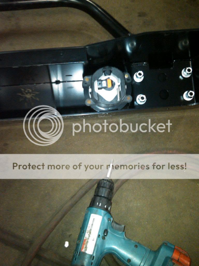

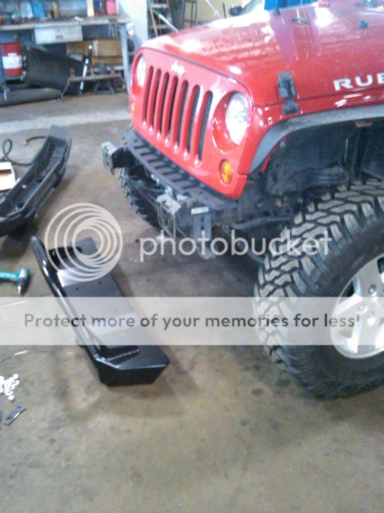

My bumper came in today! It took me about an hour and fifteen minutes to install it, one man job. The toughest part was removing the 18mm nuts from the inside of the frame rails...ended up using a big 3/8 drive ratchet with a kinked head (not sure what its actually called, it has a joint right below the drive). It was pretty easy after that
I wasn't sure whether I was suppose to use only the included hardware (washers, 19mm nylock nuts), or use those as well as the steel plates from the factory bumper...I used the steel plates as well.
Getting the dust cover off proved to be a PITA as well...I ended up drilling out the plastic plugs/screws with a 1/8" bit, made quick work of it

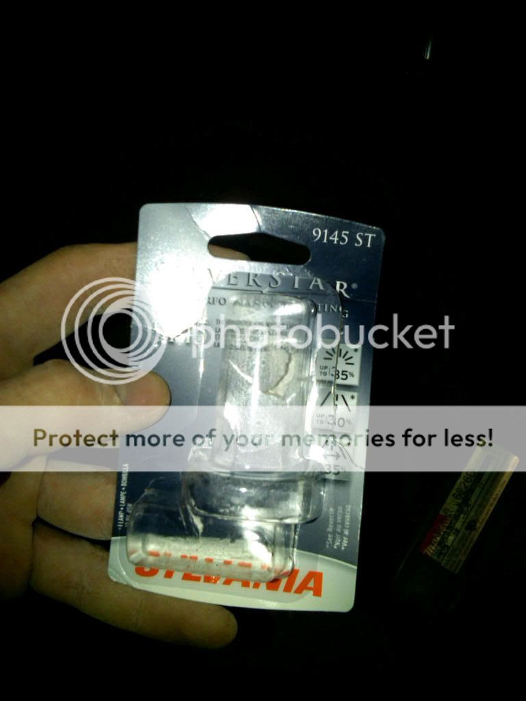

Replaced the factory fogs with sylvania silverstar 9145 ST bulbs
The factory fog housing transferred over very easily...the PSC bumper has pre-drilled holes for the stock housing

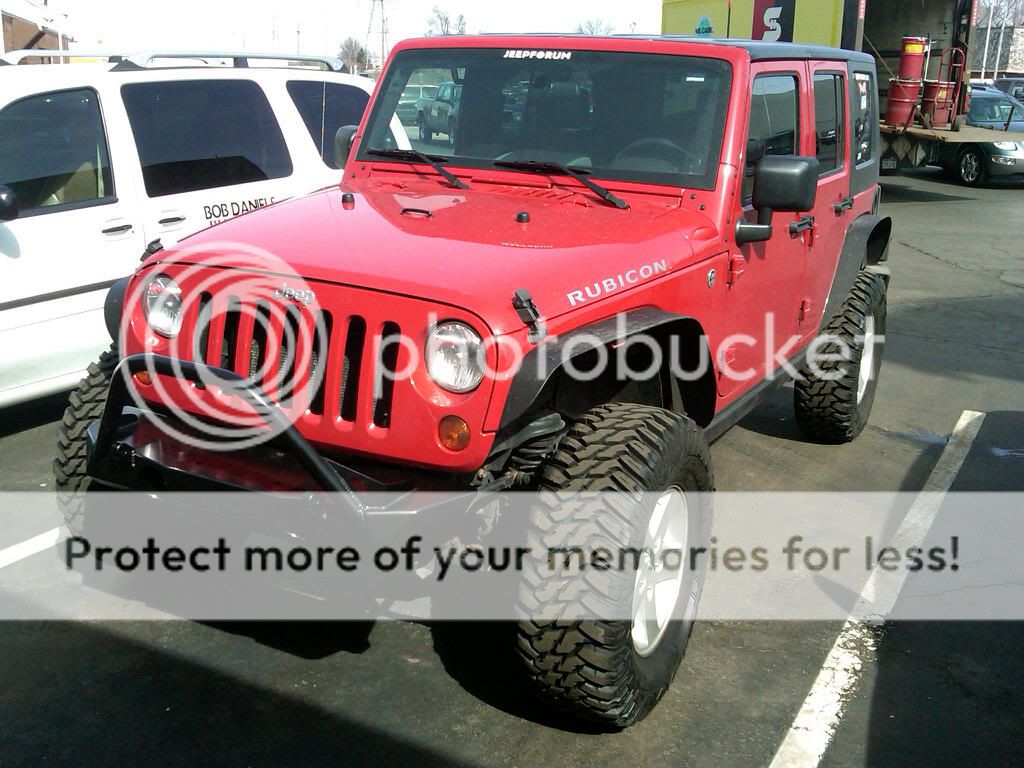

Aaaaand, the finished product!
