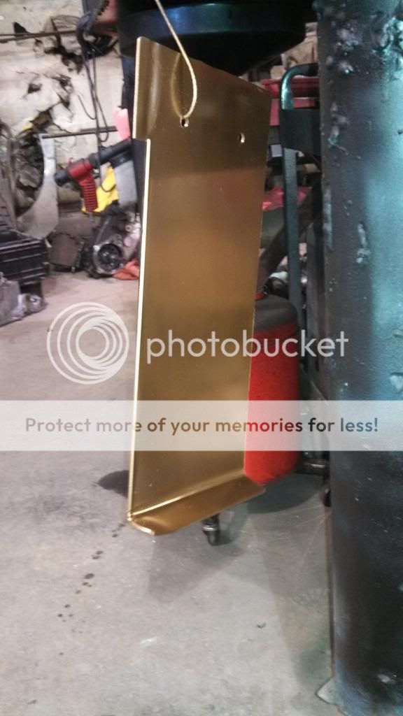

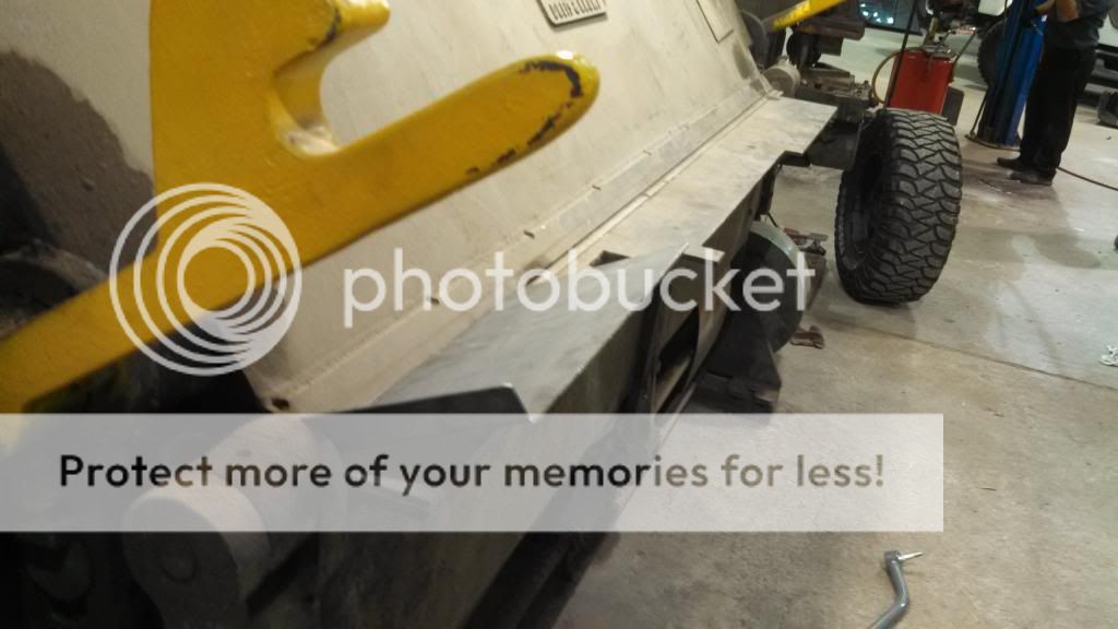

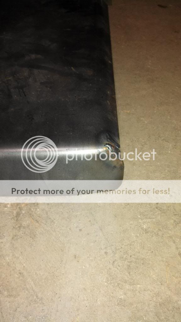

Made a temporary skid for the transfer case...don't have the time nor the money to throw at a flat aluminum skid before this weekend's trip to Slade
started with some scrap steel plate, the jig saw, and the brake. Measured, marked, and drilled...found some metric bolts that thread into the holes for the factory skid plate. Made it super easy
Hell yeah, I painted it gold metallic. That's what all the cool kids do

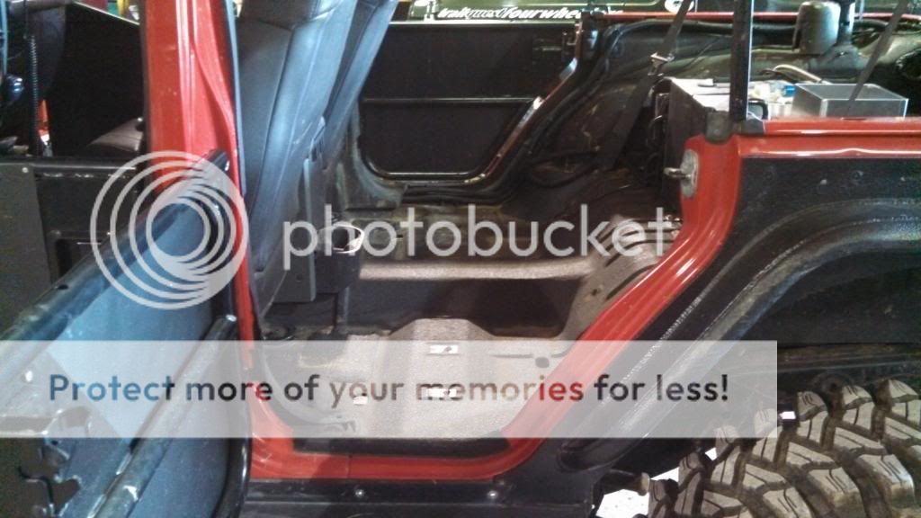

Removed the rear seat to shed a few pounds and make room for the spare tire, also removed the fuel cell cover to save a little weight

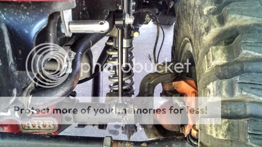

And installed the stock sway bar and teraflex quick disco...need to get it on the ramp to see whether it will be in the way of the tires while disconnected
