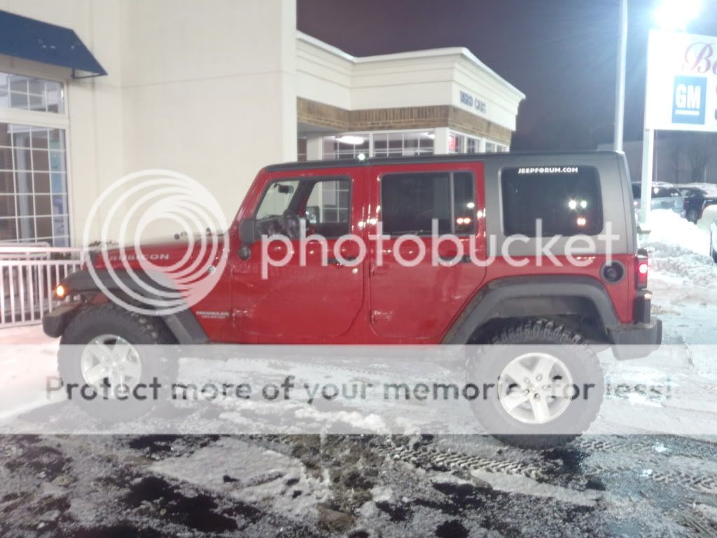

Here is what she looked like with about 39K miles on her and bone stock
Winter rolled around and the tires that my dad probably NEVER rotated couldn't let the Jeep get out of its own way... After my months of reading, I had a pretty good idea of what I would need to get started.
Picked up a set of Cooper Discoverer STT TEK3s, 35x12.50x17 and ordered a set of wheel spacers as well as the Teraflex 2.5" BB and Teraflex shocks
Well the lift made it here before the spacers, and I had the day off and am extremely impatient, so I called Stefan at trailquest (trailquestDOTcom) and he just so happened to have a set of four rugged ridge wheel spacers on hand, slightly used. Not my first choice (spacers or rugged ridge) but they will do until I pick up a set of wheels. I ran to plain city and grabbed those and got everything put together. I thnk it ended up taking me somewhere in the neighborhood of 6-7 hours to get it all installed by myself with the occasional helping hand from a few of my dealerships techs (when I could talk them away from the jobs they were working on). Nice having them around to offer tips and tricks...slowly learning a great deal.

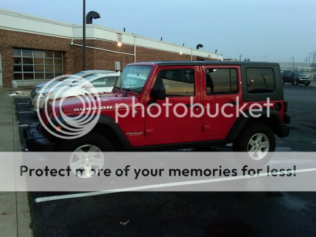

Here is how she set after the install of the tires (which actually weren't too hard to balance, but I suck at getting the weights to stay on the rim haha)
Glad the lift made it before the wheel spacers, because I know I would have tried to cram the 35's under there without the lift... Pretty darn close on the rock rails:
I am going to trim those back about 1.25" and trim/paint the pinch seam in the next couple of days.

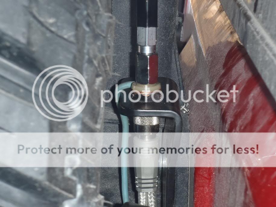

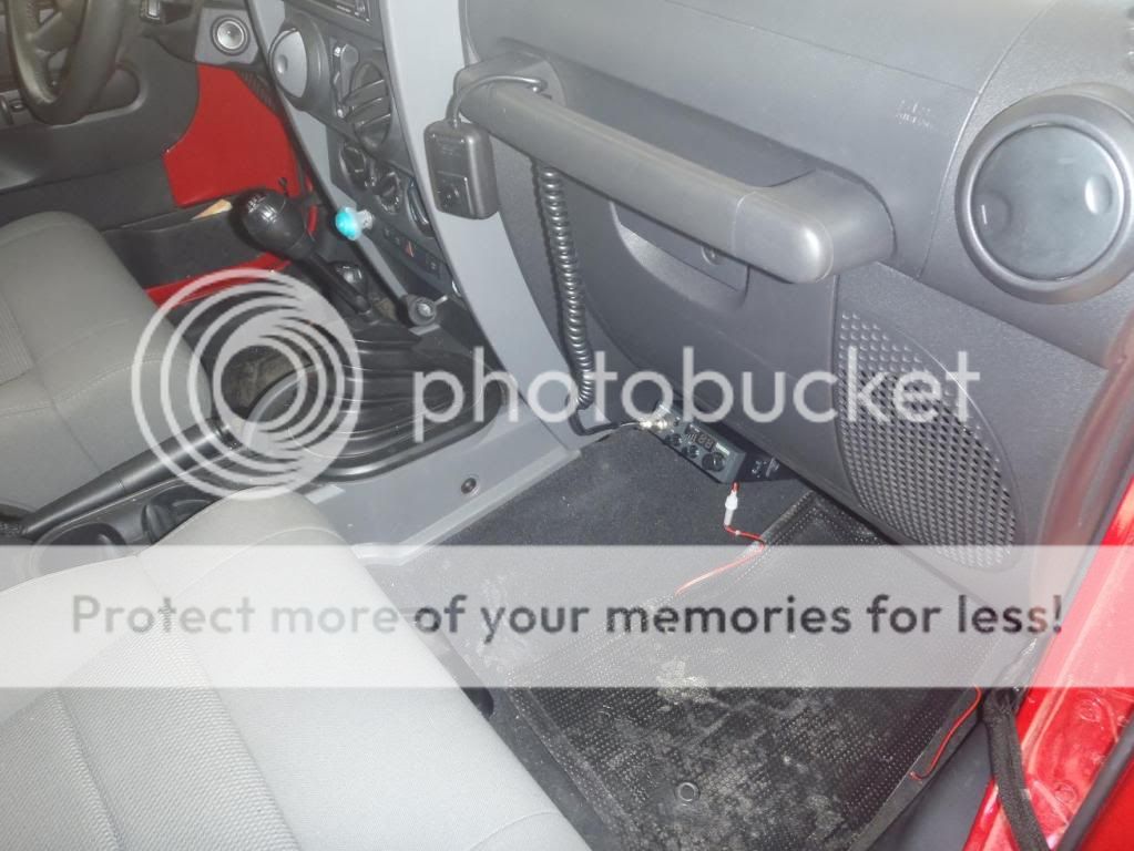

Installed a CB antenna (firestik 3') on the teraflex mount with the uniden pro radio
Thought something looked funky here, but with the help of Rockyclymer (I think) I got it figured out haha
wrong
right
Need to get the mount hole I drilled with a step bit painted
I still havent connected the power, couldn't decide how I wanted to do it, but I think I will splice into the switched 12v on the left, per b_c's thread, but this is where I mounted the radio
not sure whether I will keep it here or not...still trying to figure that out.
