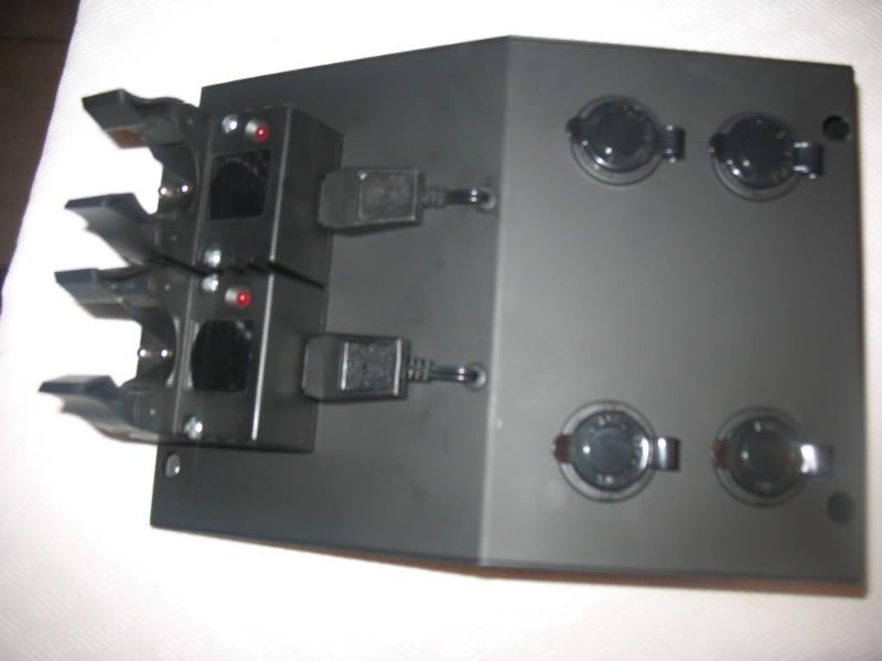

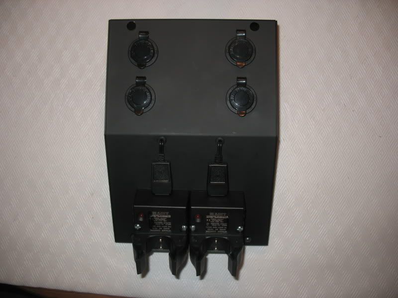

If anyones interested, here are some pics and specs of the box.
Silver modular desktop box from Fry's.
4 blue sea systems 1011 12v sockets
2 stream light chargers
1 can of black spray paint.

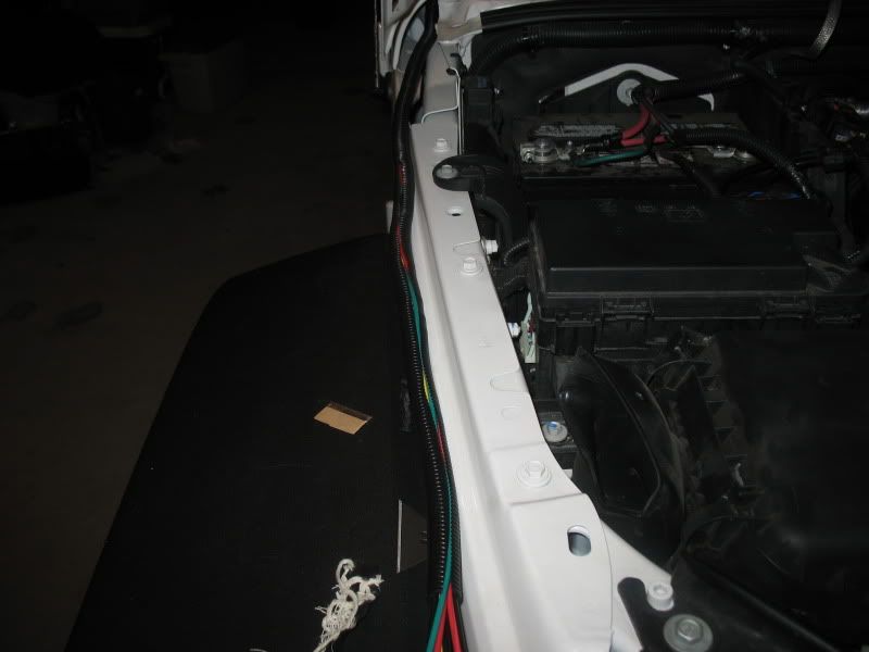

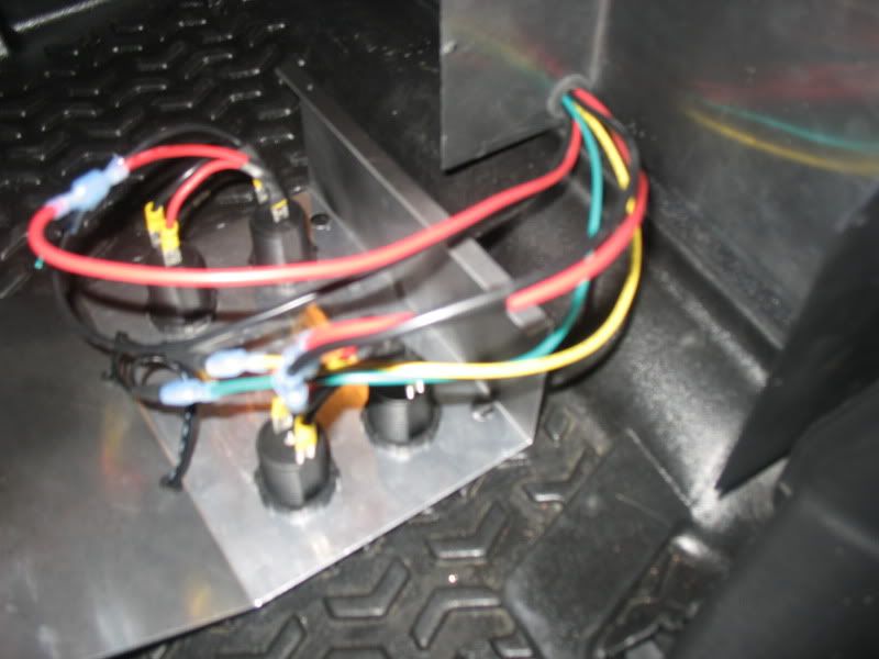

mid install. This is taking forever! im in about 12hours and nothing is mounted. However I also built the power panal today so that was time consuming.
Also ran 12 gauge wire instead to the 12v plugs. 14 gauge to the chargers.
Pics to follow when im done. Ive taken a few photographs.

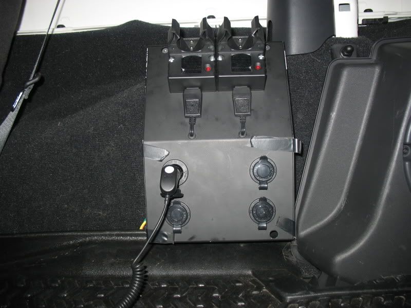

Alright. So I have the temporary install done. I need to come up with a better mounting system and different screws to hold the box together.
the tape is holding the bottem half of the box together. The screws that came with the box would only work one way. So I will get fresh screws to fix that.
Also need to hide the wires better.

The only problem I see with it mounted in that location is if you load up the back like I do sometimes with coolers, camp chairs and other related stuff. Then perhaps you wouldn’t able to use the outlets without the gear pushing on the plugs that would be sticking straight out if in use. Any way you could mount it up higher off the floor?
