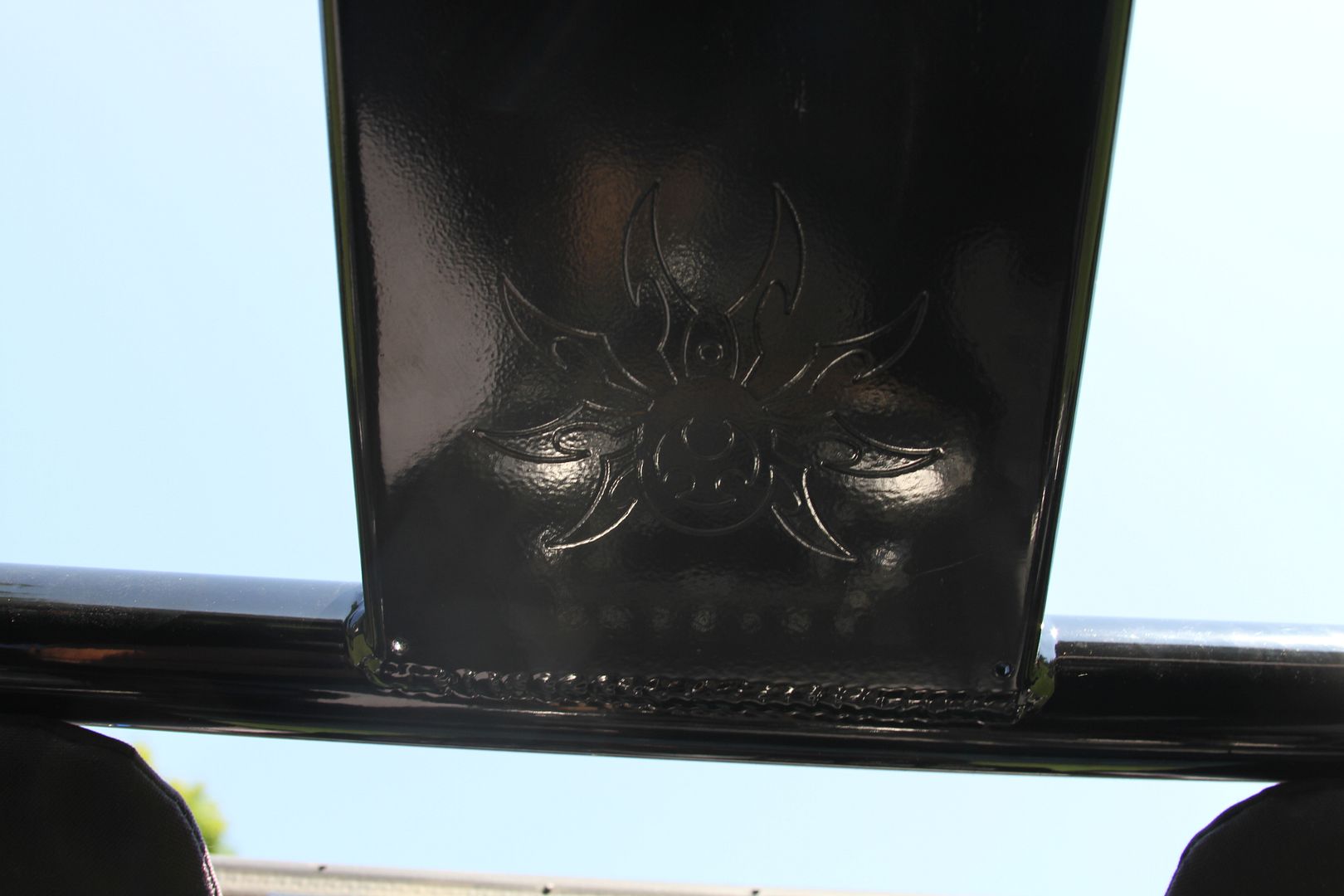

Got the Trail Cage back nice and shiny. The install was pretty uneventful as all the fit up and prep drilling was done before it was powder coated. I like how it gives it a more old school look.
Because of the open channel design, I drilled four 3/16" weep holes in each corner for water drainage. These were drilled prior to powder coating. Future plans may include designing a cover plate for it.
Dang, and I knew that. I try to be so careful to include the details (at least the ones I know) but forgot to add that little tip! Good to see you log in to the thread every so often for a fact check and to keep me honest!
