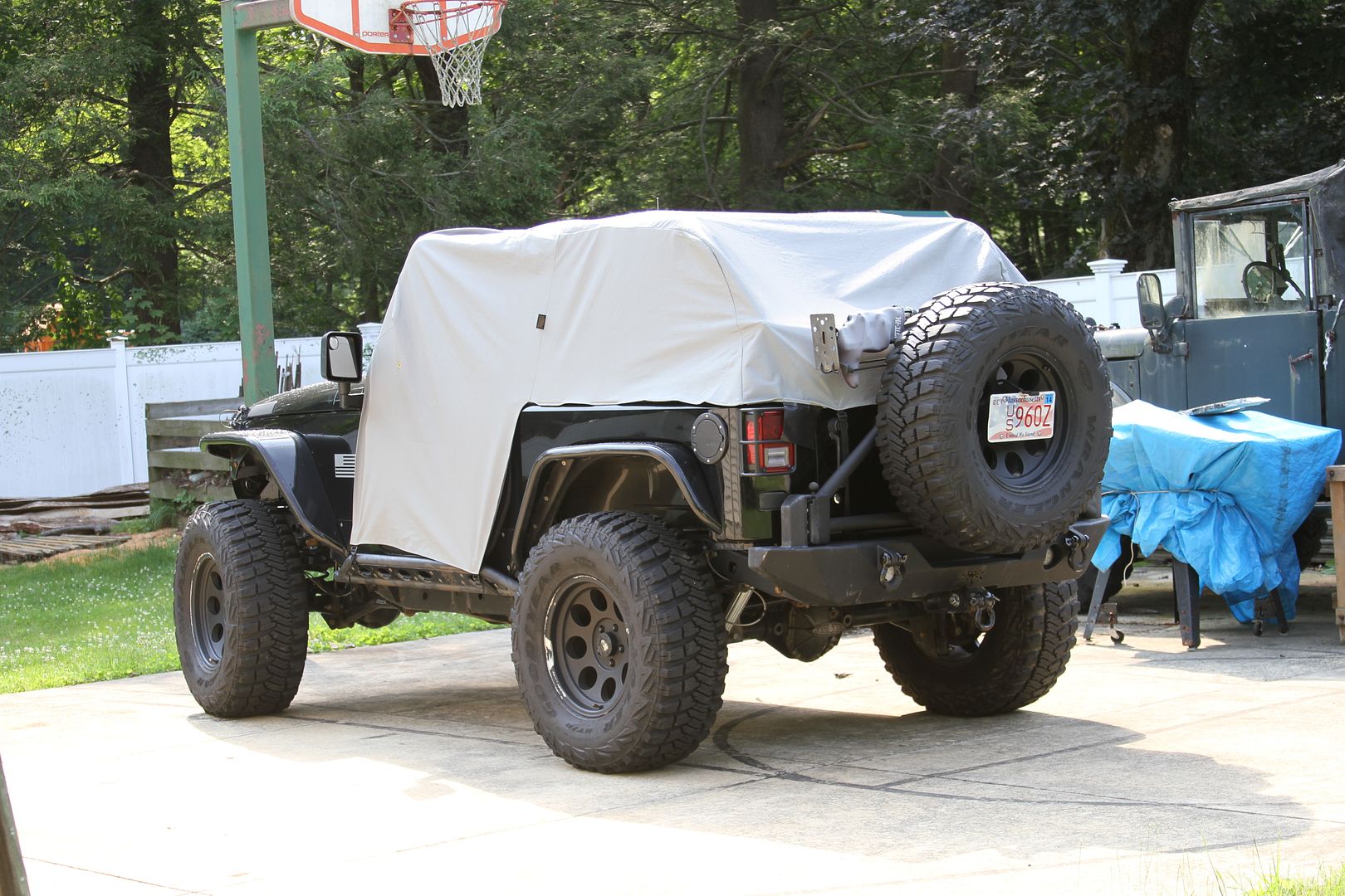

It is the Bestop All Weather Trail Cover. We leave the top off all summer and I can throw it on if I know a rain storm is coming. Easy and completely waterproof .... one of the best investments.
