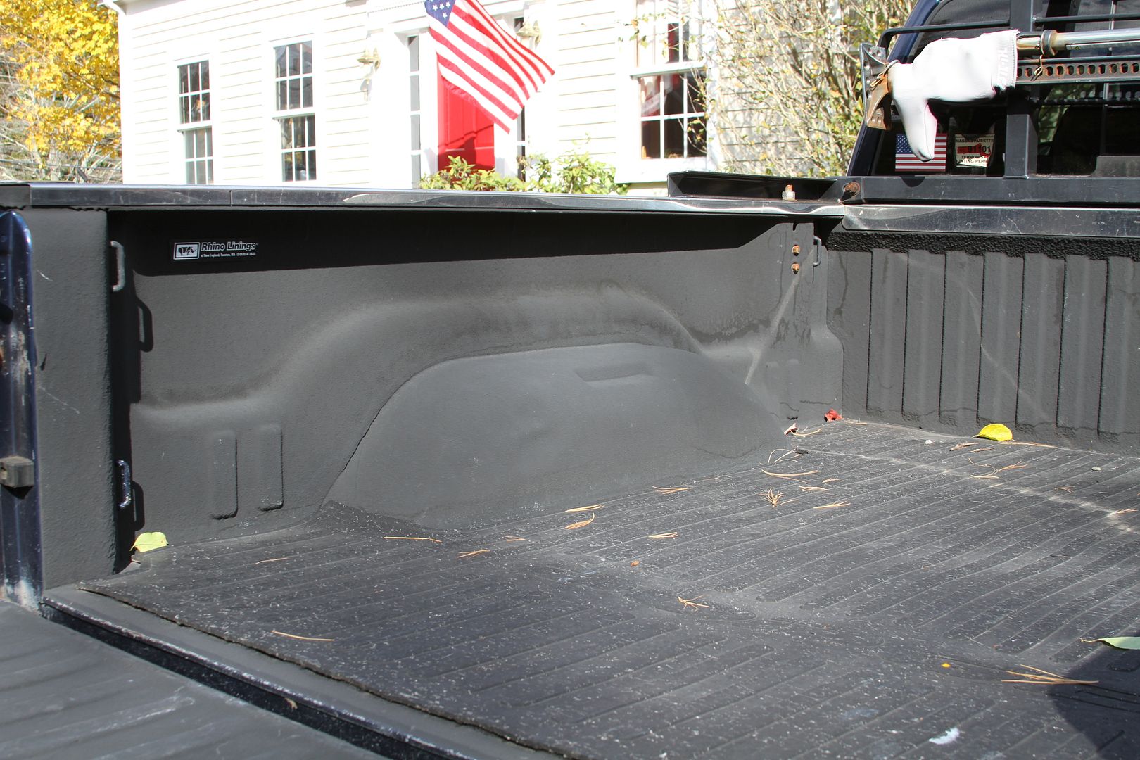

I researched a lot on this forum and all across the Jeep community about the DIY bed liners and just couldn’t convince myself (or TOGM) that we could come close to the professional job of Rhino Lining. To preempt the criticism for not DIY, let me just say he had the bed of his Dodge Ram done in 2002, it has been worked hard, sits in the weather 365 days a year and it still looks and performs great. This sold us on the Rhino Lining.

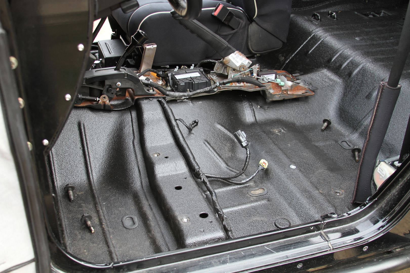

Prepping for Rhino Lining

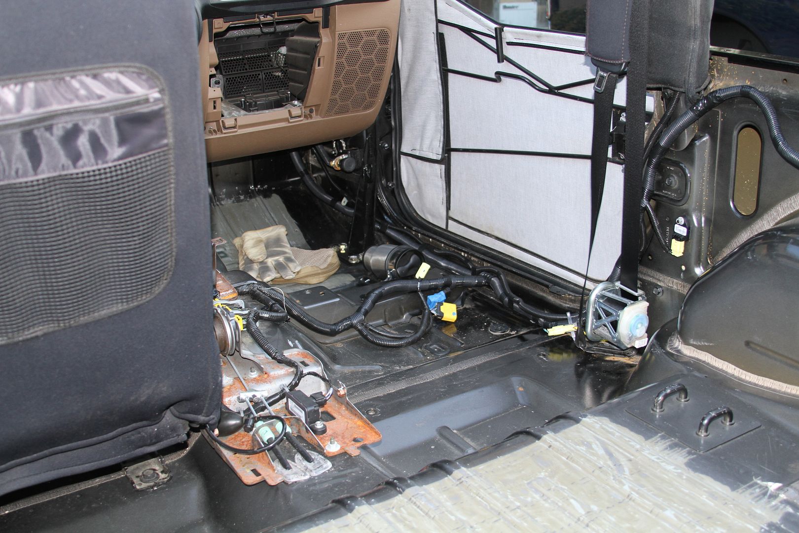

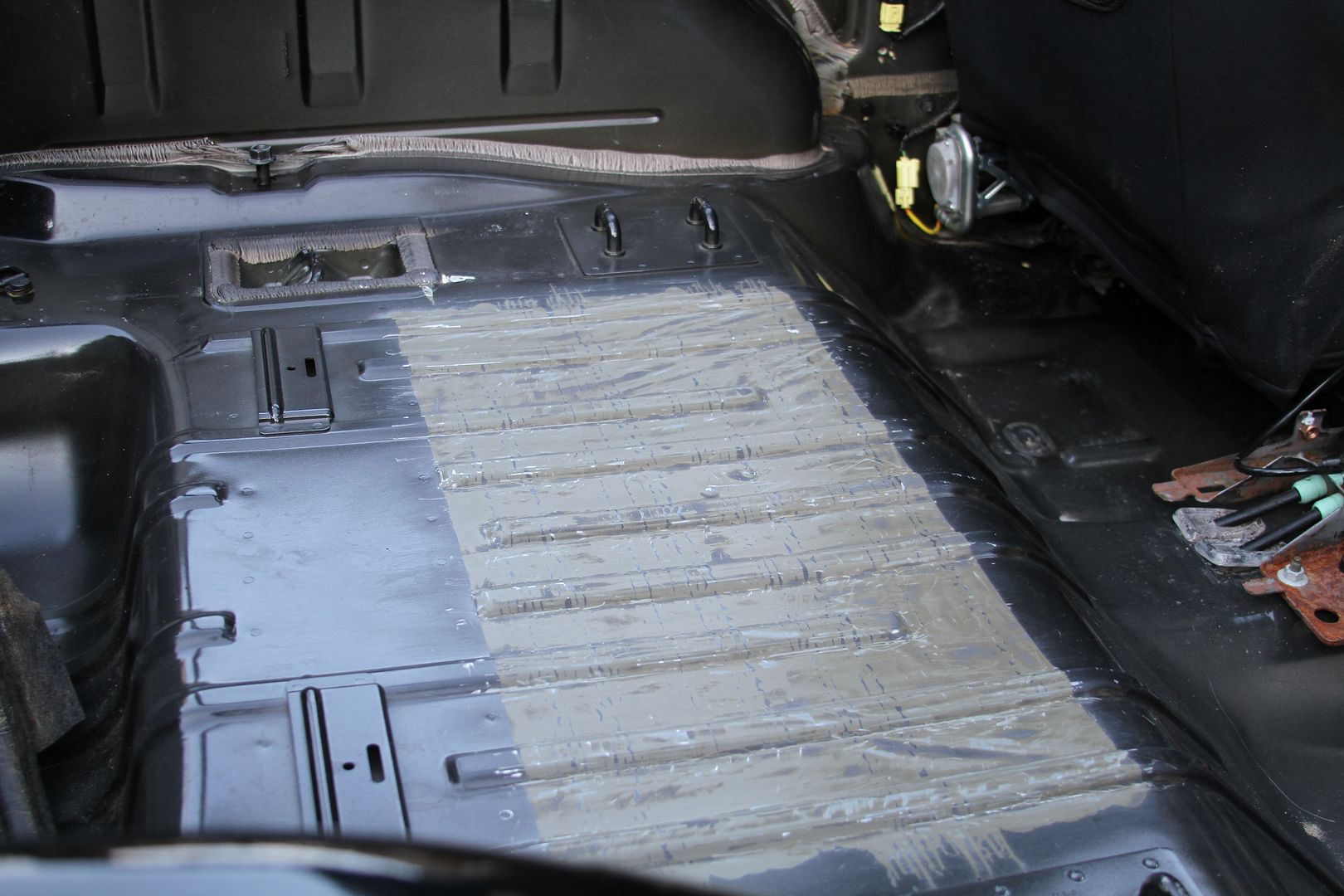

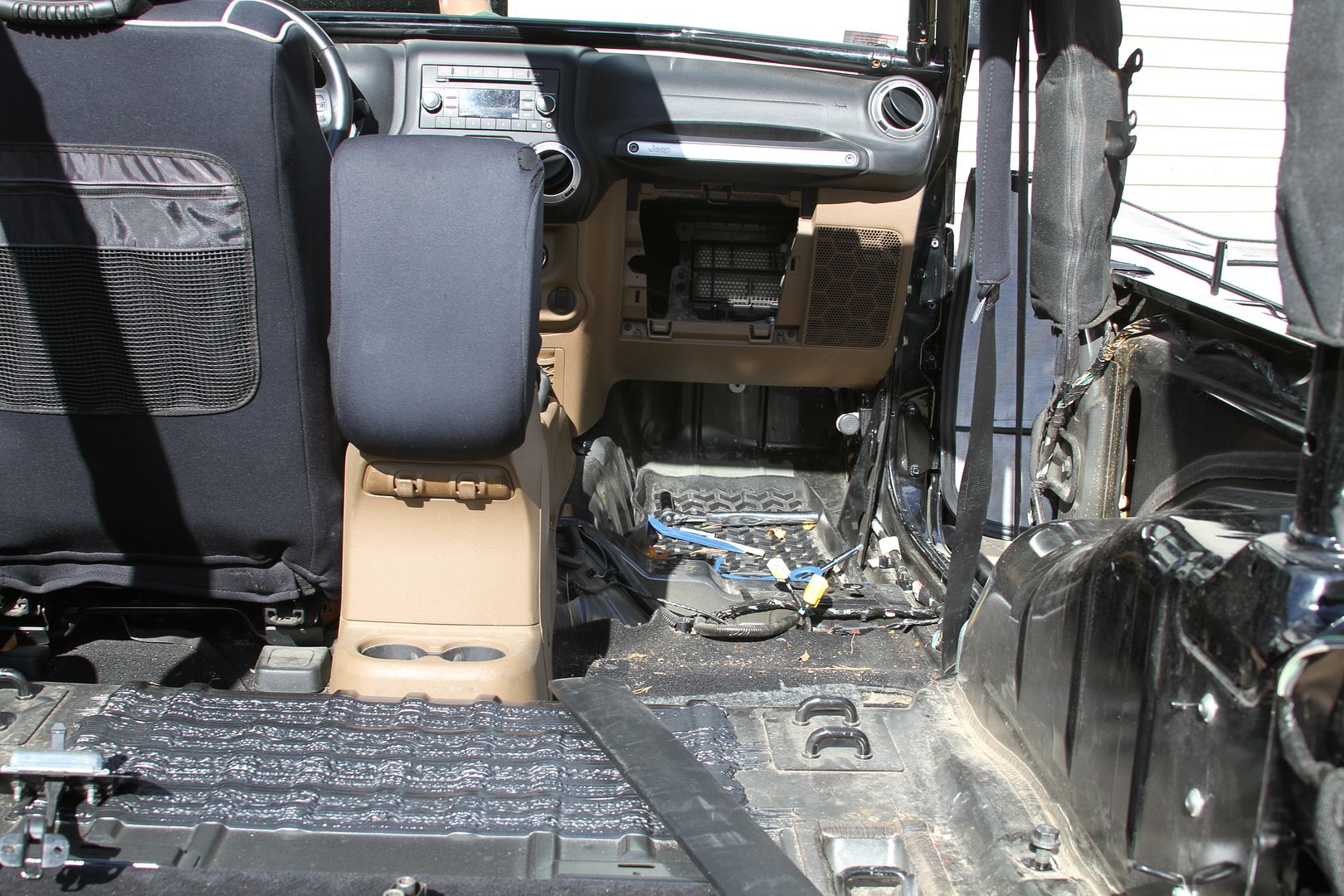

To keep the cost down, we stripped everything out of the Jeep except the drivers seat to prepare for the tub lining.

Posts: 590

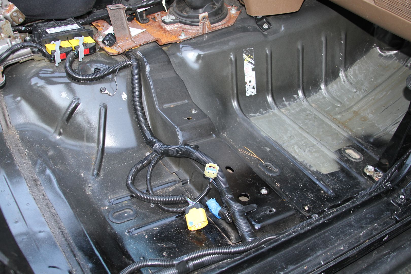

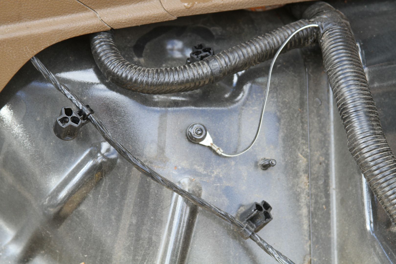

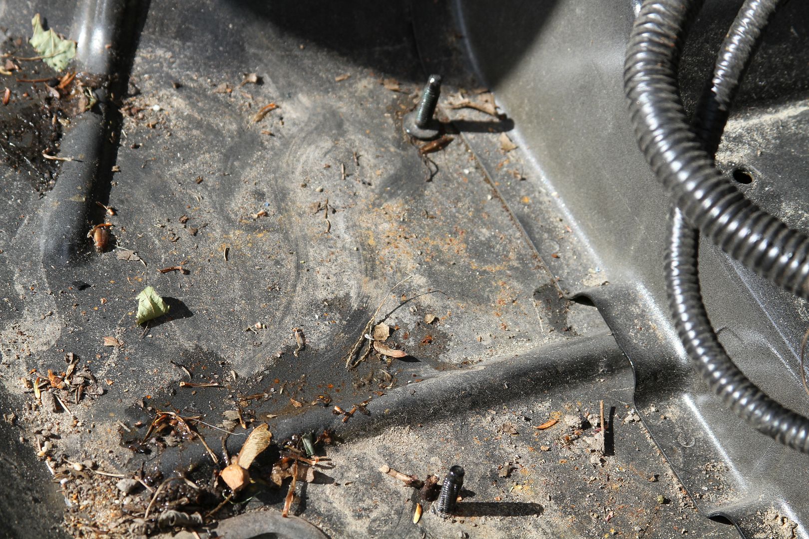

There are a million of these little plastic clips and studs across the tub. To neaten things up we ground off the stubs, removed the clips and enclosed most of the wiring in loom tubing.

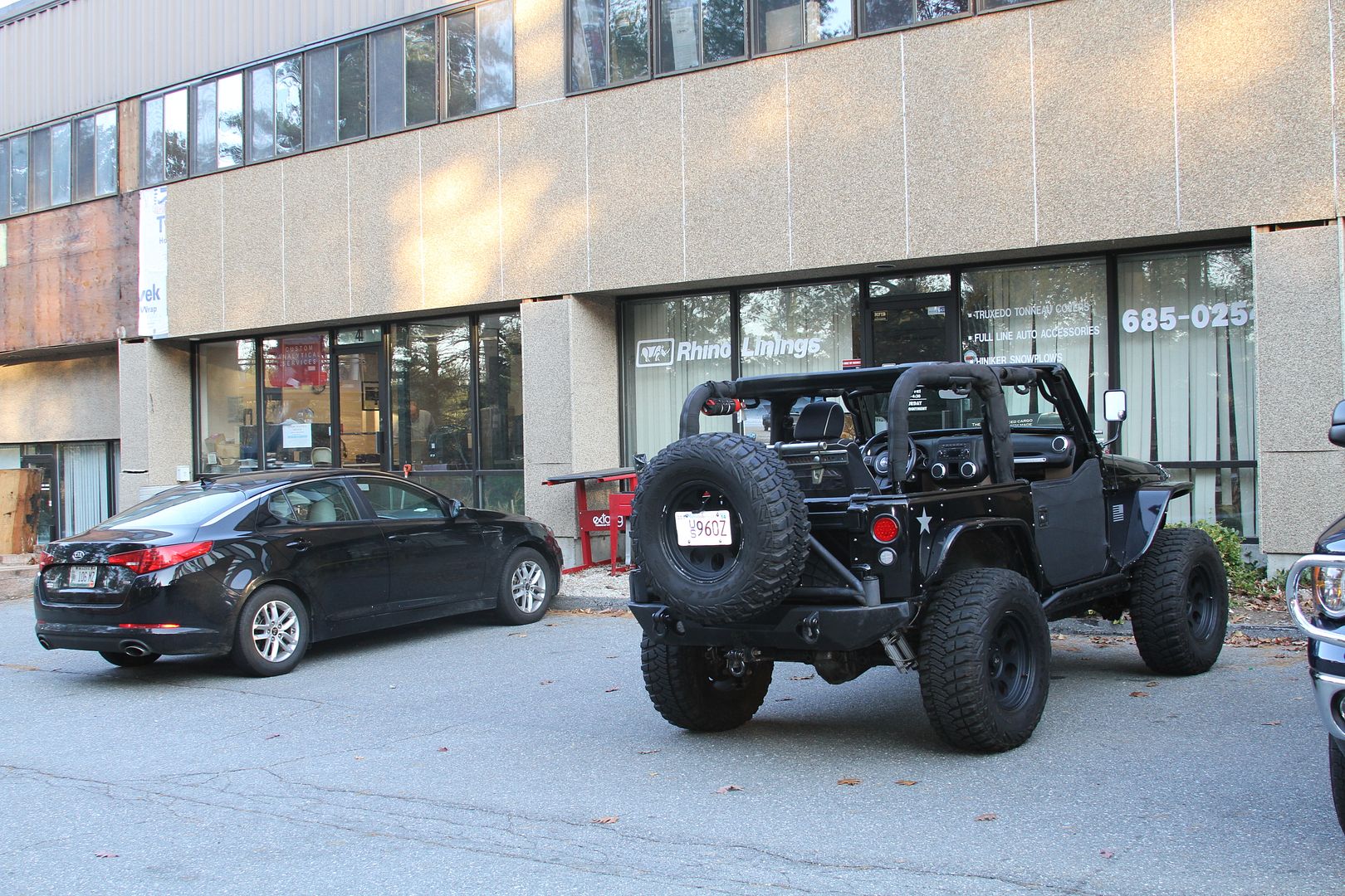

Had to drive it to New Hampshire (2 hours) with no top in pretty nippy weather to drop off for the Rhino Lining. This is one time I didn’t argue about who should drive.

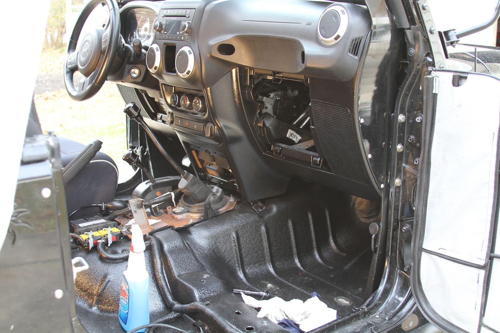

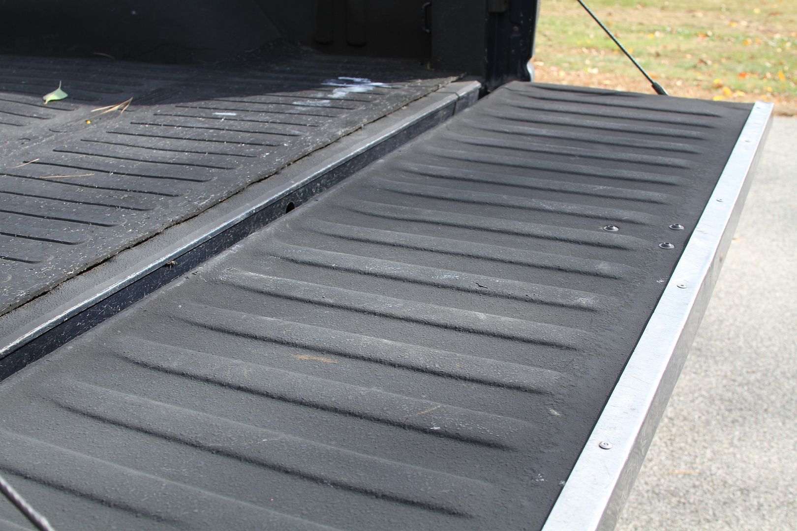

No complaints about the job … it looks almost perfect! I realized that I don't have many pictures of just the tub.

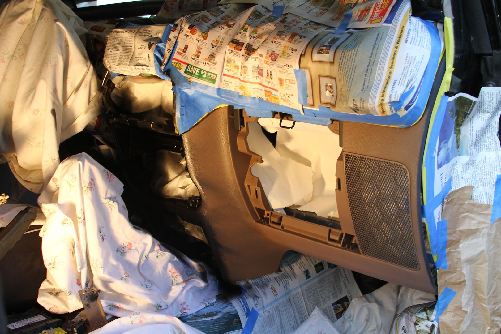

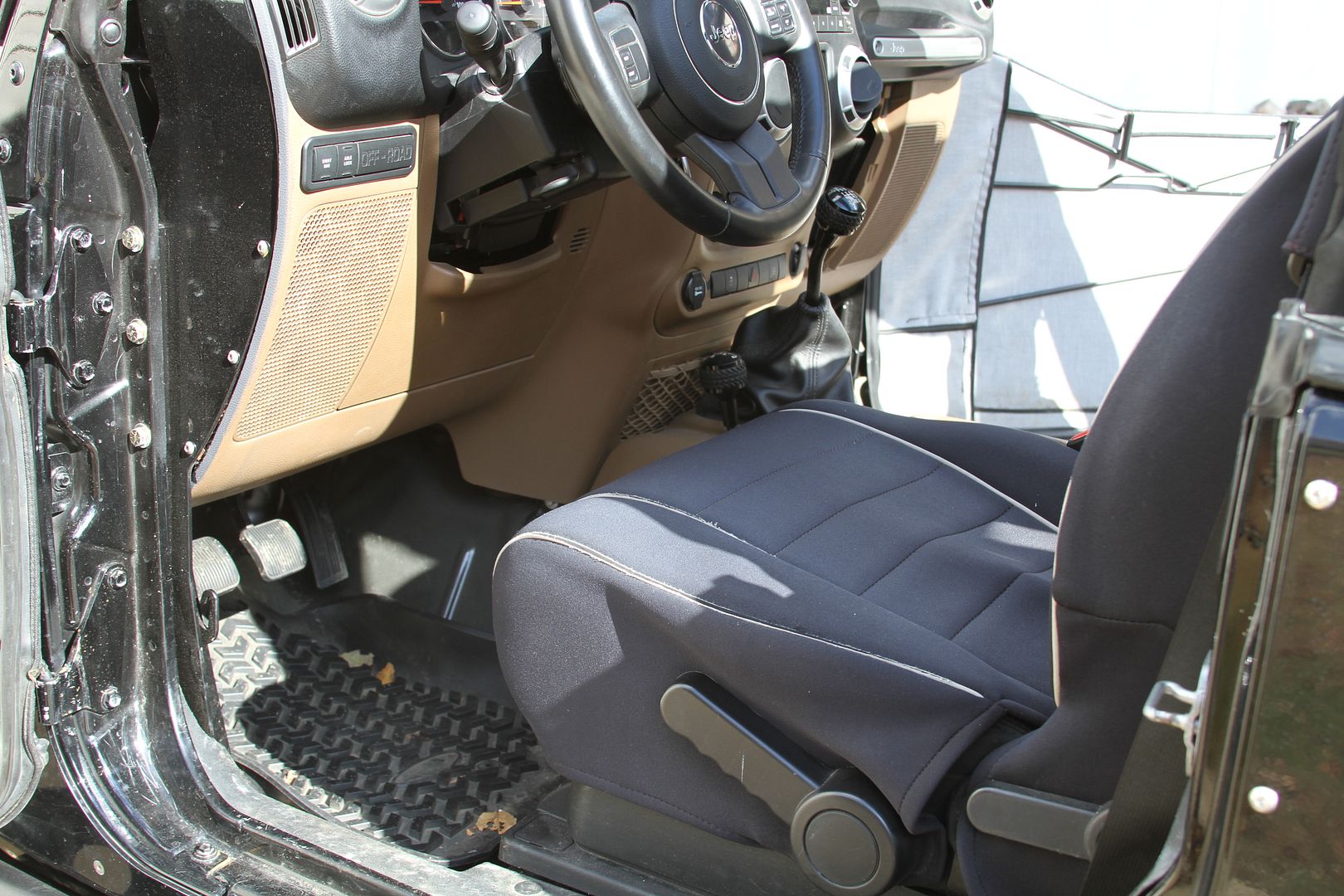

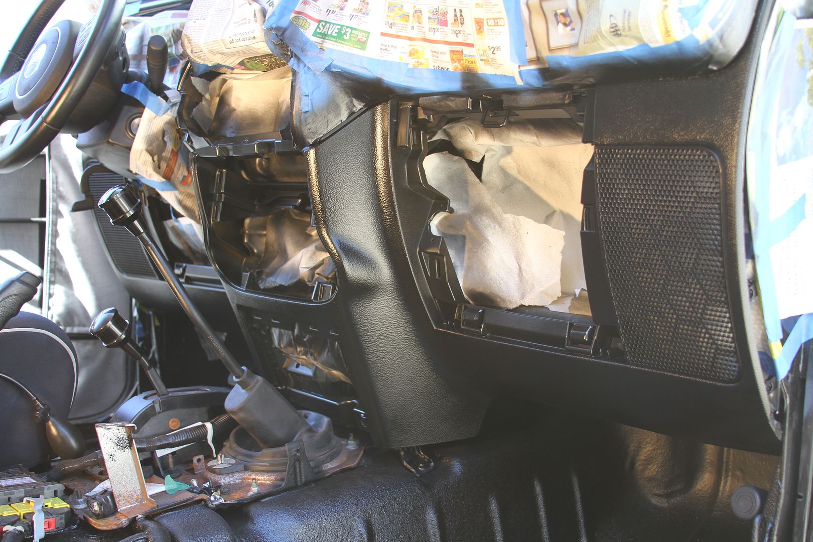

Painted Tan colored interior
During the Holidays, I got a little behind on the build thread but will catch it up over the next couple of days.
While we had the Jeep stripped for the Rhino lining, we decided to paint the tan colored interior pieces. When we bought it, I briefly thought Khaki might be the “accent color” on the black Jeep so I didn’t mind the oddly mismatched interior. When silver seemed to be the better fit, the tan colored pieces really stood out. They were a combination of molded tan plastic as well as black that had been painted tan. We used Krylon Fusion for Plastics Black Satin. It did a great job of covering over the pieces … hopefully it will hold up ok. It is not a perfect paint match but close enough.

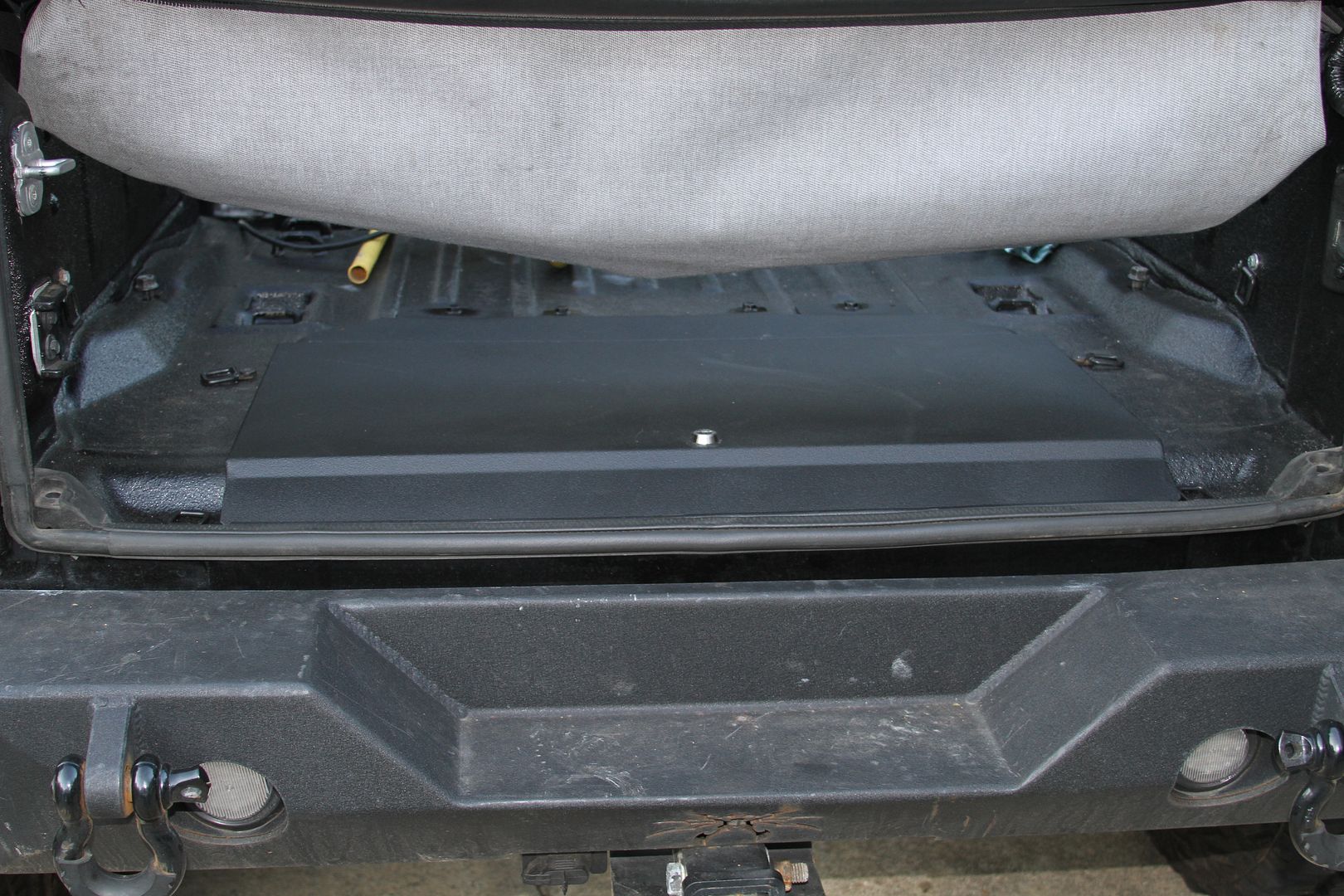

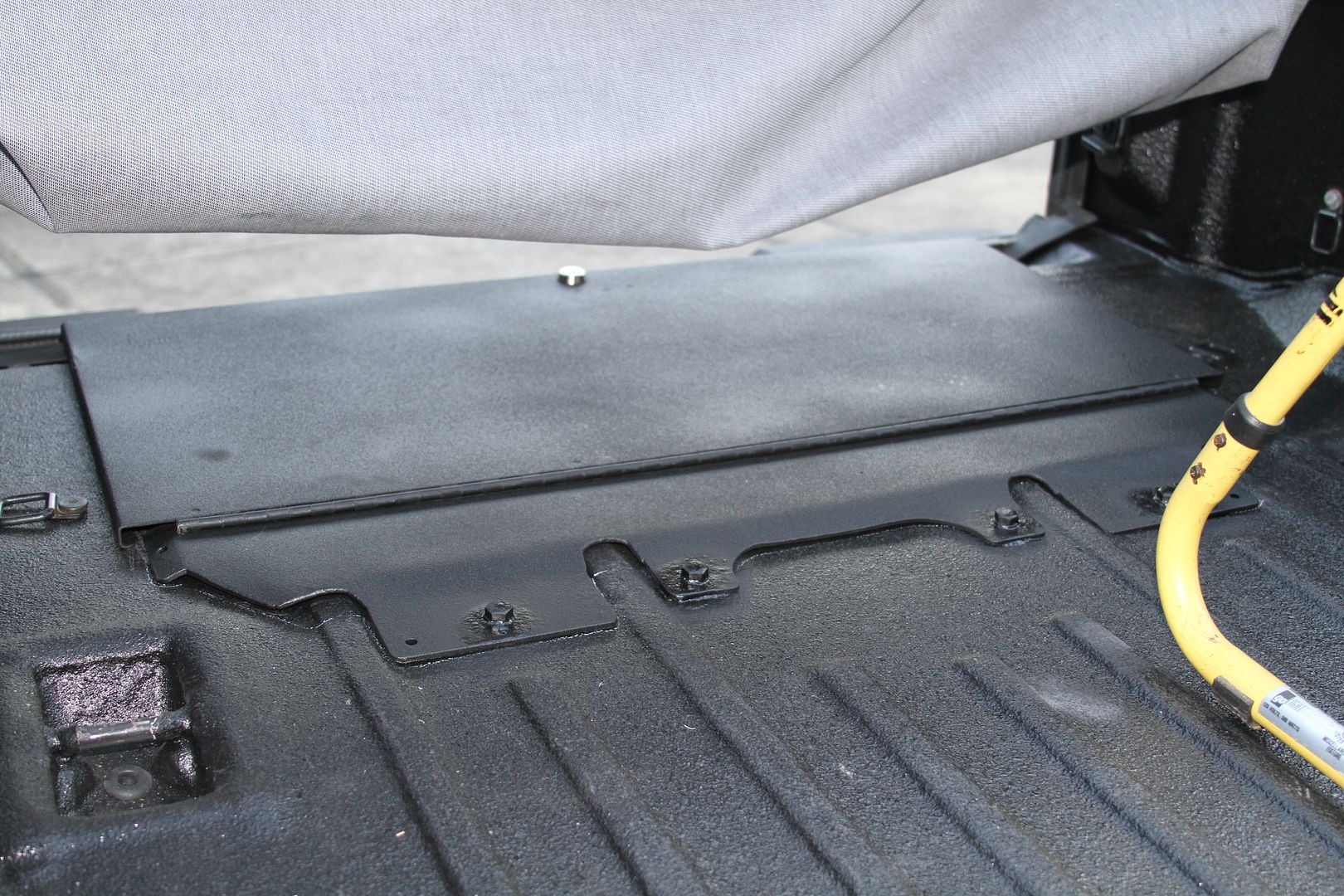

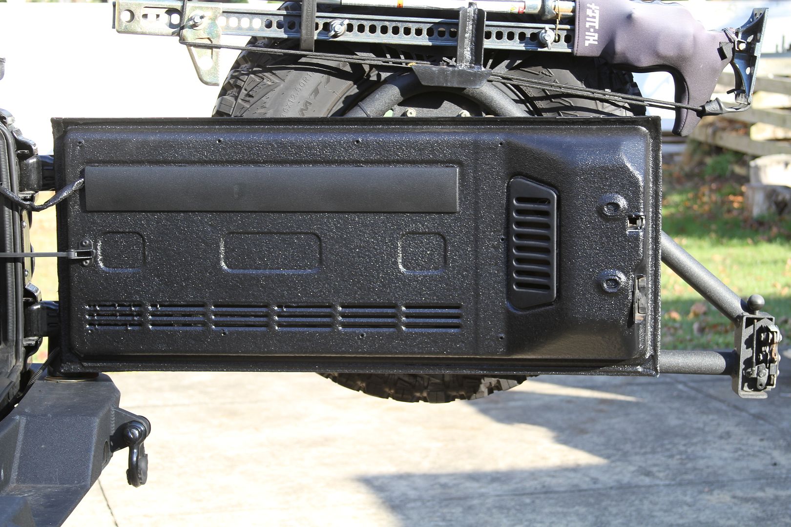

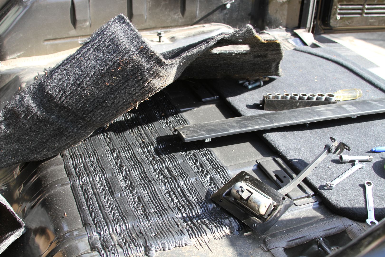

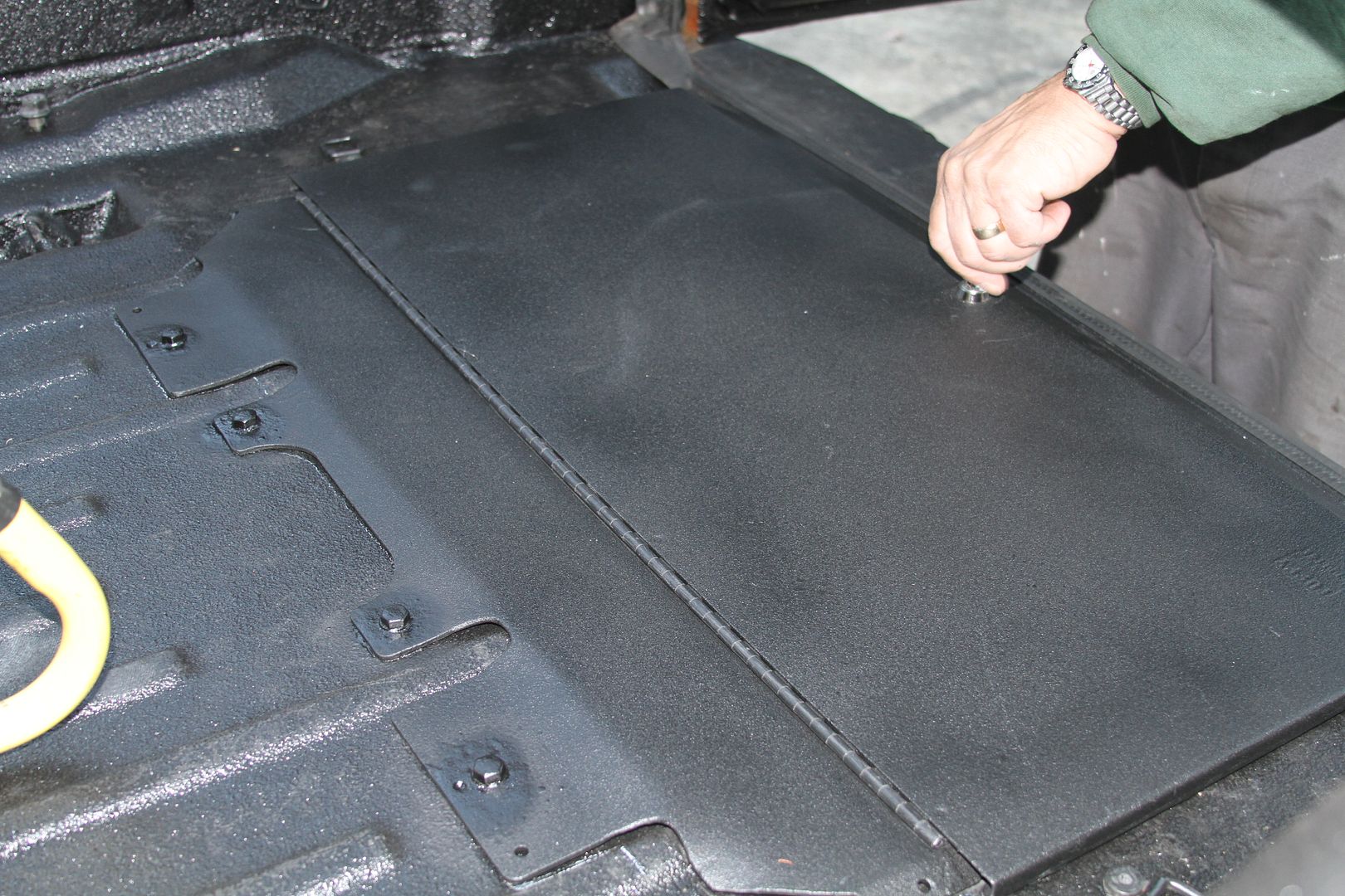

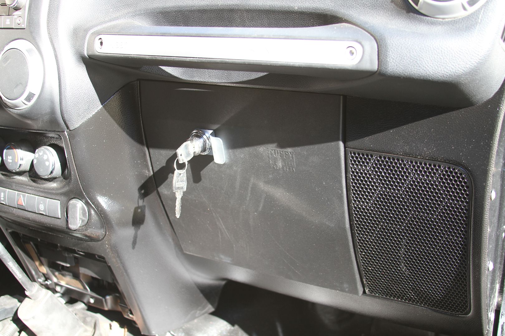

Tuffy Back Hatch cover and Steel Glove Box

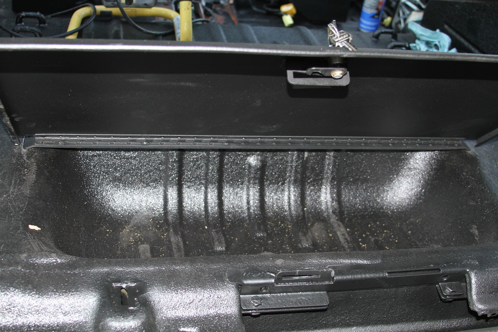

While we still have the Jeep interior torn apart for Rhino Lining, TOGM went on a quest to replace some of the interior parts (Back Hatch cover and Glove Box) with metal locking components. We went with all Tuffy products. Since they are metal, we painted with Duplicolor black bed liner in a can. It is much, much thinner than the Rhino Lining and has a less sturdy feel but seems to cover ok and will help protect them from the elements. We are very pleased with the quality and fit of the Tuffy products.
