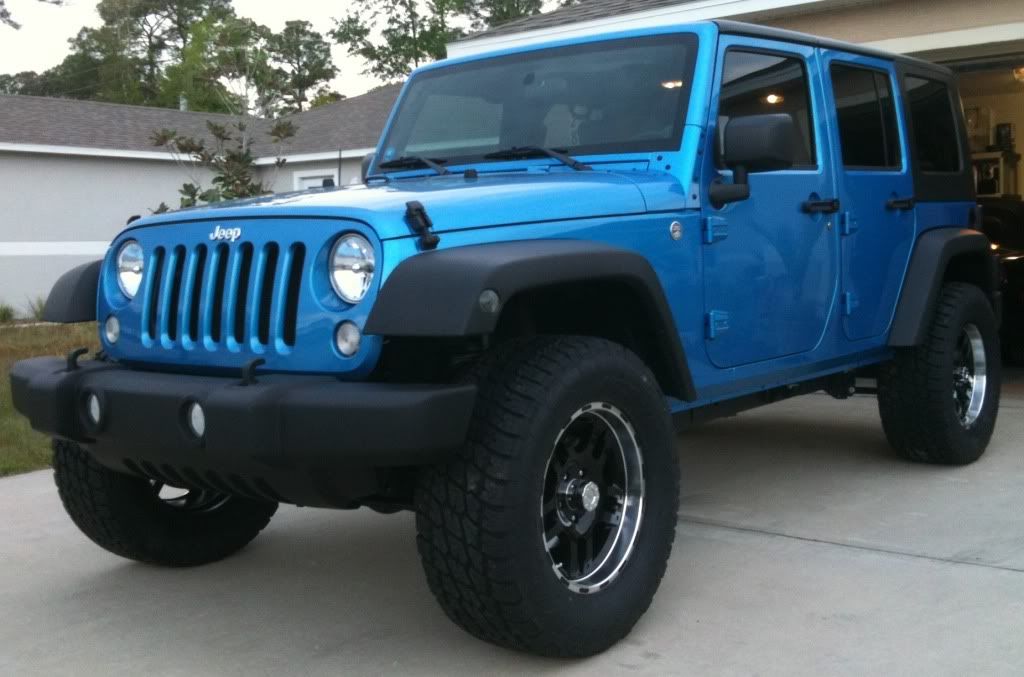

You need bigger tires. Below are 33s on 18s...

You won't notice much of an RPM change by going with 33s. It's only a 60 RPM difference at 70 MPH. You may notice the weight difference though. You can fit 33s just fine without a lift, but you may need 1.5" wheel spacers depending on the tire width. My pic above is with a Teraflex leveling kit.
I just ordered a Teraflex leveling kit tonight. I am into very slight changes, nothing major. My Jeep does not have any rake to it. So I'm not sure if I will use both spacers in front.
