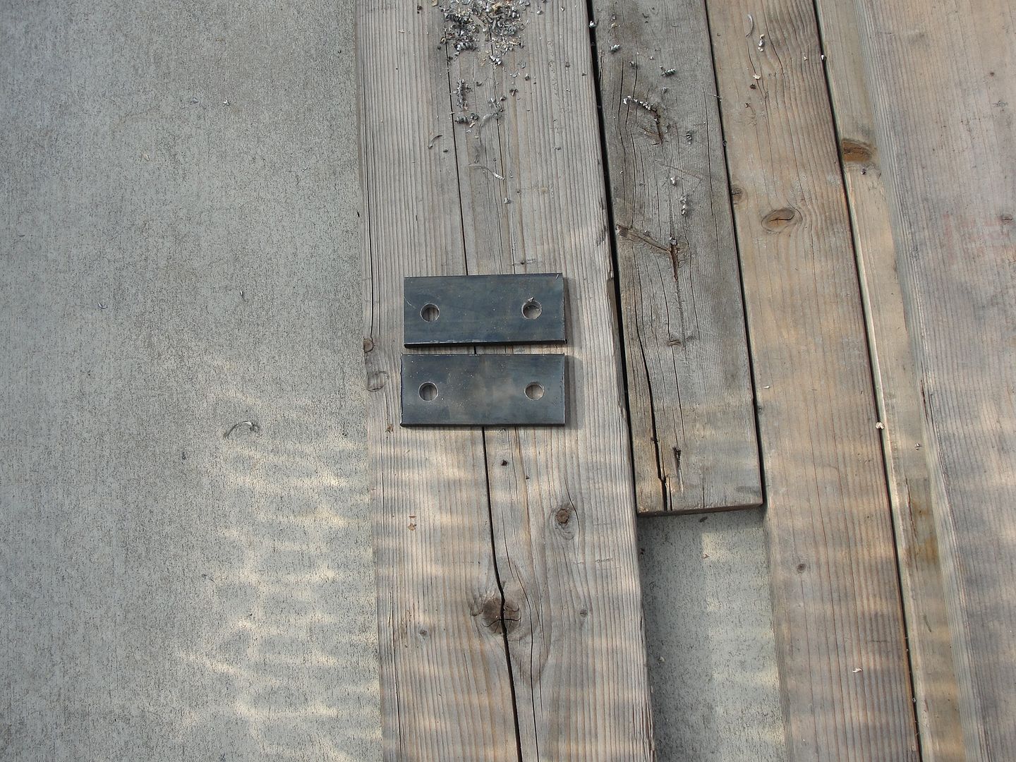

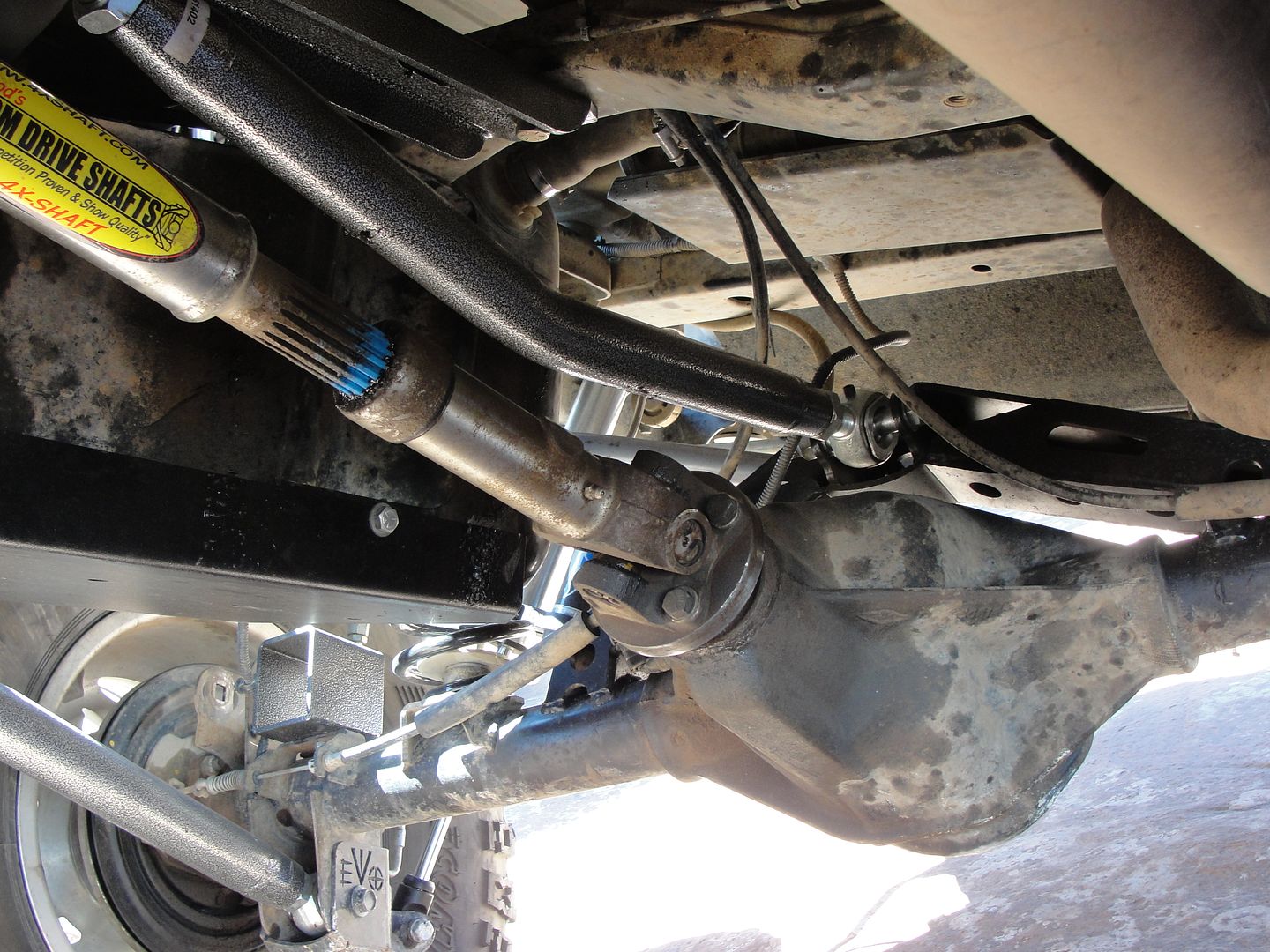

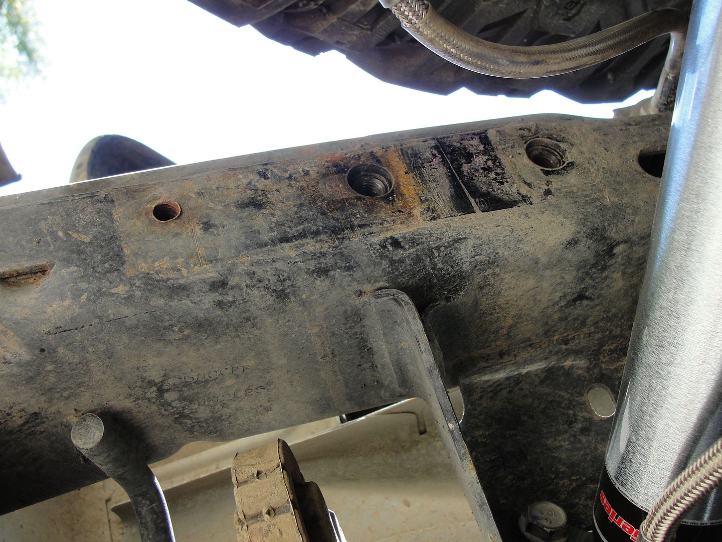

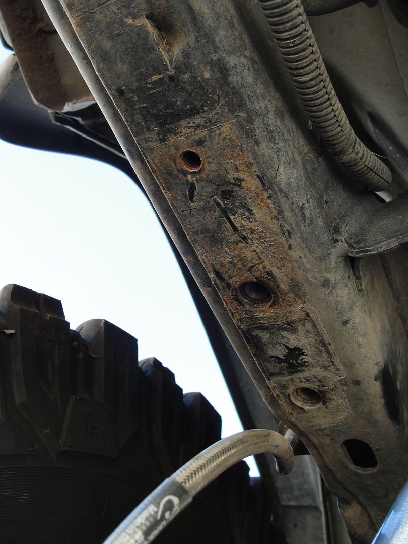

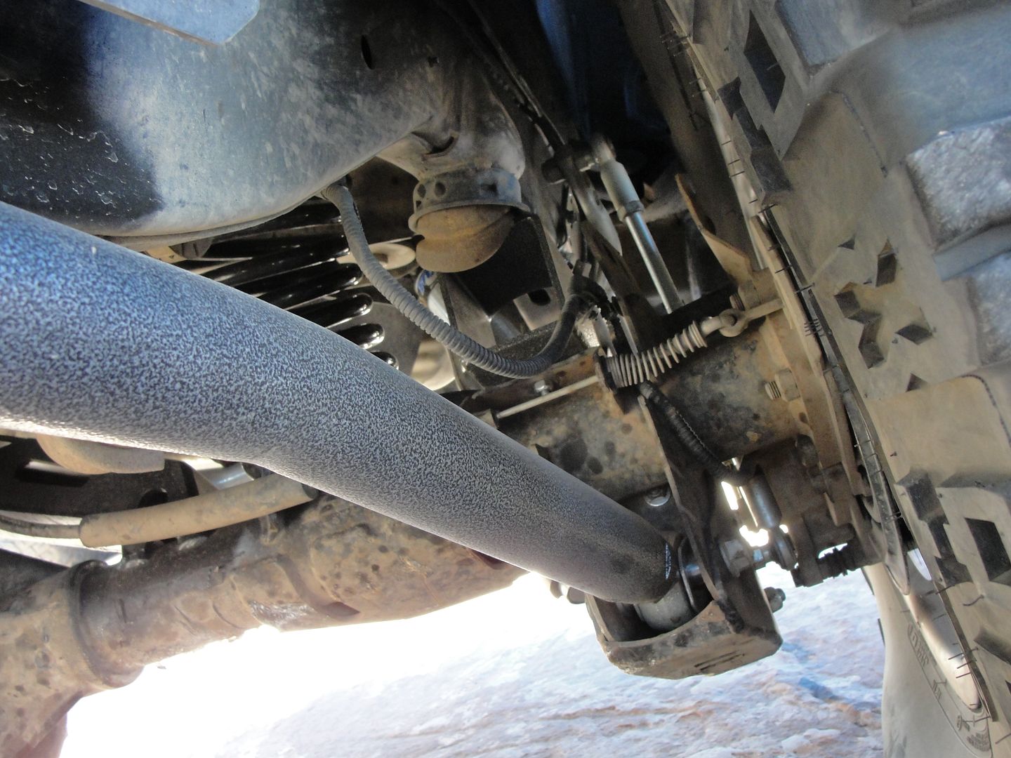

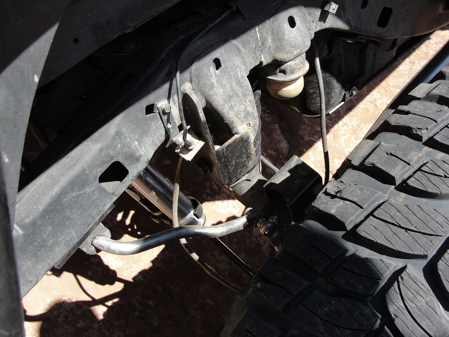

Relocated rear swaybar and modified trackbar bracket due to 1"+ stretch:

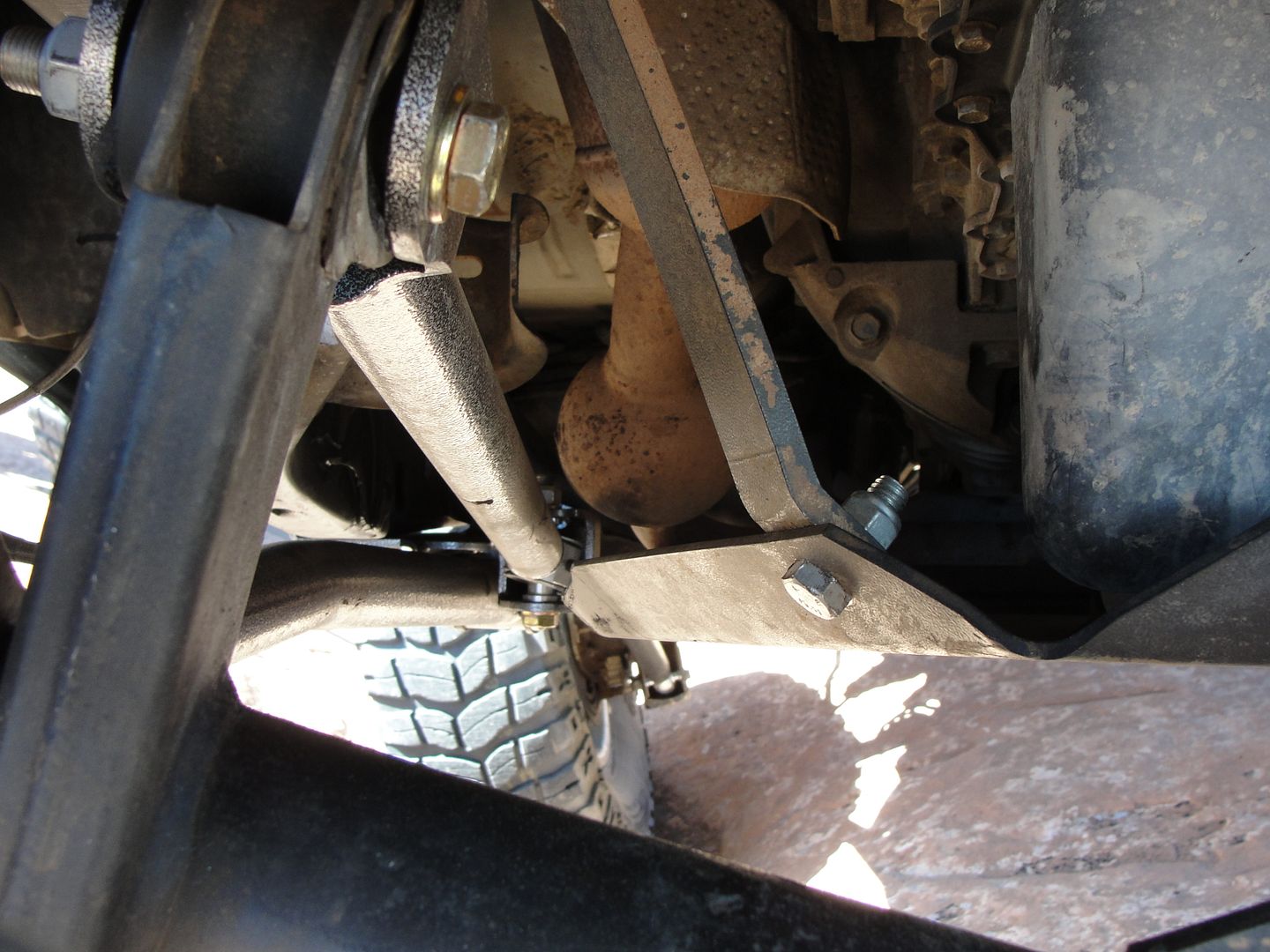

How to snug up jam nuts on your arms when it is too tight to fit a wrench:

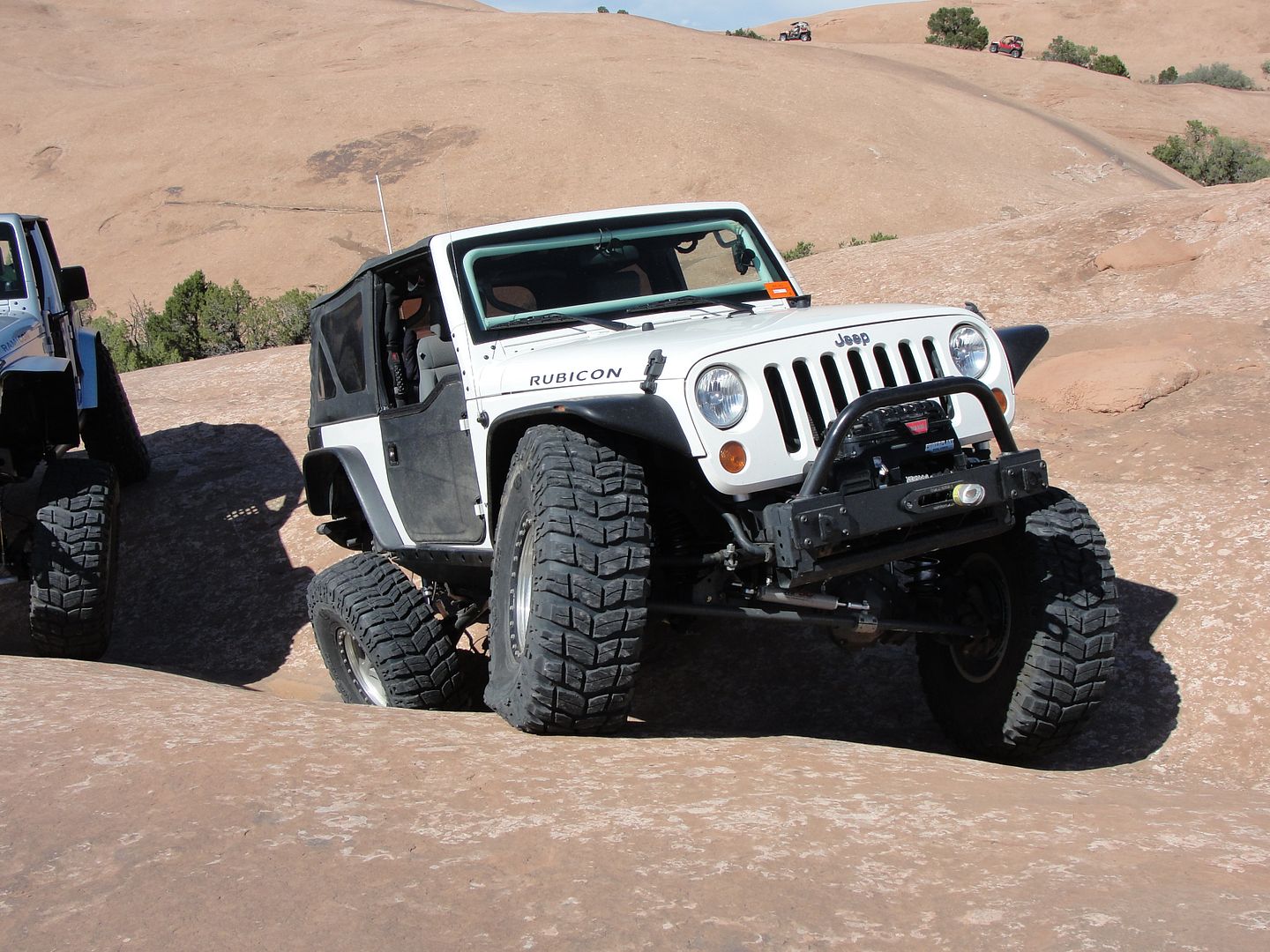

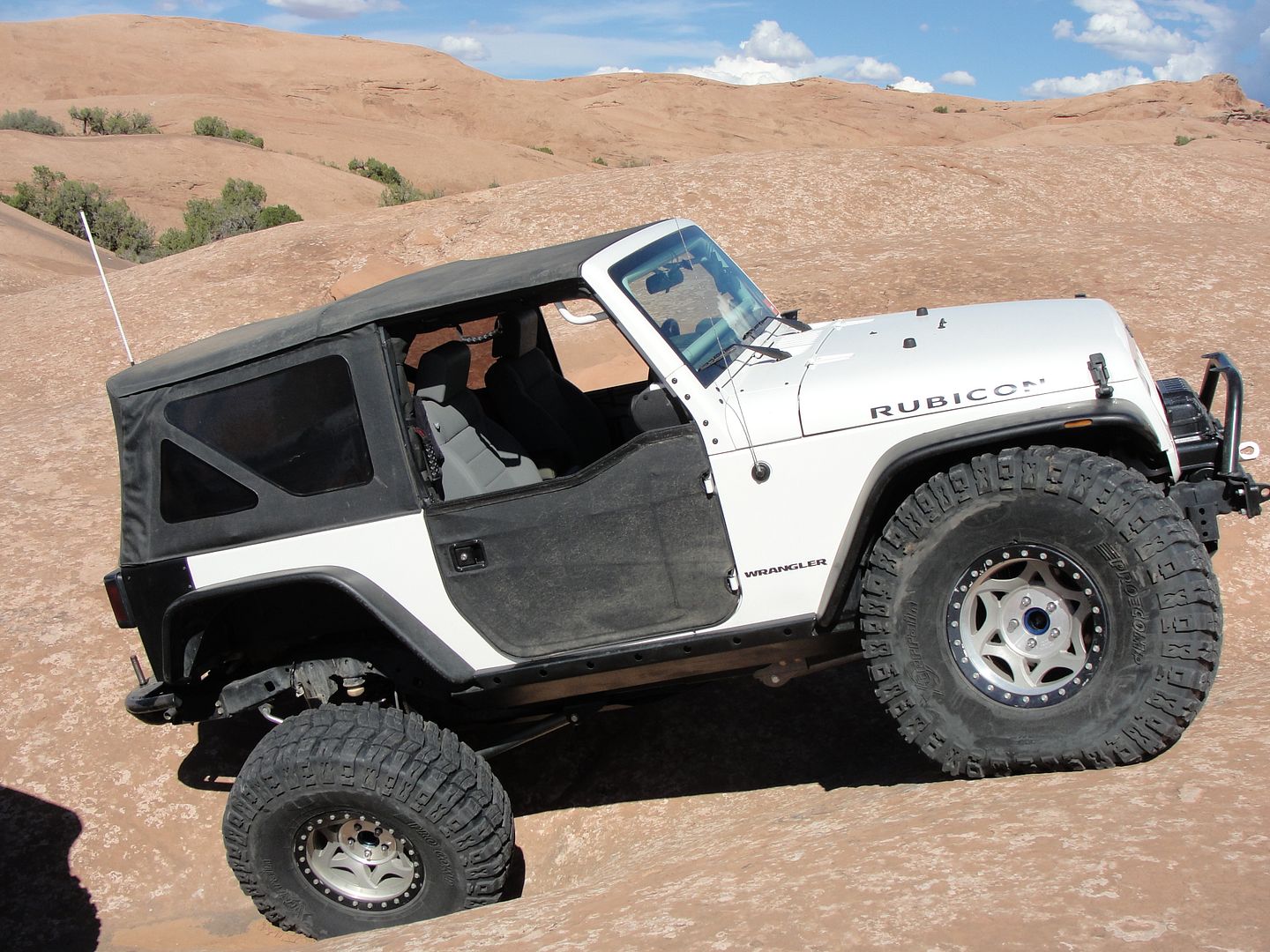

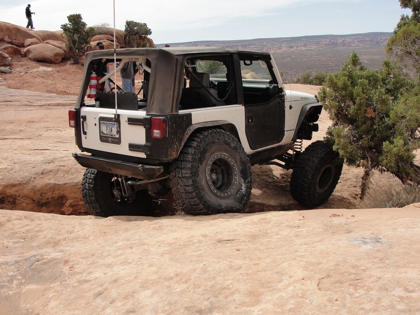

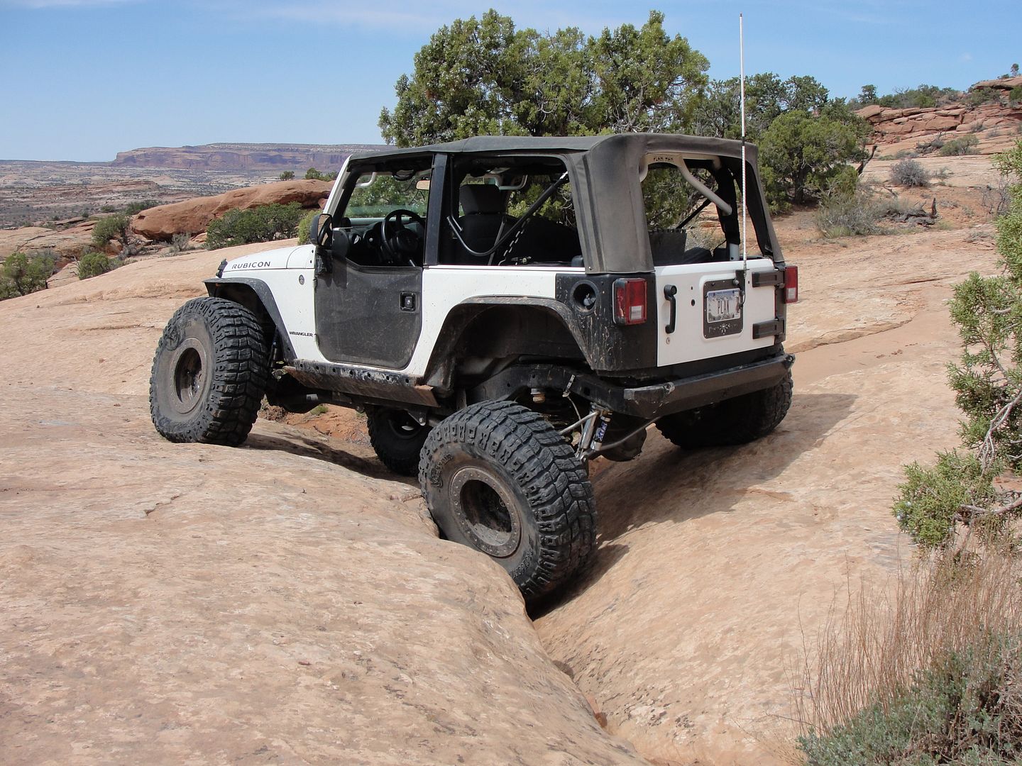

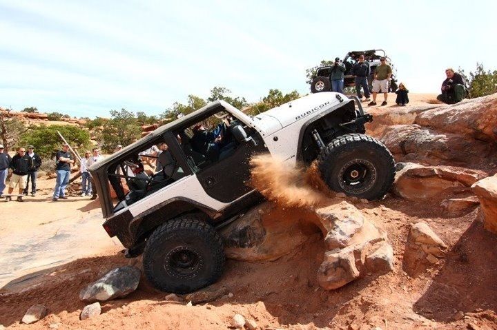

Testing things out in Moab yesterday:

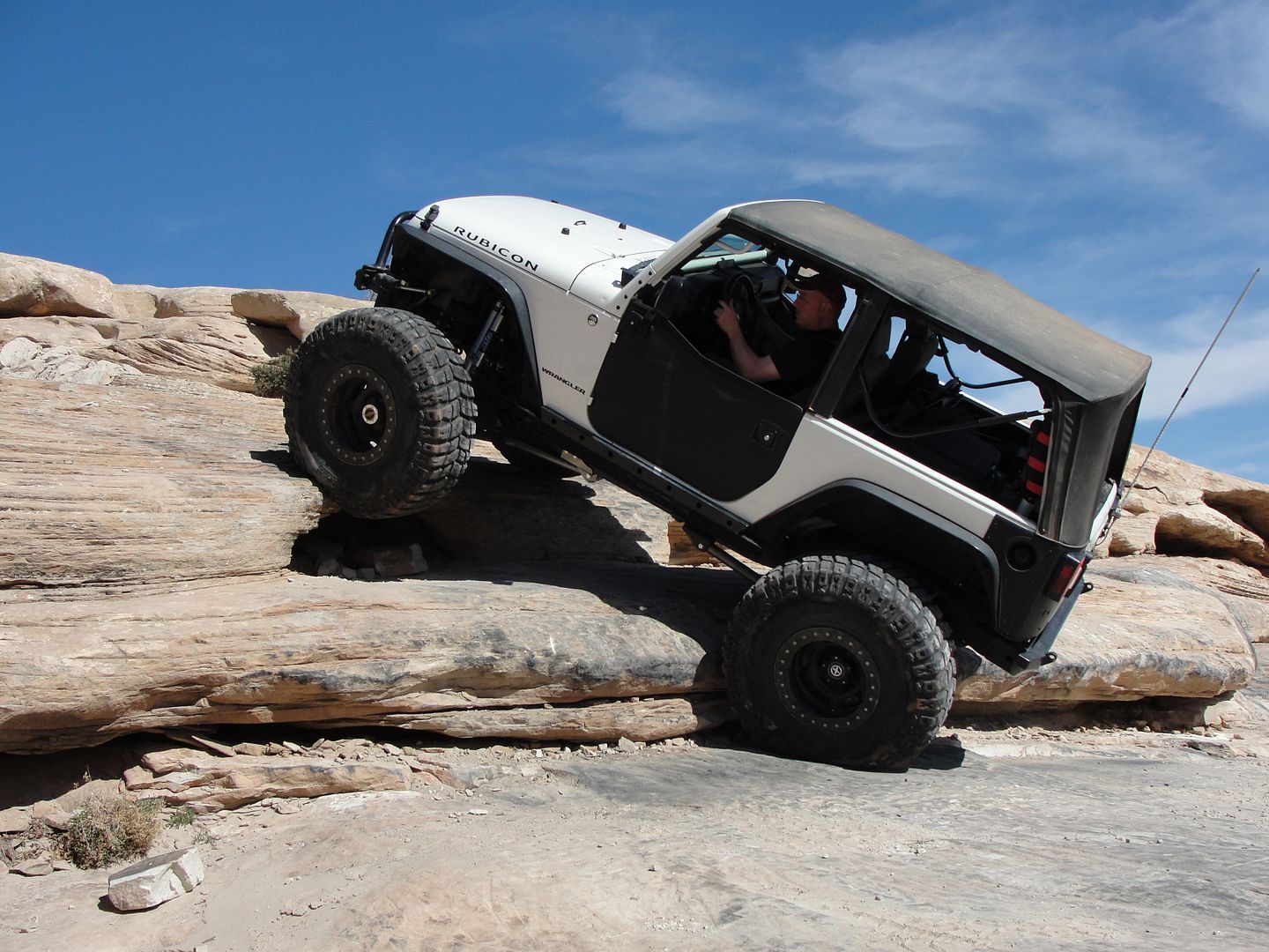

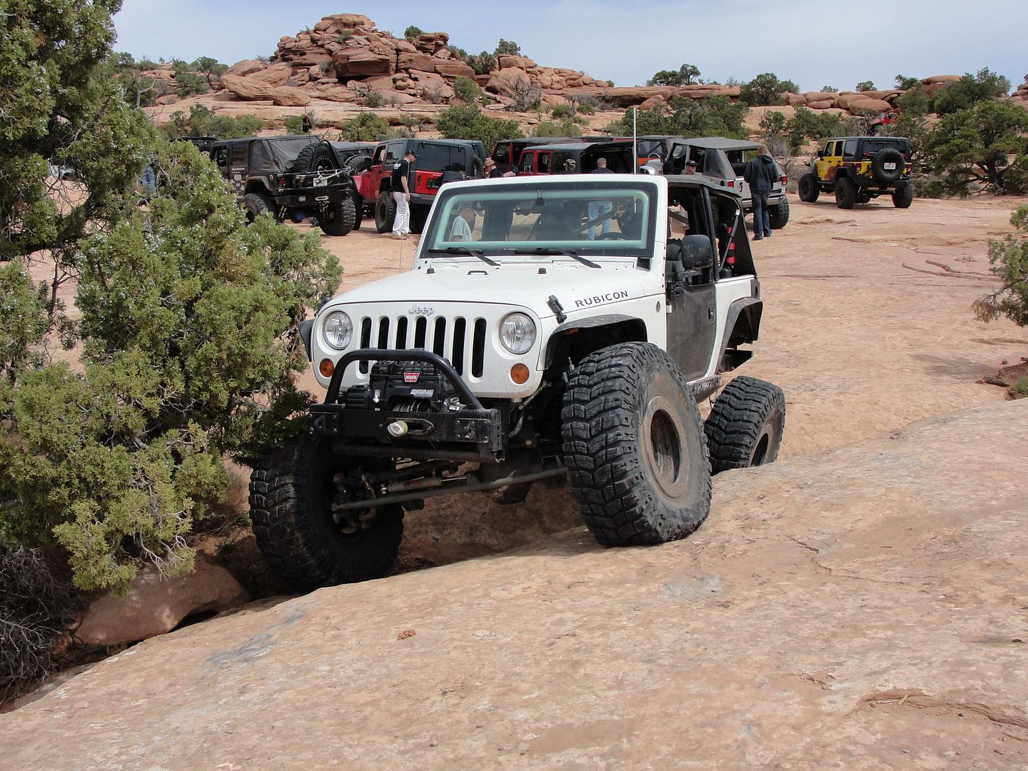

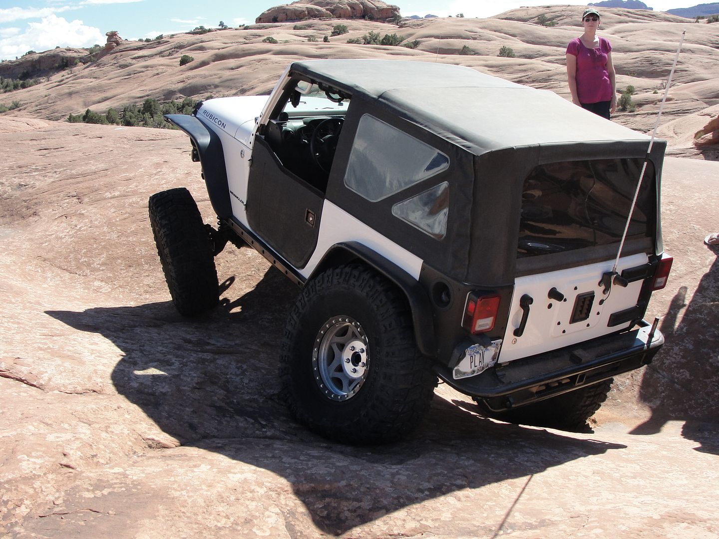

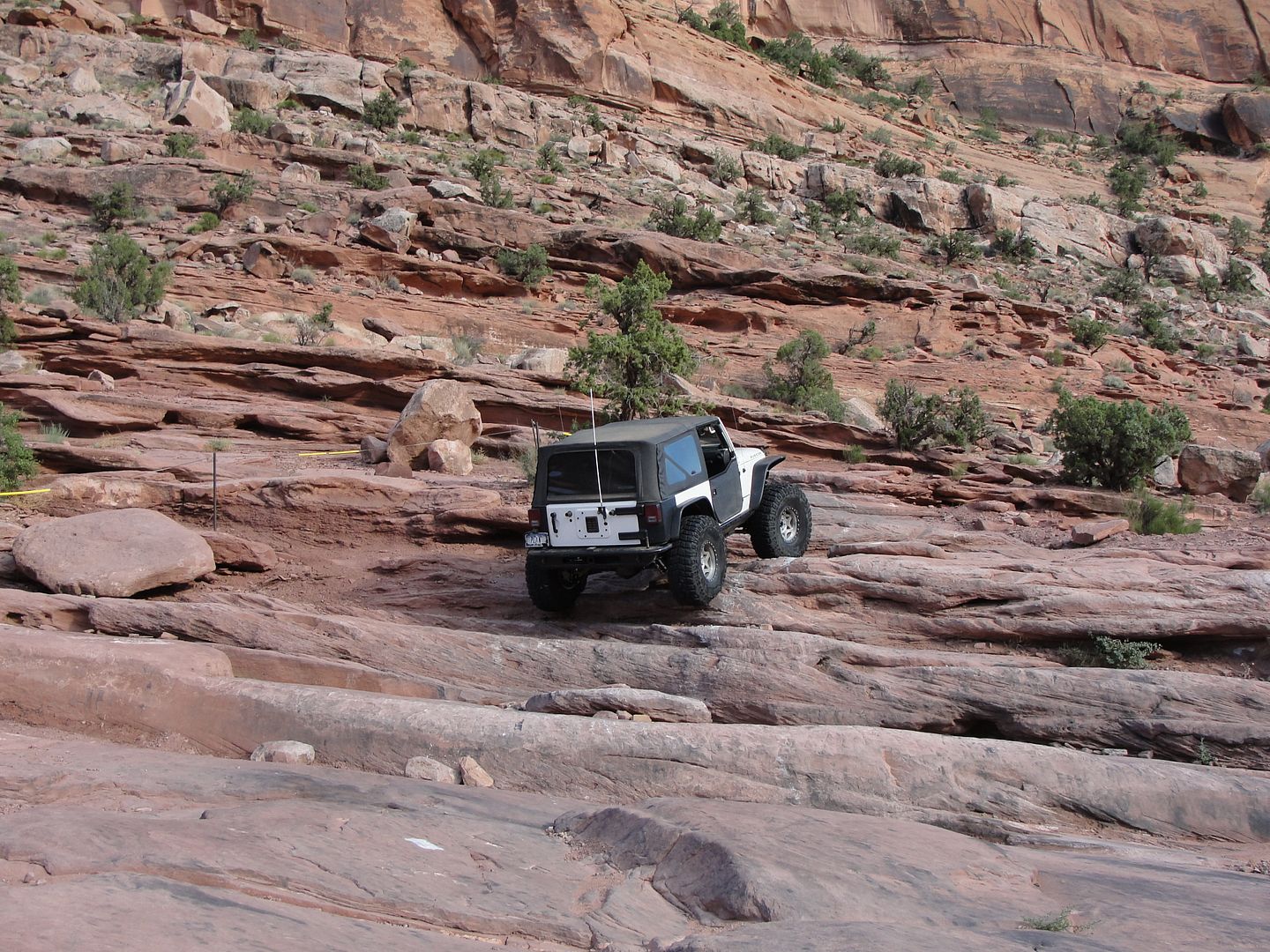

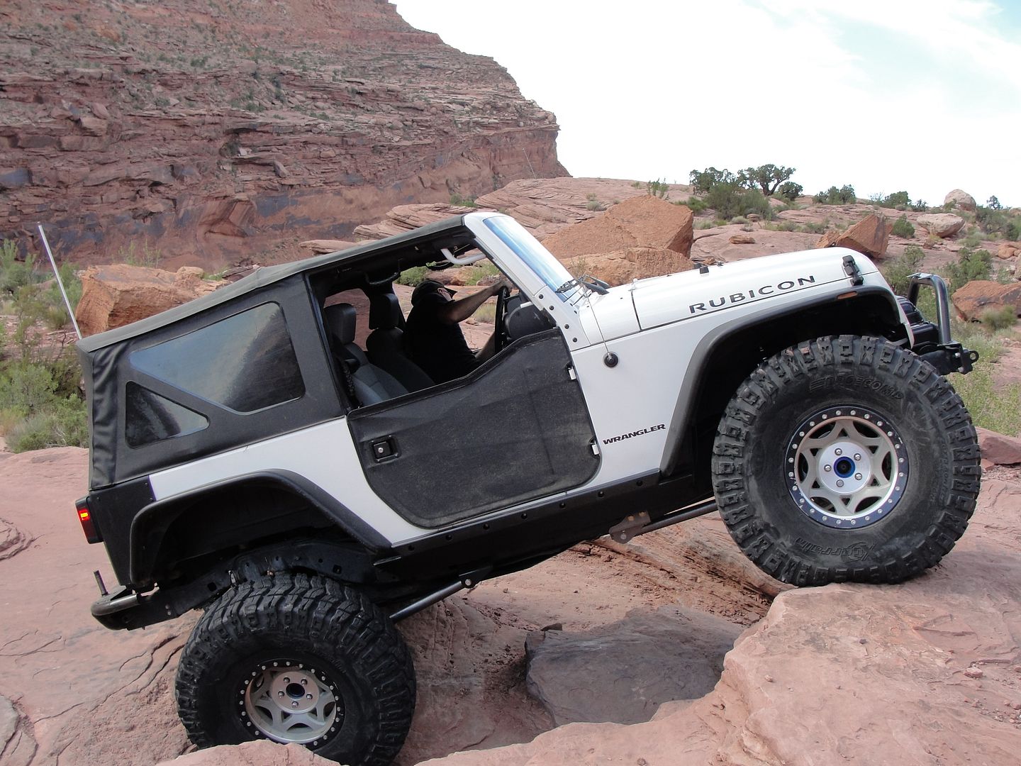

Playing on Moab Rim yesterday afternoon:
