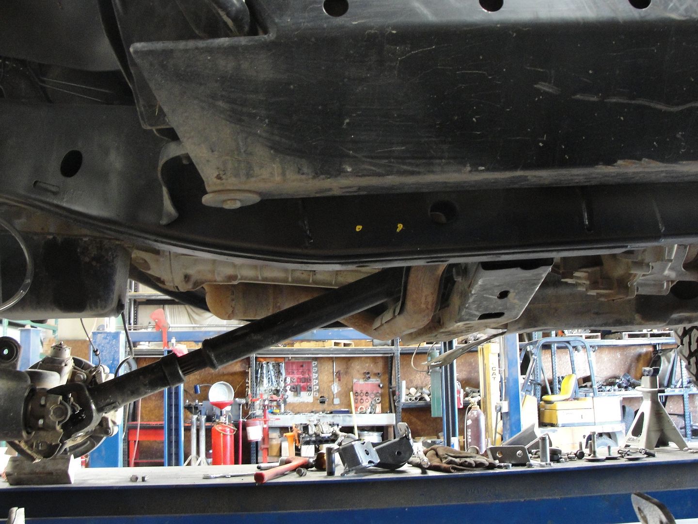

Grinding of residual control arm bracket material:
Pallet full of goodies:
I find it helpful to have a copy of the printed out JK torque specs next to a manufacturer's install instructions:
What is left after quick work with the plasma cutter:

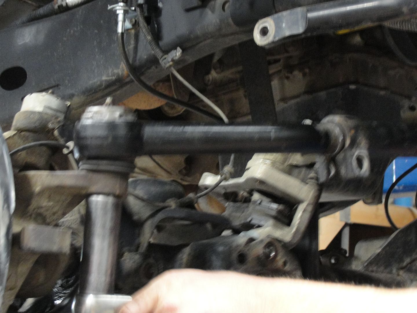

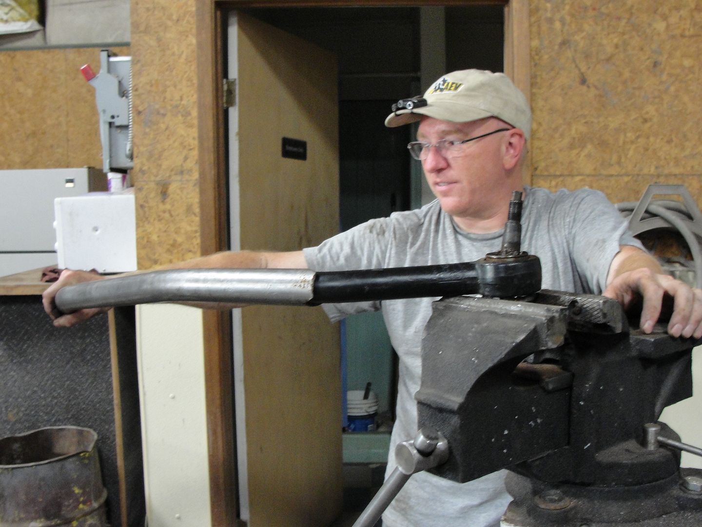

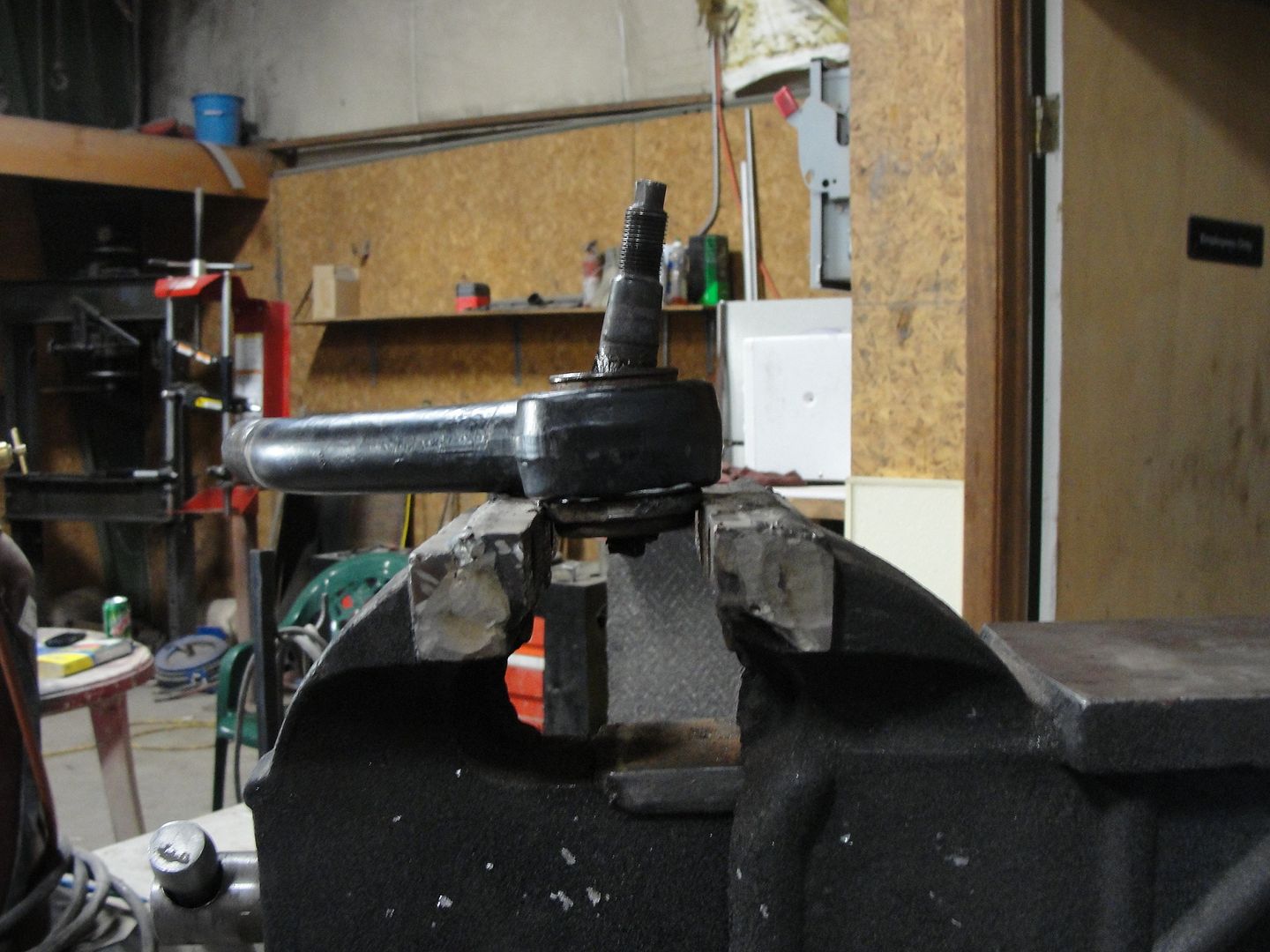

The Trailmaster kit did not come with a drag link flip kit and trackbar relocation bracket. So, here I needed to remove the end from my Currie drag link and flip it in preparation for drag link flip (flip is highly desireable with a 4" or taller lift):
It was in there tight:
I found a knuckle and relocation bracket run on an AEV drag link flip kit. So, I switched out knuckles on my axle for the reinstallation:

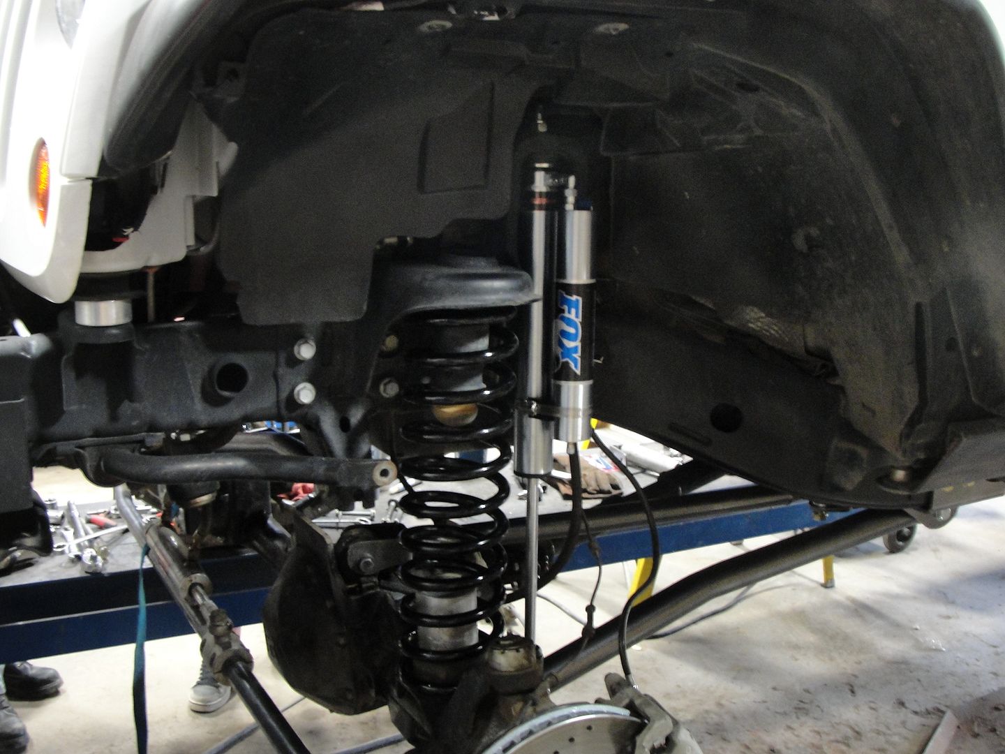

Arms and shocks in:
Quite a way yet to go.
This would take much longer at home, but the guy who owns the shop that does my regearing for me let me use one of his lifts for the install.

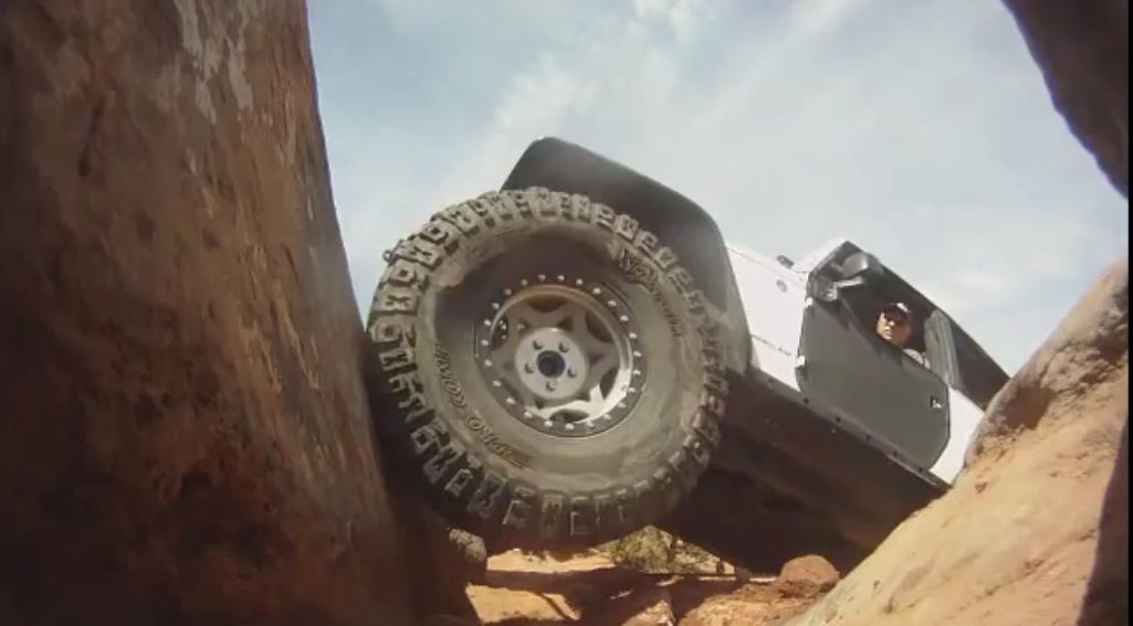

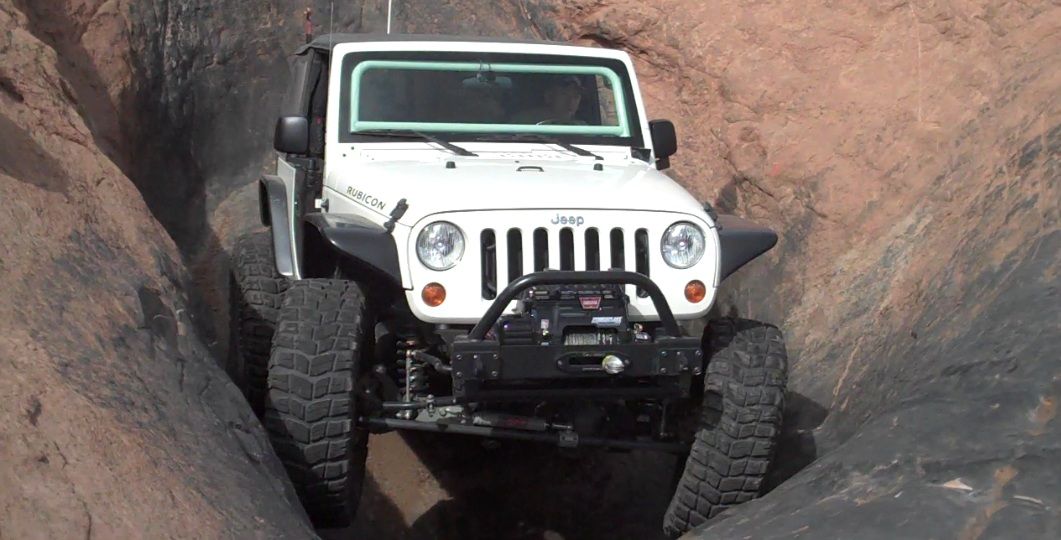

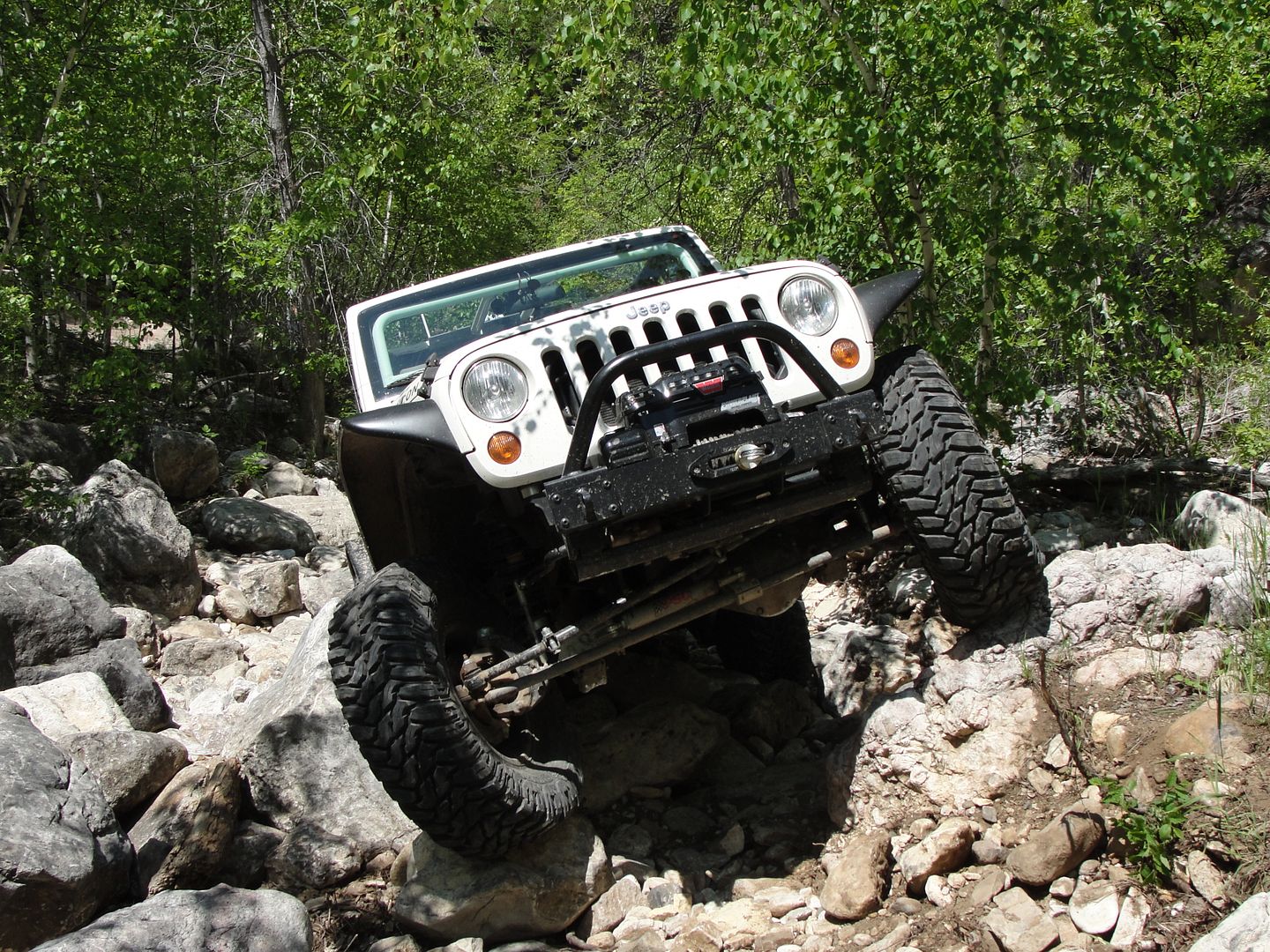

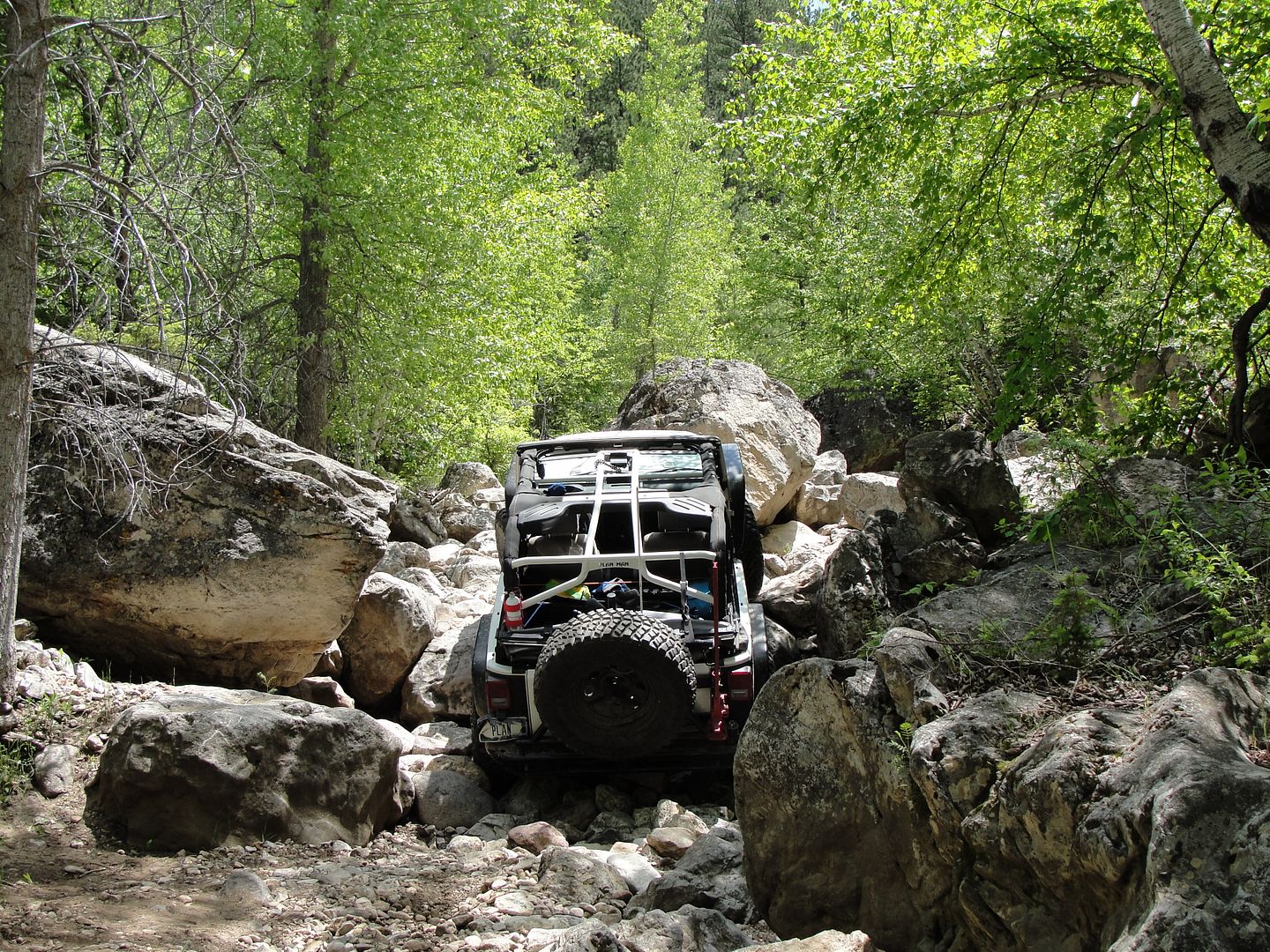

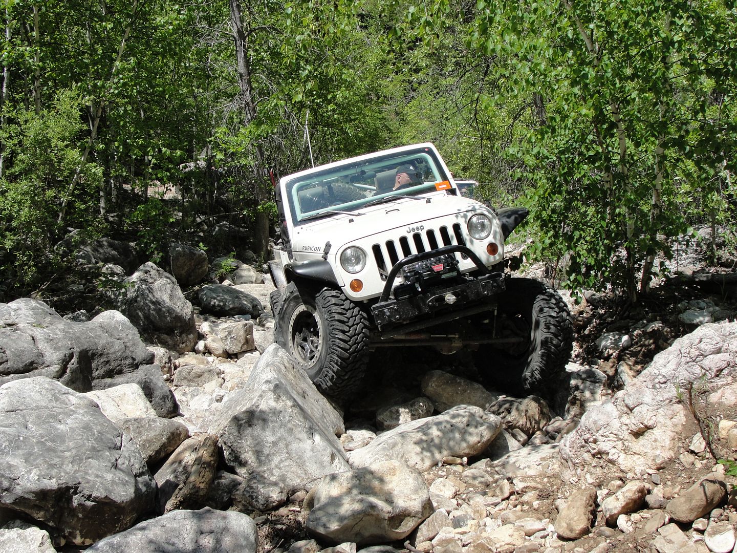

A few pics from EJS earlier this year:
planman is offline

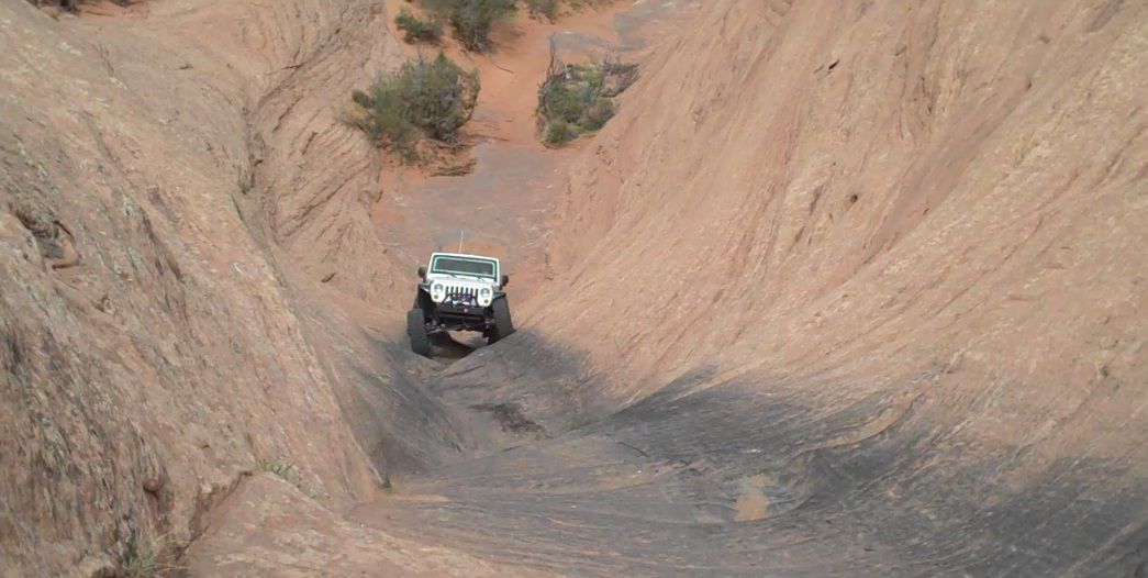

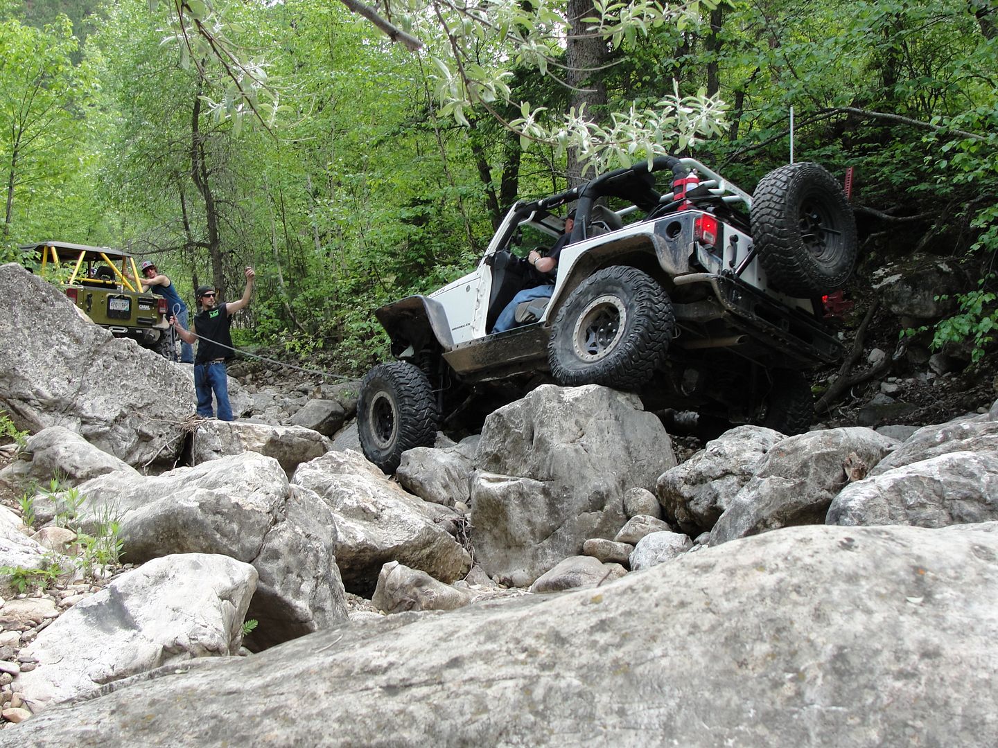

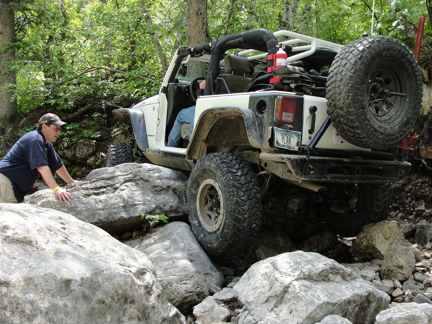

A few pics from Black Hills Jeep Camp on 37s:
I could have used the 40s here:
planman is offline
