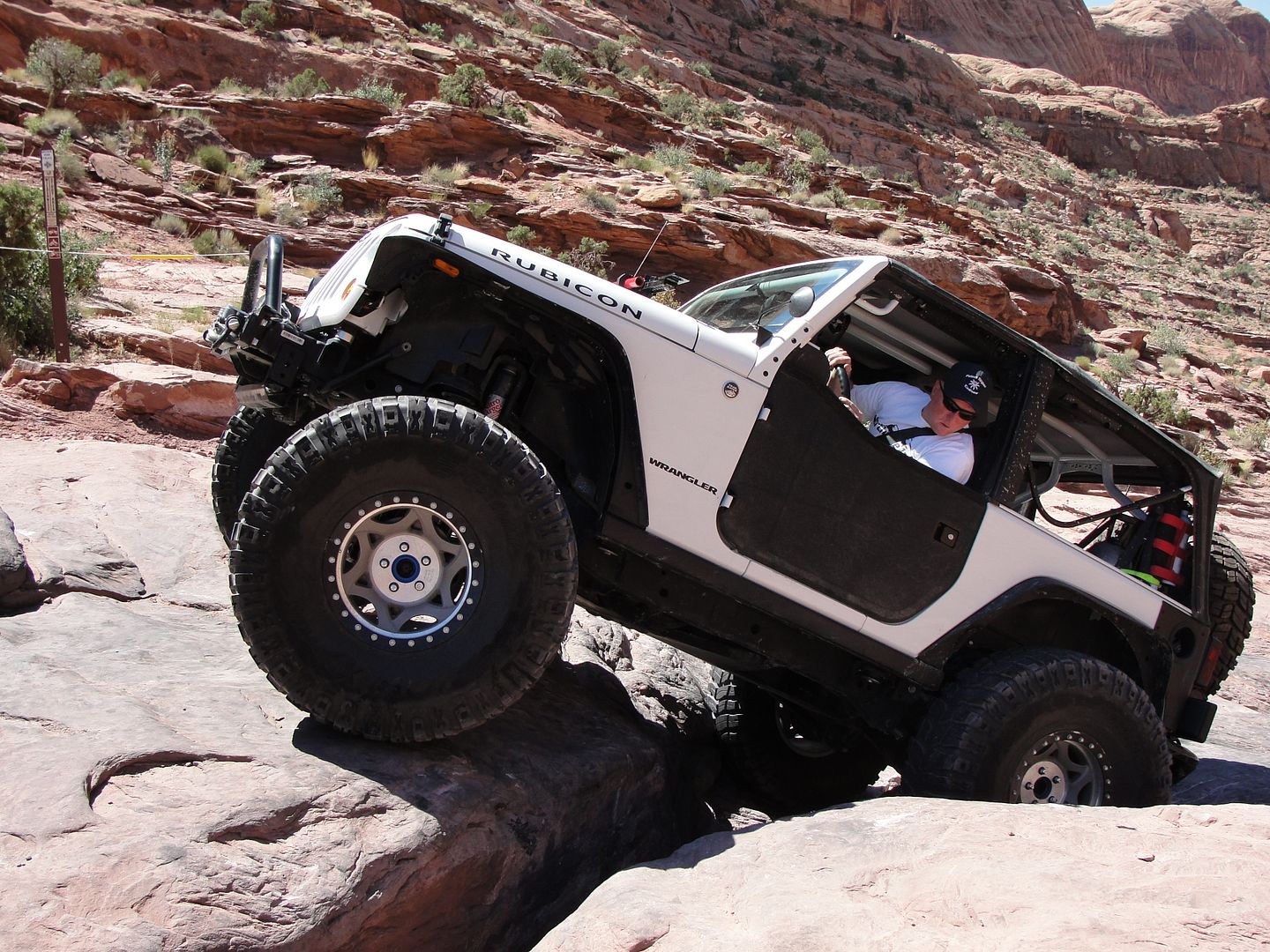

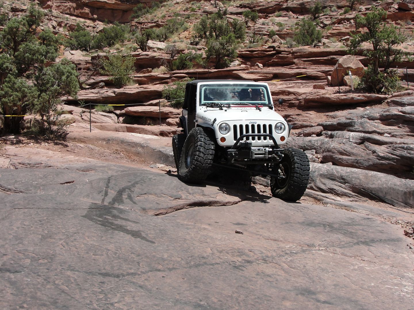

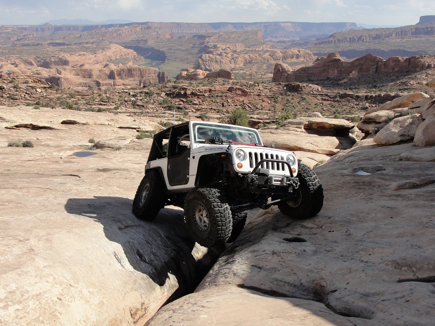

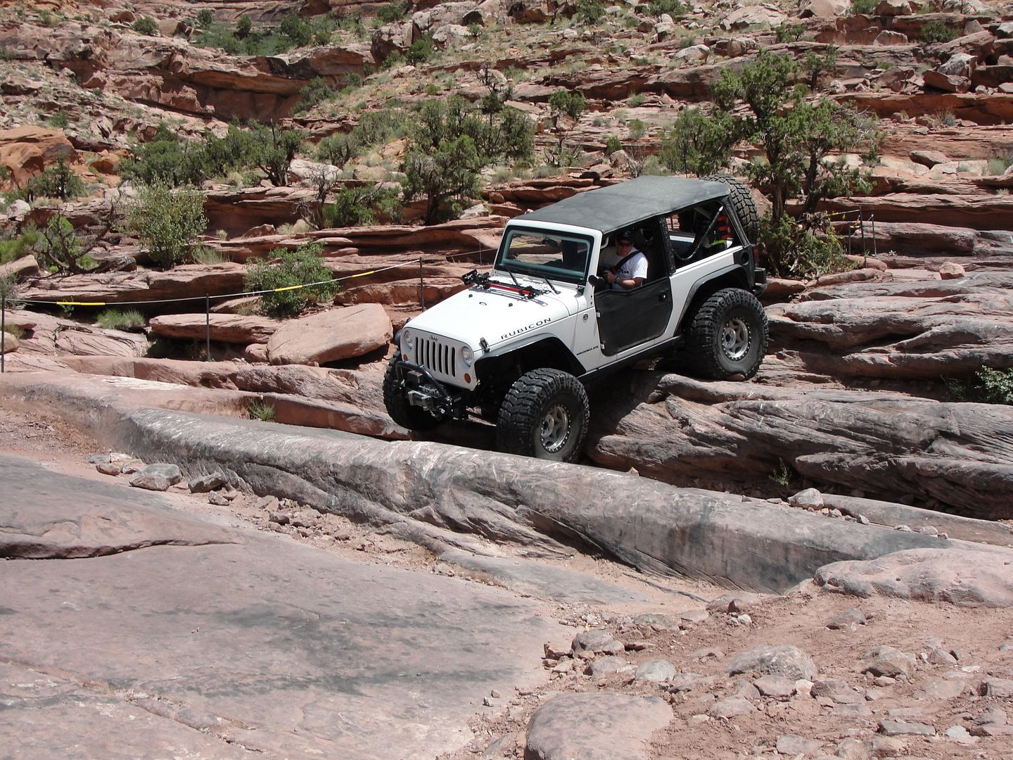

No. I knew I would wheel hard with the 37s I had on before the 40s. So, I upgraded to front and rear chomoly axle shafts. The shafts held up really well to hard wheeling with the 37s. No problems.
Anyway..everything still working well.
Wish I had the hydro assist steering installed already. Psi below 10 makes it pretty hard to turn.
Pics from Moab Rim today:

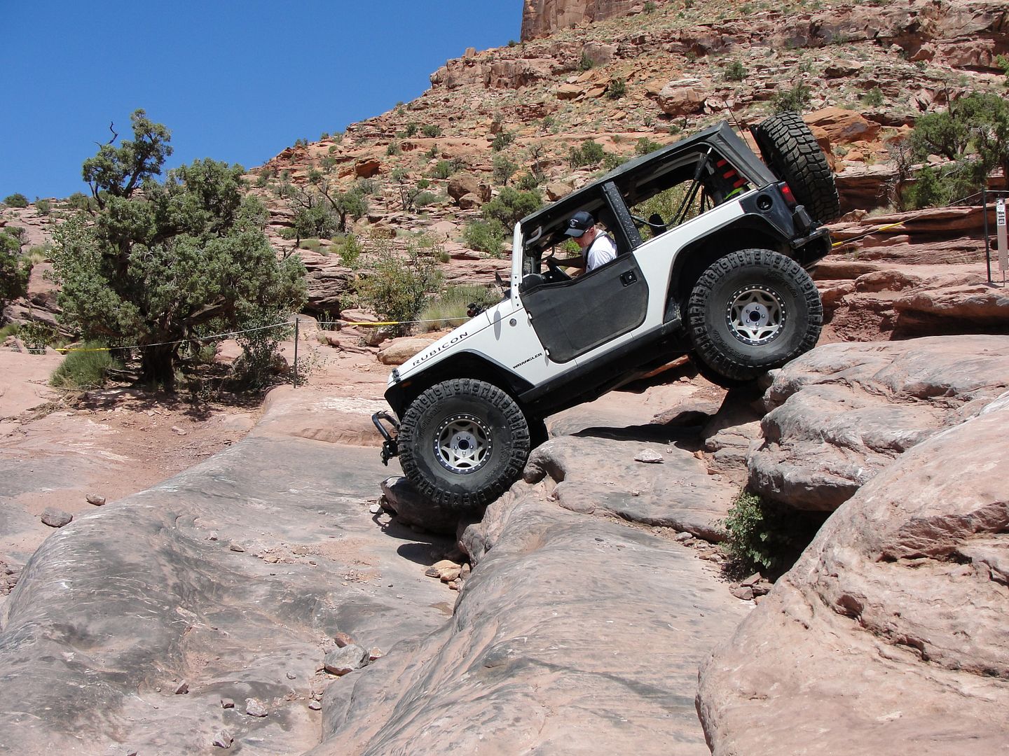

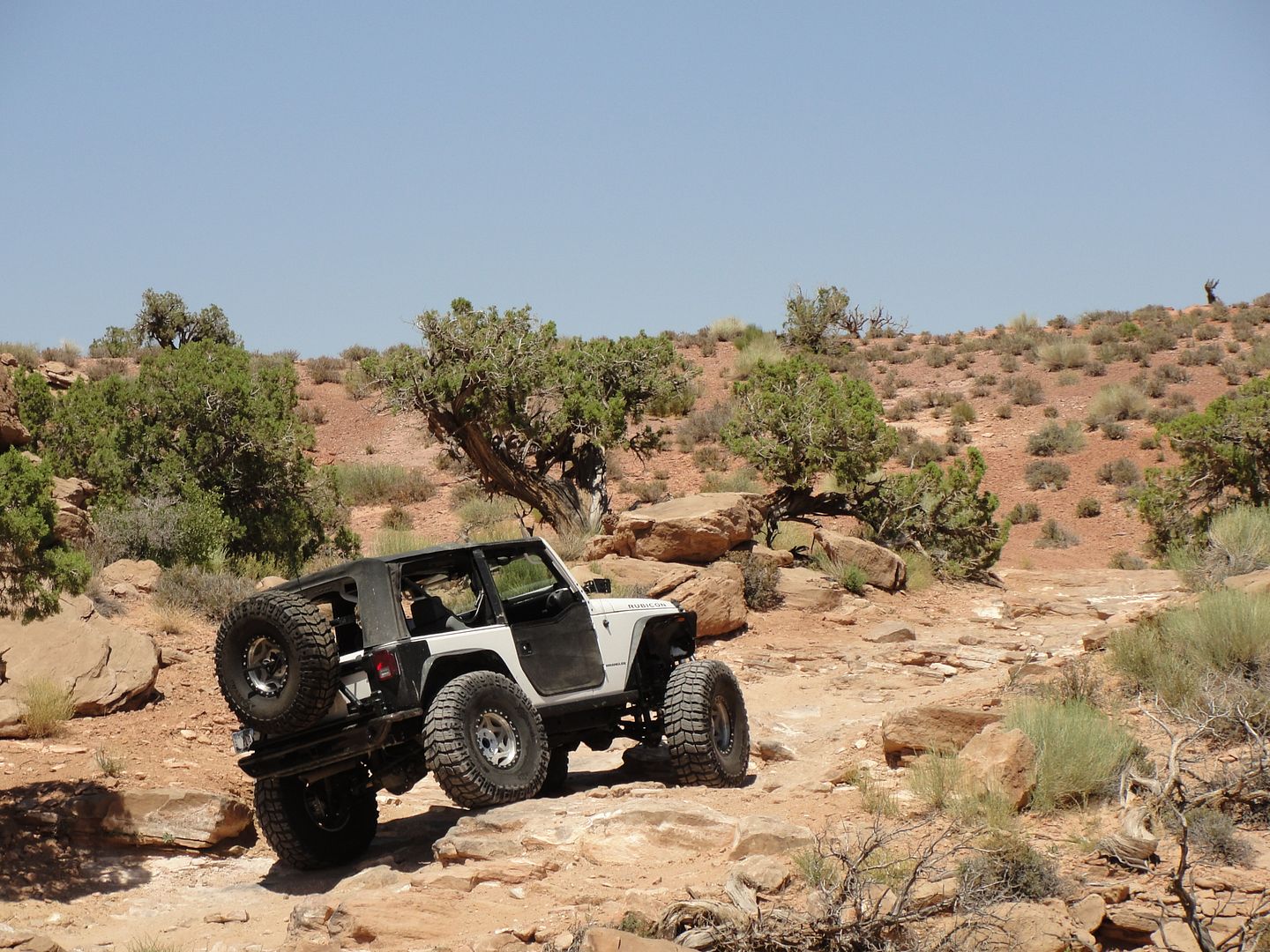

More testing clearances today:

Are you planning on correcting the rake, or do you like it that way? I have always thought it looked pretty sick with a small rake and a comp cut, but you haven't chopped up that much of the body.

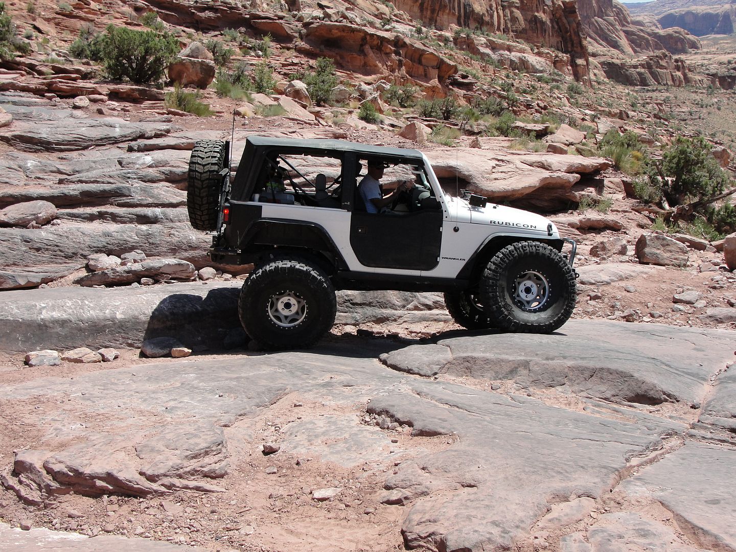

I realized I don't have any side view, flat ground pics, but with the addition of the 135 lbs spare and the swing arm/tire carrier, the forward rake is essentially gone. By the time I reinstall the hardtop for winter, it will be level.
This is a pic I do have:
