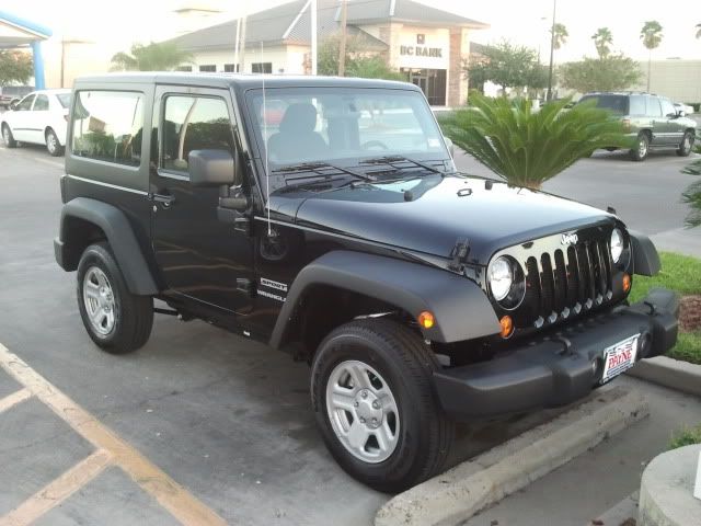

New '13 JK :)
I haven't been on the forum for a few years, it's kinda funny looking back at all my old threads now and remembering all trouble I had with the old '82 CJ. I had forgotten about most of those adventures, and that I had been looking for another old Jeep with no success. I guess the Jeep bug never went away, recently I just went ahead and bought a brand new 2013 2 door JK. Best Jeep i've ever driven, smooth, powerful, and clean. I'll have to do something about that last part. Plans are simple, lift it 3-4", black steel wheels and 35s.

but not cheep. at 3-4 in lift it wont be so simple too.
what gears did you get ? If it has the 3:73 going 35 is border line but doable. 3:21 wont be so good.
Lifts at 3-4 need to be complete.
35"s and 3-4 lifts on 2D make a great trail Jeep and DD.

Thanks for the info! I'll look into my gears, i don't think I have the 3:73s but I am not sure. Seeing a Jeep with a 2.5" lift and 35s here that looks great.. Might not need to go as high as I though. Especially if I have 3:21s, maybe i'll have to stick with 33s.. I live near South Padre Island, my offroading will consist of driving on the beach through various conditions of sand to get to the good fishing spots.

Man....seeing that reminds me that the base models just look wrong. The tires are rather tiny. Only reason it should be bought is for what you're doing...to immediately change out the tires
Congrats on the new Jeep. The JKs really are awesome. I absolutely LOVED my TJ...family expanded and got a '12 JKU Rubi...absolutely night and day driving differences. I miss some of the simplicities of it, but then I remember how much more quiet and smooth driving the JK is
With 33s and the conditions you'll hit, you really won't need any lift at all. And the 3.21s should drive 33s just fine.

Congratulations! A black JK is a nice vehicle to build on. Post up the build as you go.

Thanks everyone. I'll check that shop out in Mcallen, but probably wind up doing my own wrenching, it's kind of a hobby. I found my window sticker, and I do have the 3:21 gears. Looks like i'll be sticking with 33's for now, but definately want to go with 15" wheels. Looks like the Cragar Soft 8's will do, 15x8 with 4" of backspacing, unless I find another brand with the 3.75 back spacing and a comparable price. Don't mind grinding a hair off of the calipers, I've done worse to new cars. Funny someone mentioned their wife taking over the JK, mine did the same. I had to go buy her a new Camaro so I could get my Jeep back.
