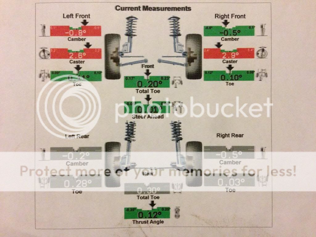

This is the printout after the first alignment. The guy said he could only adjust toe. The castor angle is out by a bit.. But how much is too much? My mechanic said it was close enough to not worry about.

Yeah thats some horrible caster. Id at least get lower control arms on the front.

That's odd usually the Teraflex lifts come complete with "everything you need ". Looks like the alignment results are showing otherwise.

Would you be able to recommend the parts to fix the castor problem? Im pretty decent working on vehicles but don't know much about suspension.

I've found this on northridge4x4.com, what do you think?
AEV JK 2007-13, Geometry Correction Front Control Arm Brackets (For 2.5in - 5.0in Lifts)
