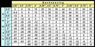

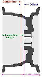

Same thing different ways to measure.
Offset if the distance from center point of wheel which doesn't change with wheel width. Backspacing measures from the rear face of the wheel to the center mount (see conversion below based on wheel width)
EDIT: The less backspacing you have the further your wheels stick out from the vehicle

I went through some of this when I was looking for wheels. Not sure if I'm describing it 100% right, but here was my take on it...
Offset is a more generic number. Like you said, it defines the distance of the wheel body from the centerline of the wheel. How it differs from backspacing is that you can have completely different sized wheels with the same offset, but they would not necessarily both fit your Jeep because their backspacing is different for different widths/sizes.
The backspacing is the number that matters; it is the physical measurement of the the specific wheel you're looking at. The backspacing may vary across different sizes of the same wheel, while the offset doesn't change.
