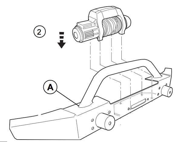

Is it possible to "convert" a non-winch mopar front bumper into a winch front bumper?
Looking at online pictures, it appears provisions for a fairlead need to be cut into the front of the bumper, and clearance cuts must be made on top of the bumper to accept the winch, but I am unsure of how the winch mounts to the bumper itself. Is there an additional reinforced winch plate in the bottom of the winch bumper, or does the bumper itself have enough strength to handle a winch by itself?

I was browsing the PDF file showing installation instructions, and the winch version appears to have holes drilled in the bottom of the pumper to accept a winch. I am wondering if there are further reinforcements not seen in the sketches.

The question Im seeking is... why? Different gauge steel? Added gussets? Added plate?
Id like to make this work, as its being offered to me for $100.

It cannot be converted... look through the instructions and you will see the non-winch version does not have the winch attachment plate and support that mounts to the inner frame supports.
http://www.quadratec.com/Assets/Installation/75750.pdf
I see what youre talking about now. Yeah, it looks like there is a lot more to the winch version than the non.

Iíd say save your money and buy just once. That bumper can in fact be converted to fit a winch. But unless you have the tools and know how, donít even attempt it. And if you did try, by the time you bought the proper steel plate, tubing and what not, you would be close to the cost of a new Mopar winch bumper anyhow. I know, thatís the kind of stuff that I do. You want to mount a winch, then get a bumper designed for one. Forget that other bumper.
