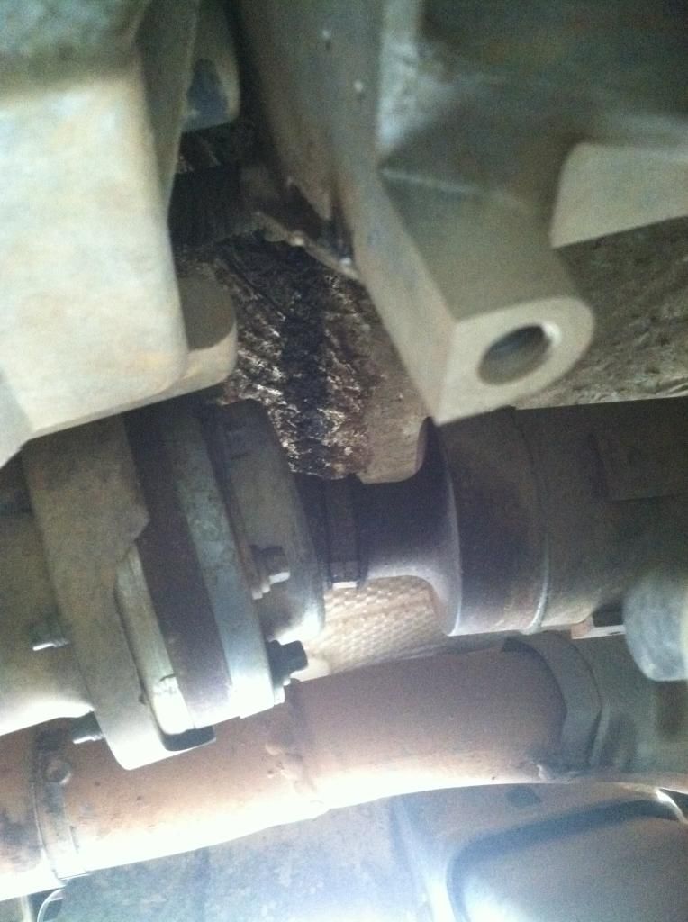

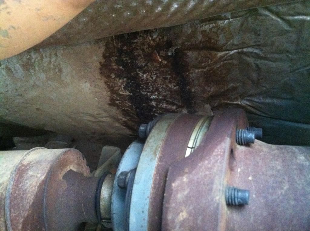

Front driveshaft finally went, was getting a chirping sound when driving and I couldnt tell where it was coming from.. so I went under and just started looking at things. Found the front driveshaft near the TC left a spin mark of gunky grease. So I could only assume that the sound is from the bad joint. Might as well upgrade now!
Whats the cheapest/best aftermarket shafts? Thinking tom woods.. or having a shop around me build one

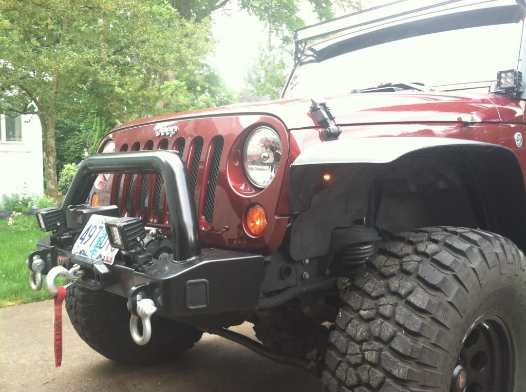

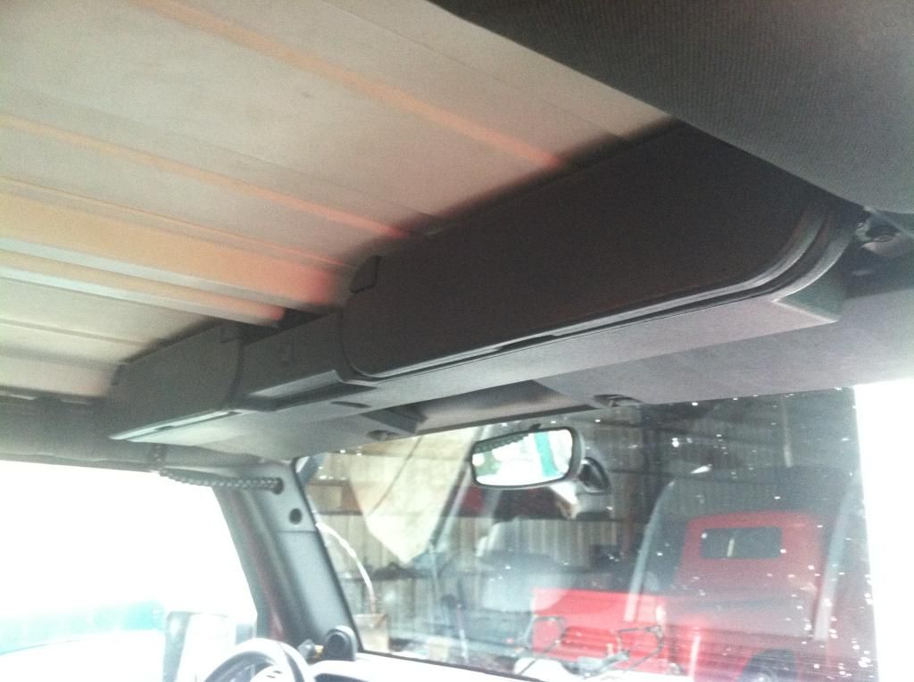

Girlfriend for our 1 year anniversary got me a VDP overhead console. She secretly snagged one of my quadratec catalogs and found something for the jeep! Sneaky one she is.. Im surprised more people dont have these! They dont lock which is the only downside, but I might find a way to make them lock. Otherwise, really happy with it! Also added some LED markers.

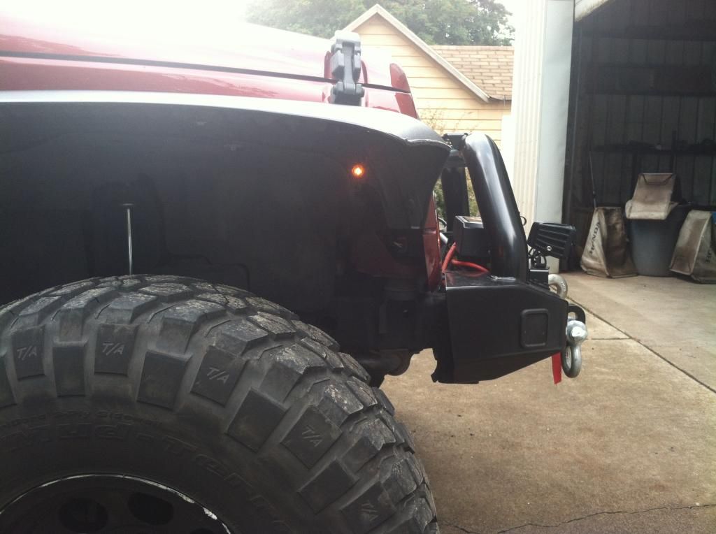

How hard was it to install the led marker lites?? and where did you get them?? Thanks

Super easy, drill 3/4" hole anywhere and cut off the existing side marker harness and splice the wires. Test them to see if they match white-white black-black. I had to switch mine white w/ black.
