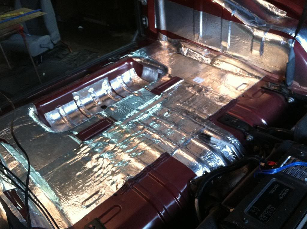

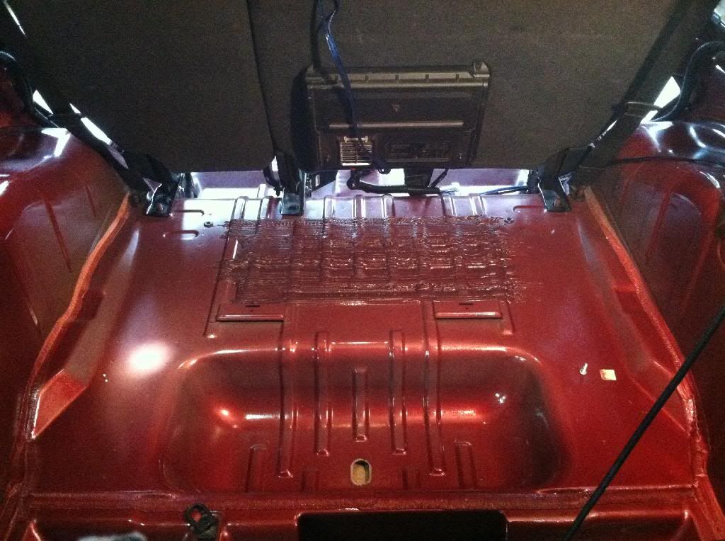

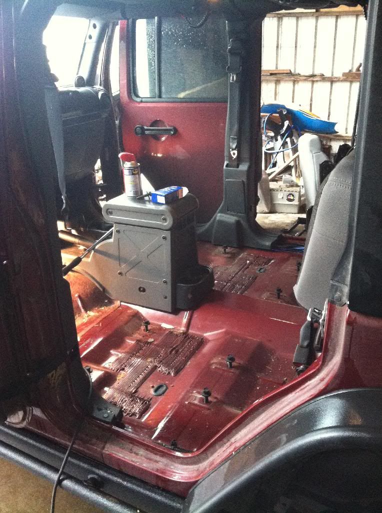

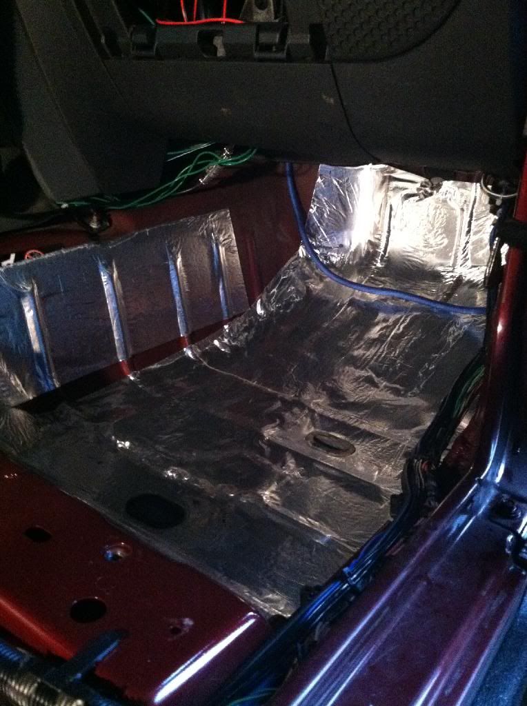

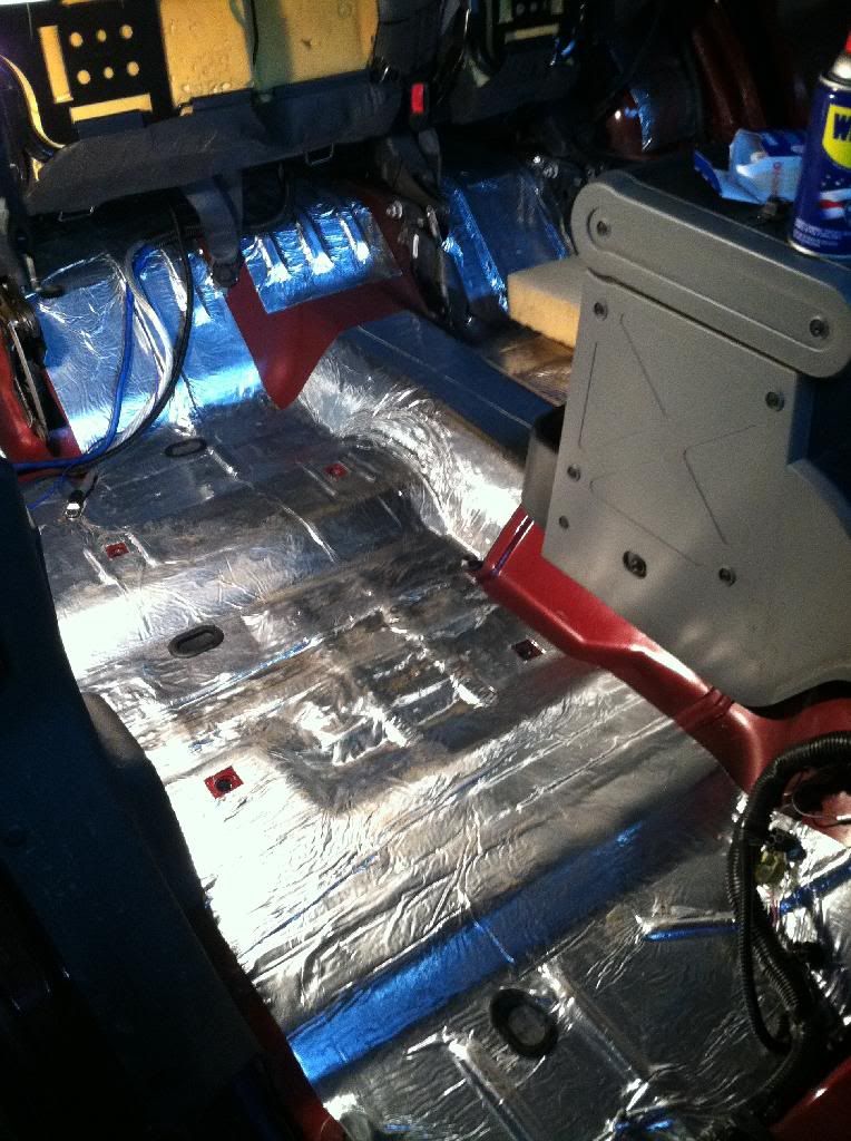

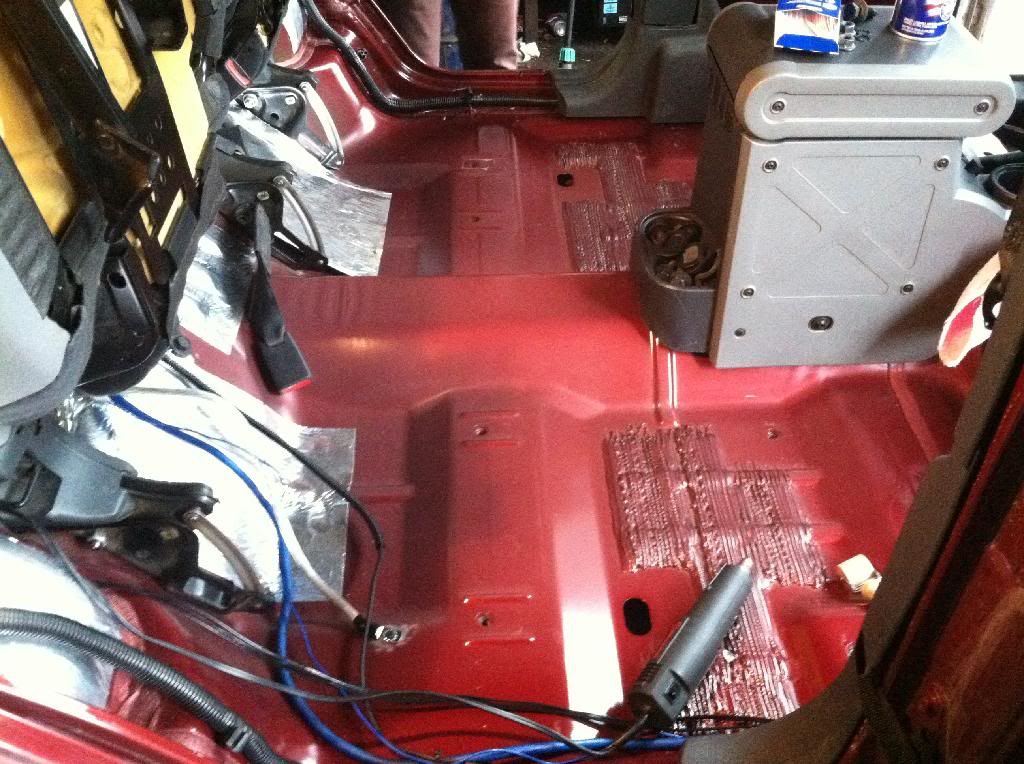

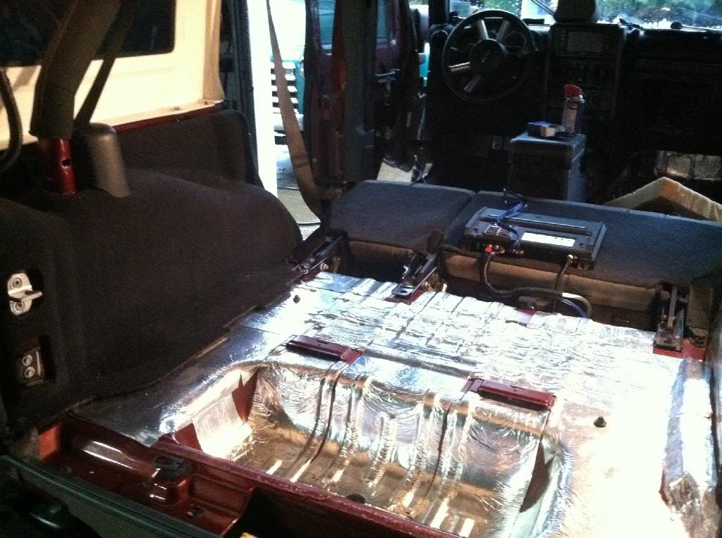

Today I went and did the sound deadening project. Wasnt too bad, took my time with me and my buddy, took up a total of 6-7 hours with cleanup. We just took the front seats out and the rear bench bolts so that they folded up. Went very easy, stuff was manuable with a heat gun, and the improvement in sound is crazy. I can hear myself breathing, its weird! Cant even tell the Jeep is on. Pre-installation was pretty simple, just vacuumed and rubbed it with rubbing alcohol and made sure there wasnt any dust or dirt anywhere.
The stuff we used was fatmat, with butoyl. No asphalt, so no odor. He bought the 100sq. feet roll and gave me half. We used maybe 40% of the 50sq foot roll. Might put some in my girlfriends car now!
Heres some progress pictures we had. There are some uncovered spots, but we found that it didnt have to be completely covered. I very happy with the results. Also decided to keep the stock "insulation goop" there, and just cover over it.
Putting the carpet back in, all in all well worth it!
MoonyJohn is offline

After driving it around some tonight, I couldnt be happier. It is raining really hard, and the highways are full of water channels and the best part is that I couldnt hear anything. Not even the water splashing up in the wheel wells, and I cant even hear my tires hum anymore. Actually kind of bummed about that, I liked the hum lol. But road noise, vibrations, audio system sound quality, talking to one another in the back seat from the front seat is all perfect. I used to listen to the radio at around 16-18 volume, I never raised it about 12 unless I wanted it cranked haha.
I would recommend this stuff to anyone! Especially those who are on phone calls alot, or have passengers alot. Its probably one of my favorite mods ive done on my jeep so far.

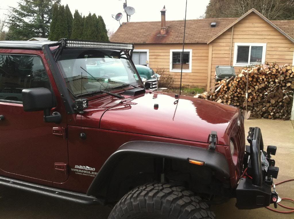

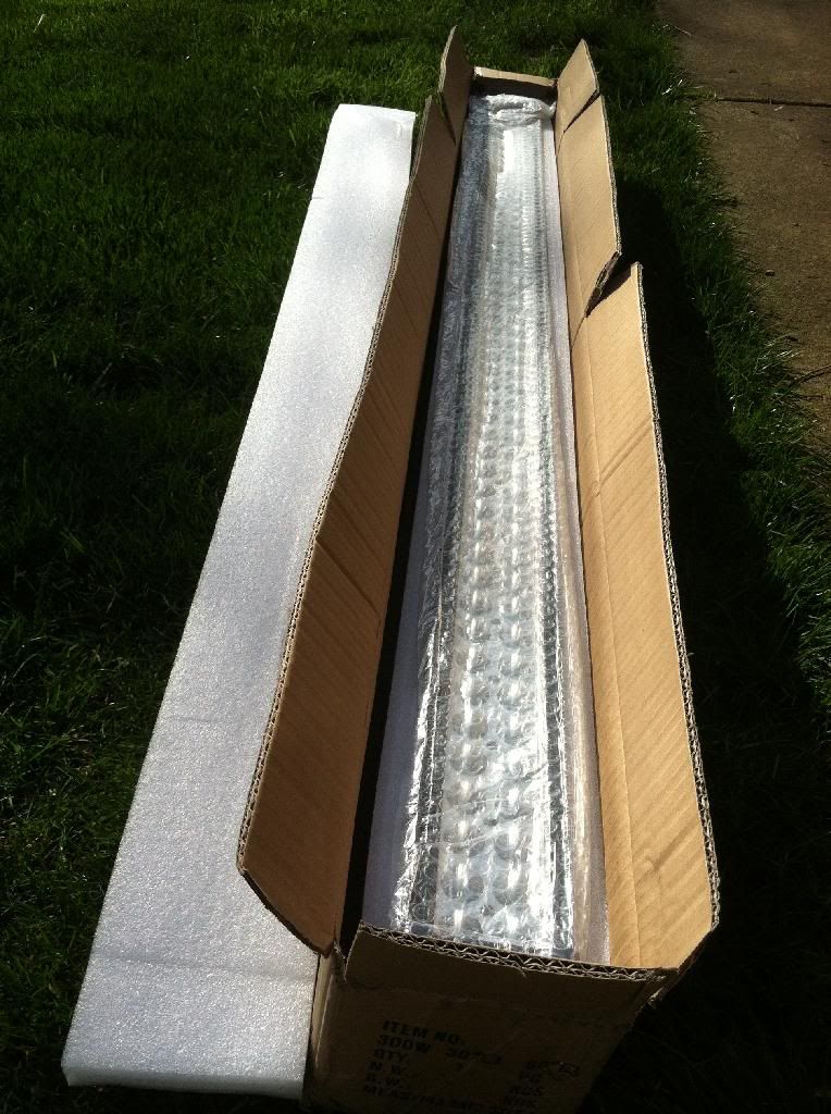

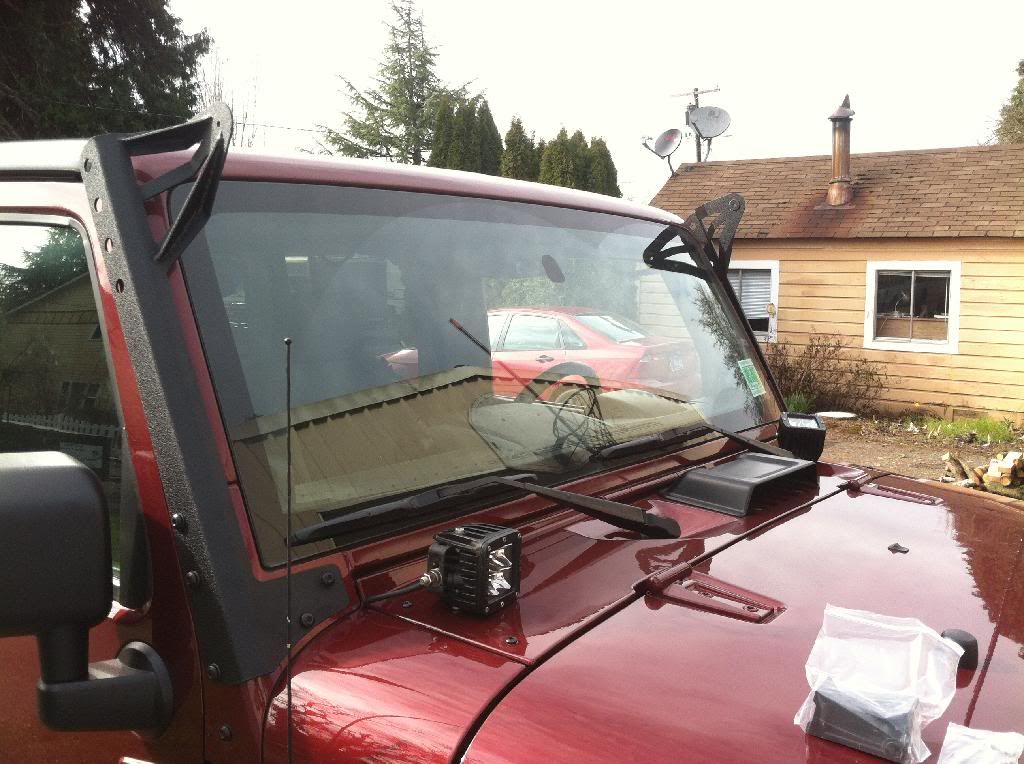

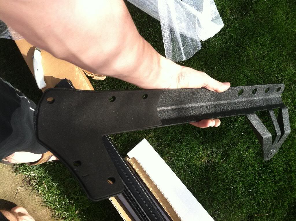

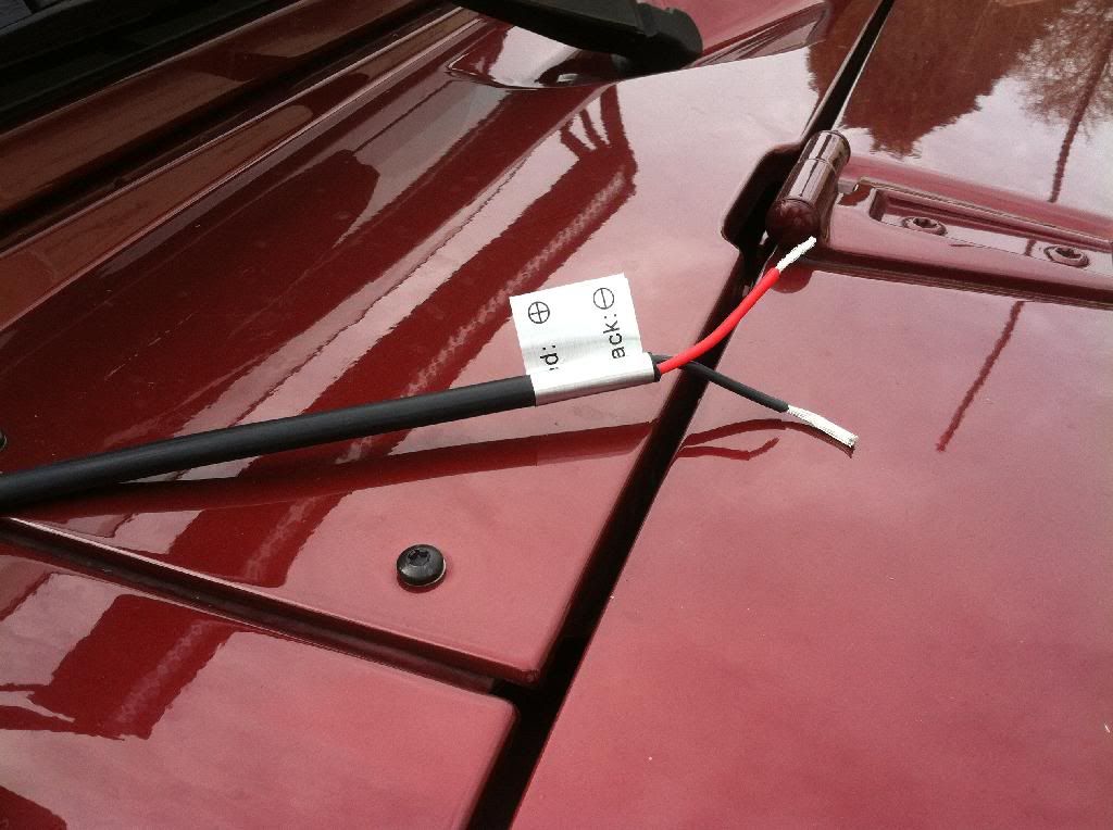

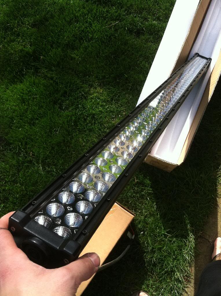

Installed a 50" ebay bar and brackets.. Love the light, hate the bracket. Light was well packaged, had a very very minor ding in the vent on one side but its been common with these ive read. No wiring harness so I had to go to autozone and get a relay and some 10ga. wiring with a few packs of door mold trim for the vents. The whistle was awful, almost deafening! And I work in construction so I know loud noises haha
Heres some unpacking pictures of the bar
Pretty
Bracket (Junk BTW) never buy this. Its ugly, has booger welds, sticks out at the top, and the fit was terrible. I dont even want to get started on it. All I can say is save yourself a hassle and get a good mount. Im currently waiting on JCR to come out with theirs soon so I can toss this crap.
Mounted. You can kind of see how they stick out up top
Everything together. PITA with the windshield mounts for the dually's.
All thats included
iPhone pictures at night. Pictures do not do justice! Its a widespread beam and its very even
This is a better shot. The light never stops!
Overall very happy with it minus the bracket. Do yourself a favor and get a good one. I wouldnt hesitate to get this bar again.
