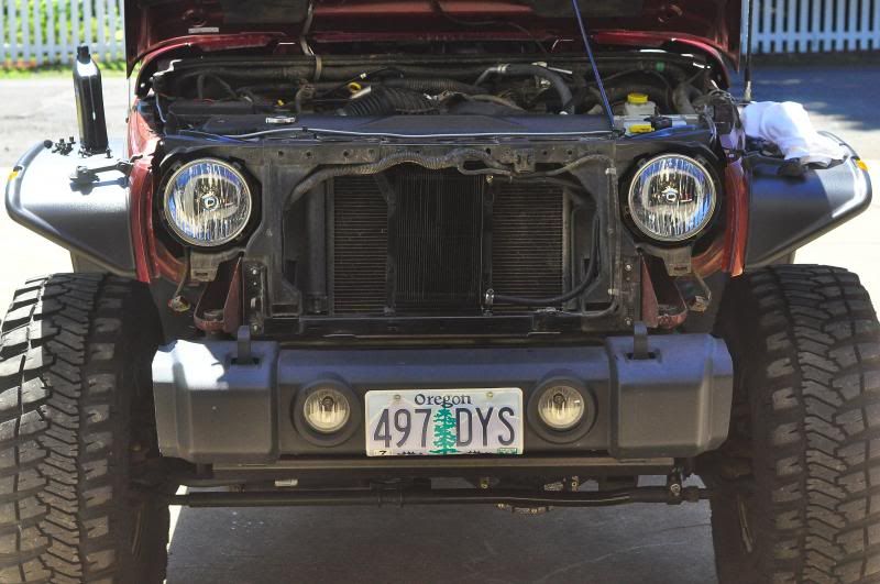

Picked up a couple things.. Got new headlight bulbs, i chose the silverstar ultras 4000k bulbs. Its amazing how much brighter these are over the stock yellers. I dont even need to run my fogs now, speaking of which now I need some for them too. Also picked up a fire extinguisher, for the future camping trips and hot summer days. You just never know when you might need one! I picked one up at home depot for 20 bucks, and made a velcro strap and a couple zip ties until I get a mount for it here soon.
Coming on order soon!
- Solid 30 cover
- ARB 12v mounted air compressor w/ their orange hose
- Coverking front and rear seat covers, couldnt pass up the sale they were having on quadratec!
Going wheeling tomorrow, should be some pictures in the future as well
You can see how much whiter they are compared to the fogs
Tada!

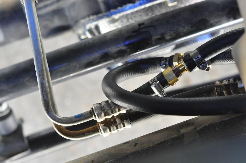

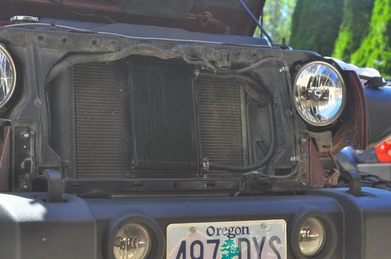

Added the B&M transmission cooler today. It was low 90s today so working with sweaty hands and transmission fluid sucks. I was cringing when I was cutting the hose the first time haha. All turned out good. Only a couple things to look out for. They only give you 4 hose clamps, when really you need 6. The other two I used on the cooler itself. So just something to look out for, because you will need 4 at where you make your splices. Also, needed 3 feet more line, worked out perfectly and only had less than a foot of hose leftover.
Also, make sure that the hose splicers are tight, i had a leak in no time so I added some thread sealer on the supplied parts and it seemed to fix the problem. All in all, it would be a really easy project if it wasnt so damn hot outside! Now I need a temp gauge. I know for sure that the tranny didnt like this hot weather and hills, it was shifting a little slow and searching too much.
Hope this helps anyone whos looking to do this to theirs as well. Id recommend it for only less than 70 bucks! Cheap insurance.
