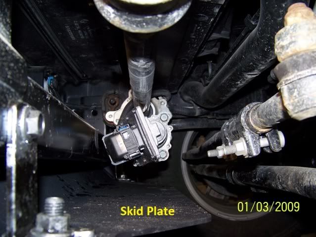

Another thing the air dam does is lower the pressure in the engine bay, which promotes air flow through the radiator.
I removed the plastic air dam, and installed a steel skid plate.
In the second picture, you can see how it protects the e-disco.
This is the set up I have. Works great.
