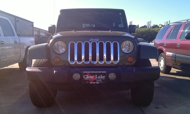

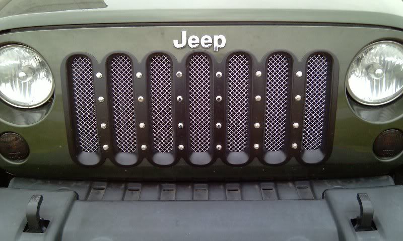

Here is my mesh mod, i used the same mounting system except i epoxied the bases for more strength. My jeep came with this chrome grill and i just took it off and duplicolored bedlinered it then sprayed it with automotive paint (SEM Hot rod black). I purchased some 12 point chrome header bolts and the stainless steel chrome wire mesh from ebay. I think it turned out great!
Before

Looks good Scar. definate improvement over the chrome. I like the buttons, it's different.

That sure is different and interesting. Anyway you could you post a pic of your whole Jeep? I like the colors green and black and would like to see it in its entirety.
