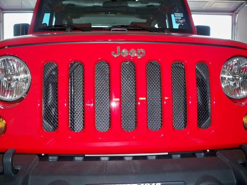

i did this mod over the weekend, metal mesh from home depot, painted it black and zip tied it on. it's held up great so far, had to pick out a huge dead bee today. about $25 dollars and it looks like the brand name stuff!

Did this DIY mod today. It protects the radiator and looks cool. Cost about $20 at Lowes and an hour of my time, and I have plenty of supplies left. I used Gorilla glue to hold down the mounts, as I heard others had problems with the adhesive strips for the zip-ties. The gutter guard mesh rolls were in the far right-end of the store at my particular Lowes. I was extremely surprised at how easy it was to remove the front grill and do this :cheers2:.
