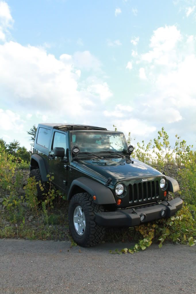

I have lived in Florida my entire life. I just moved up to the northeast and want to make my Jk as capable in the snow as possible!
what do you guys recommend doing?
At the moment im on a small lift and some 34" goodyear duratracs. I have a hi lift, basic recovery gear, and some extra lights.
Whats my next move? planning on an AEV lift after tax returns next year. So waiting on a 'real' lift until then.
