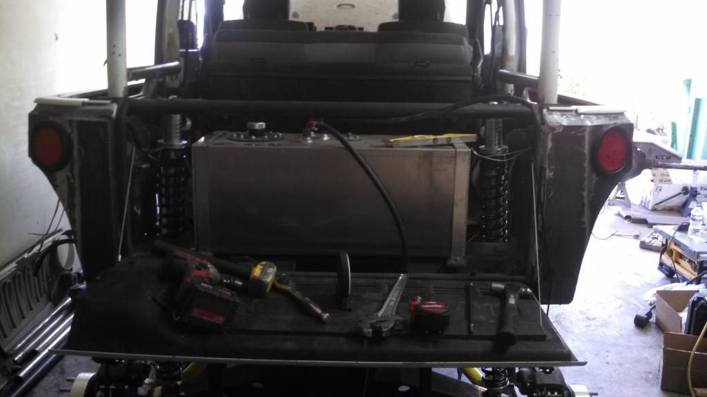

Well rear shocks are in....Mounted them a little different than i planned, and may lose an inch of uptravel for now and cut extra of the body for this setup, but down the road depending where my bumps finally set in after the testing i may move the upper mount down some to regain that little bit.
Would have it standing but realized one of the tires im borrowing is not on the bead and I have no air here.... Will have to run somewhere and get it aired up then stand this pile...

Originally Posted by awinski View Post
regardless. i'm loving it!
thanks man! once i get to the fine tuning down the road i may redo them a tad to fully use the shock.

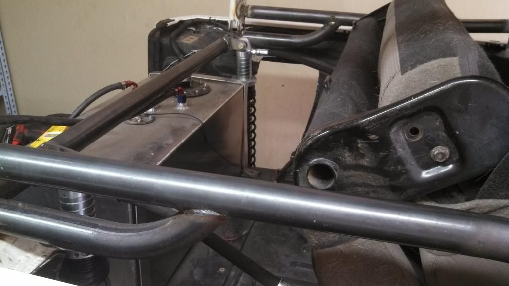

post #742 of 1153 Old 07-13-2014, 10:13 PM
mtnbiker995
2009 JK Wrangler
Location: Kalamazoo
Posts: 963
Just wondering but if you lost up travel, won't moving the upper shock mount down cause you to lose more up travel?
mtnbiker995 is offline
post #743 of 1153 Old 07-14-2014, 07:42 AM Thread Starter
Maertz
2009 JK Wrangler
Join Date: Oct 2012
Location: Neenah
Posts: 2,398
nope. at full bump i will still have about 2" shaft showing, id prefer 1/2-1" to be on the safe side, so me lowering the upper mount by about an inch would leave me where i need to be at full bump. I lost uptravel not to clearance, but to the shock position. I have to test yet to know exactly where itll be, and i may be even be able to remove a little bumpstop to makeup for it depending how far into my corners my tires get...

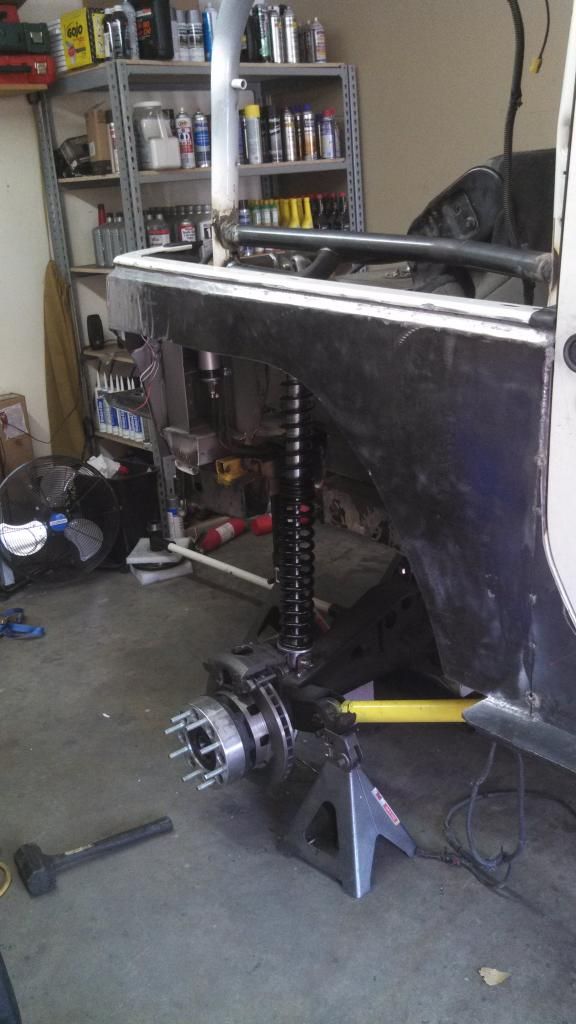

Heres a quick pick of it standing, and with the shocks charged up. Still need to play with ride height and get it all level but will probably wait until i get the correct tires. These are on 37 irocks that measure out to 35... So with 40s it wont look like such a big lift... This ride height is about 4-4.5" lift
