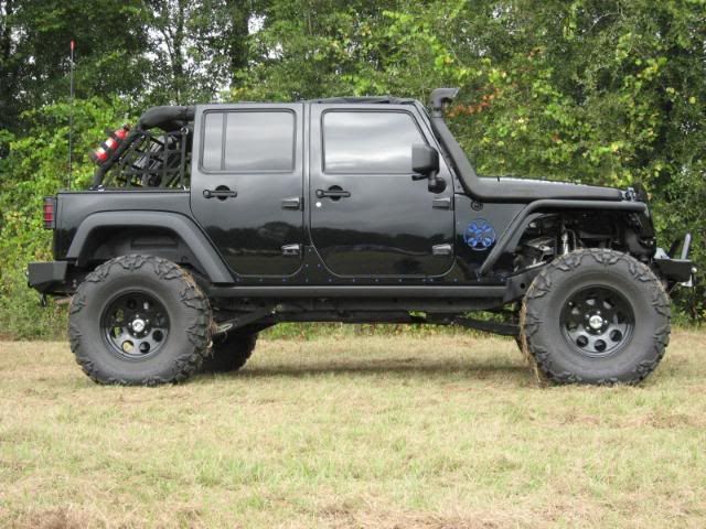

Just took these today before I helped mount some 40"x14.5" BFG KM2's on Jason's(WFTW)Jeep.
This is a TF 3" lift/spacers up front to level it. I'm running 37"BFG KM2's with no rubbing.
And just for the heck of it. 37"s vs. 40"s

Holy cow, dude! That's awesome! Love it! Did you have to use wheel spacers to keep the 37's from rubbing when fully turning the steering wheel?

TF 3" lift, spacers up front to level it out, spidertrax 1.5", I added longer brake lines due to the stock(relocated) lines getting taught at full droop, lots of trimming.
I like it. It keeps me low (LCG) but still clears the tires. I'm planning on adding a sleeve/gusset kit for the front soon.

disconnects in the rear?
Ah yes. I forgot about that. After I added the lift (about 10k miles ago) I was still running the stock 32"s and the rear sway linkage rested on the tires. I switched the linkage to the inner side and at full flex it scraped the frame risking the hard brake lines. I took it off until I got spacers but forgot to put it back on.
I've been running without the rear sway for about 10k miles. Hasn't been an issue thus far.

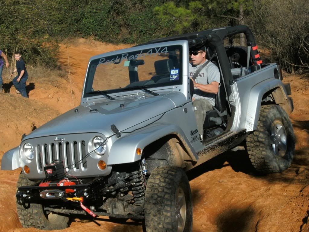

This is horrible. Almsot every picture of a lifted JK is on the street, parking lot etc. Where are the trail shots?

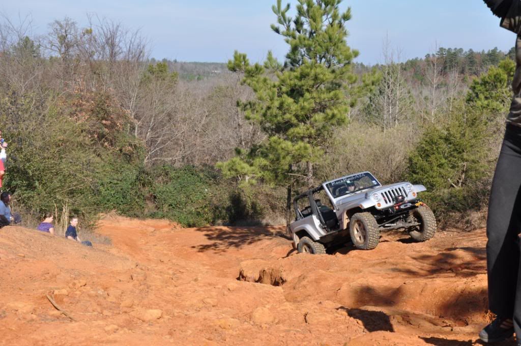

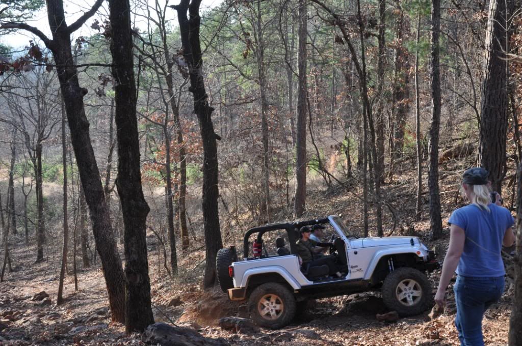

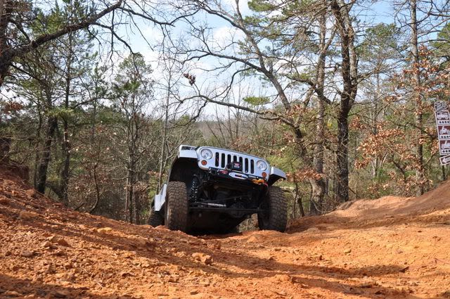

here is this better?

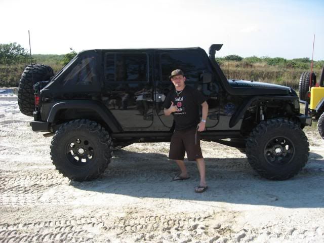

Here's Jason's (WFTW) Jeep which is going to be raffled off after the WFTW program.
Side by side 40 vs 37
Forgot to disco-needs longer shocks too.

why it look like theres no air in the tires?
