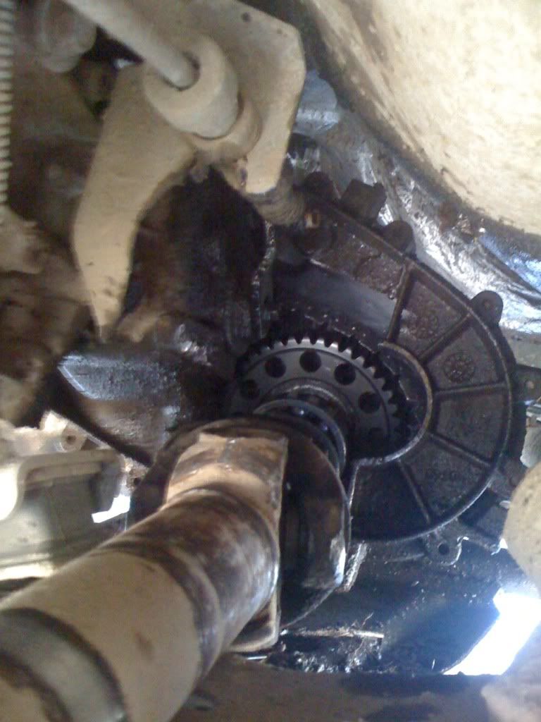

ok soo my buddy buys a lifted 4 door built by BDS and he's comming down US23 about 30k miles later and his t-case detonates. now its not a rubi but i'm wondering if i should put a rubi t-case back in or if i'll have any problems doing that?? i know the 4 to 1 low is nice to have but is it much stronger?? and i dont think he wants to spend atlas $$... suggestions??
I would go rubicon or atlas.....the rubicon is stronger then the other models, basically bulletproof. If he does rock crawling then get the 4:1 ratio at the very least.
Ive never seen any JK T-case blow up like that, wonder what happened.....
Wow, that’s one hell of an explosion. As far as the Rubi transfer case being stronger than a non-Rubi goes, yes the Rubicon case is a whole lot stronger.
yeah its pretty nuts, I'll put up more pics when i get it out of the jeep. cause that's not the only place its cracked. i have a feeling that its going to come out in 3 or more pieces...

I'm gonna have to second this question. As far as I know the actual outer case of the rubicon tcase isn't any different that the non-rubi case. So aside form the gear ratio being different I'm about 98% sure there's no real strength advantage of one over the other.
Most tcase failures in jk's w/ larger lifts are due to cyclic fatigue of the aluminum in the transfer case housing caused by driveline vibrations. The vibrating of the driveshaft causes the material to fatigue, stress crack, and then eventually fail. Resulting in something much like the picture above.
It happens in other jeeps as well, I've seen it first hand (at highway speed at that). Moral of the story is don't ingore driveline vibes associated with un- balanced driveshafts, bad ujoints, crappy pinion angles, etc.

ditto on the DS vibration problem esp if the pinion angles on stock DS were not corrected at a higher lift (looks like about 3 to 4 in from the phots).
what kills me about all of this is that BDS bought this jeep new and built it and it only has like 30k miles on it and their going to do nothing to help him out. @ RpckyClymer i'm not sure on what size lift it has but i know its a BDS LA possibly a custom lift on a 37-13.50 i'll get all the details on it this week end when i get on it.

Sorry it took soo long to update on why this actually happened. The death wobble was soo bad In this jeep that it caused the dual u-joint in the front drive shaft to explode In turn causing the t-case to detonate. I ended up replacing all of the link bushings front and rear, upper and lower ball joints and installed a dual steering damper as a posed to the single that was in it. Tom woods warranted the drive shaft but I was unable to put the atlas in because it was clocked wrong and installed a rubi instead. Good as new.
That's caused by un-corrected front driveline angle and the resulting vibration. Need to correct that when installing another t-case. The Rubi cases aren't any stronger than that one where the issue noted is concewrned.
