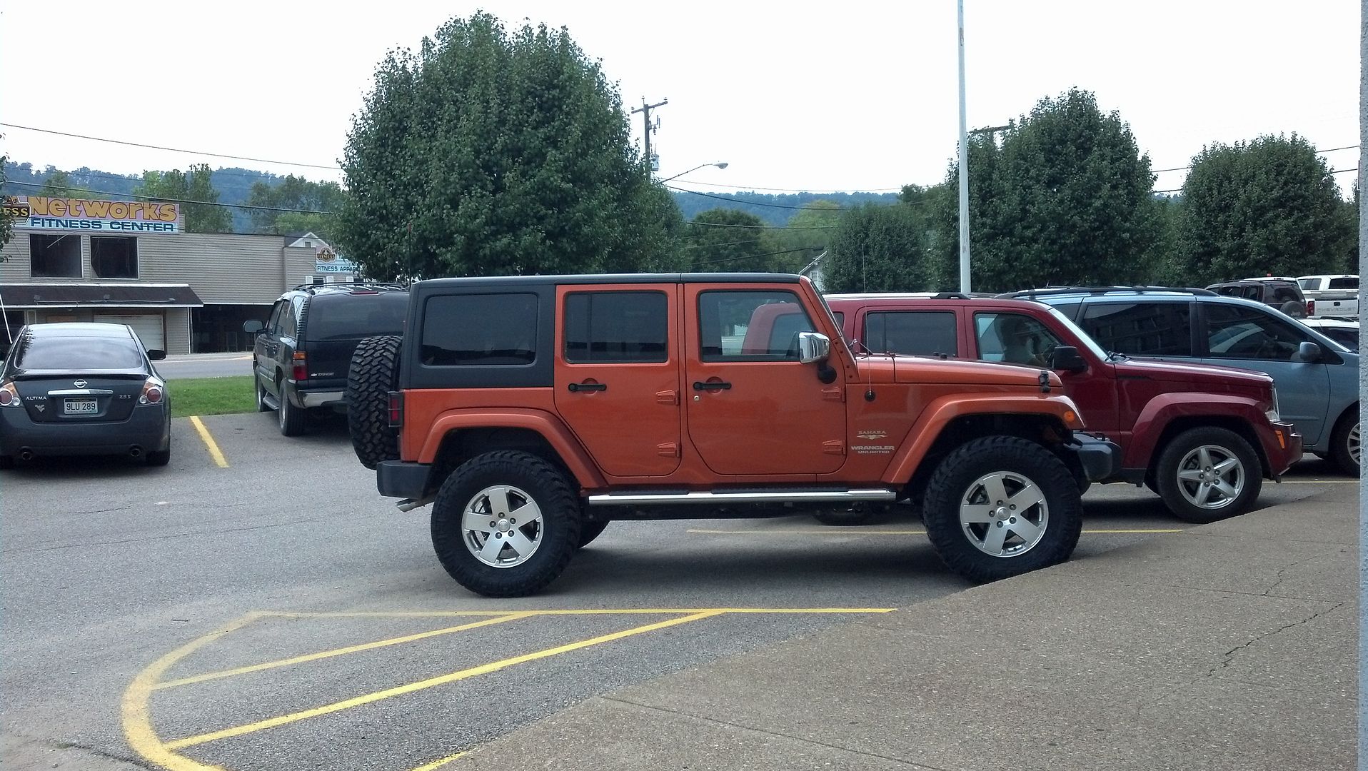

Joiner
2011 JK Wrangler
Location: Round Rock
Posts: 89
It is a XRC M.O.D. bumper with midwidth end covers. Here are afew more pics. 2.5" Lift with 35's will work. If you are going to be doing alot of flexing i would probably go with a 3.5" or higher. On my 3.5" i went out and disconnected by swaybar and was pretty easy getting my tire entirely up in the fender and even rubbed the fender pretty bad.
