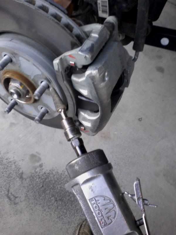

Here is are a couple pictures of why the back part of the punch holes on the Soft 8s can sometimes rub (notice how thick and far out the bottom rim of the caliper sticks out):
If you have to grind a little material off, this is where:
This is a Dana 30 front axle caliper (see how the part of the caliper in question is more rounded and doesn't stick out as far):
This is the process:
I used my daughter's sidewalk chalk to cover the areas identified in the above picture. Then, I would put the wheel on with 2 lug nuts moderately tightened so I could turn the wheel and listen for rubbing. Then, I would remove the wheel and see where the chalk had been rubbed off. I ground a little material off those areas, re-applied the chalk, and repeat. After repeating a second time, I had elminated all the scraping/rubbing on the drivers's side. The process was the same for the passenger's side.
After I finished, I painted the areas I ground with some grey anti-rust primer paint.
Hod rod builders have been grinding calipers for years. I have not heard of one problem here or on any other forum for those who had to do a little grinding to make 15" Cragar Soft 8s with 4" backspacing fit.
