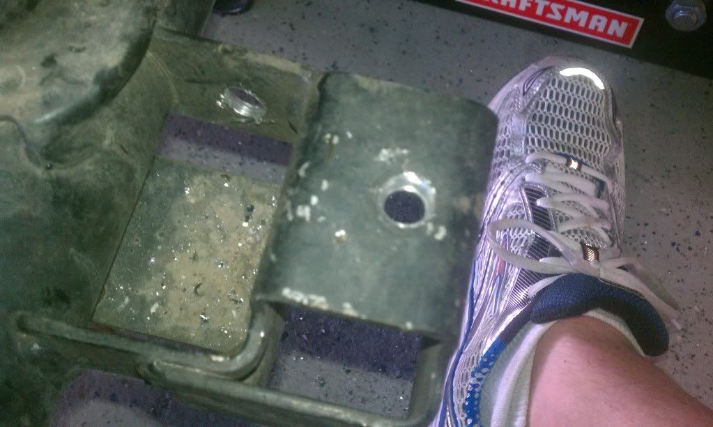

Metal drill bit so you can modify the rear trackbar bracket.
Someone to weld the new bracket on the rear.

Top pic is one of a couple of holes that needed to be drilled.

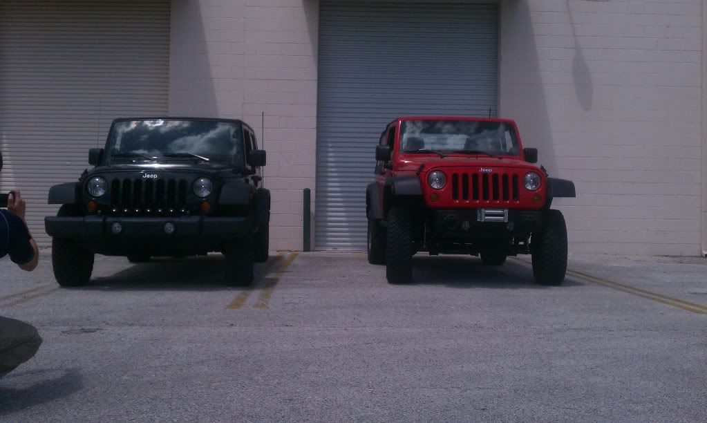

Second is the lift installed, finished like 10min earlier, next to my friends jeep. We went to put the same lift on his.
