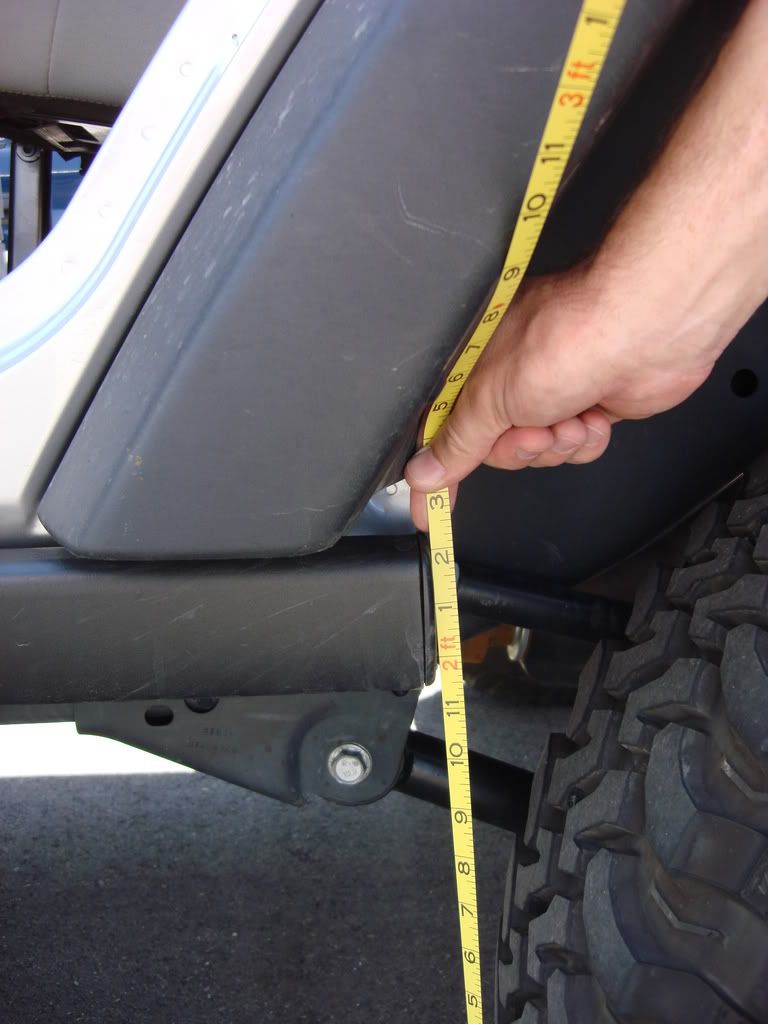

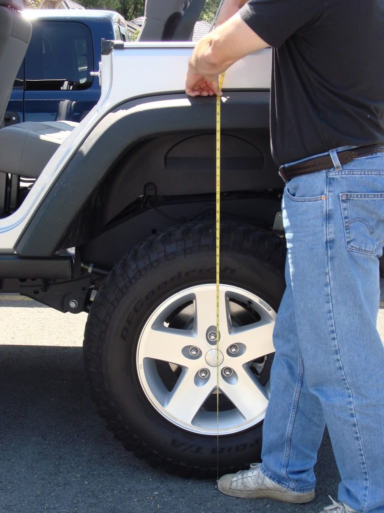

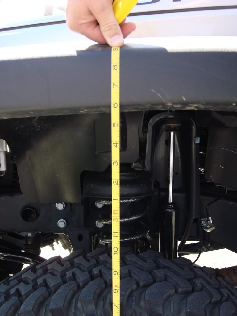

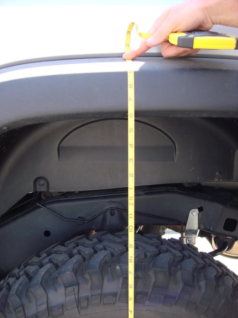

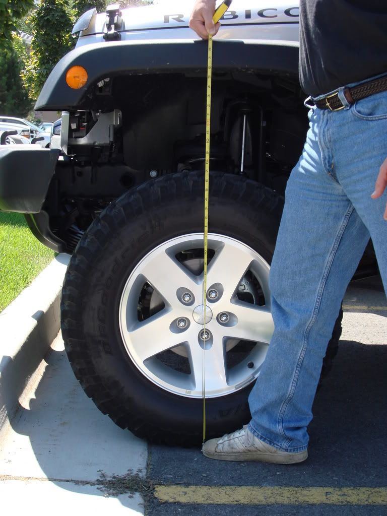

I didn' thave the lid or doors on but I got some measurments to the fenders and sliders so you can measure yours and add the difference. I am curious as to what those numbers are as well since I never measured mine prior to installing the lift. So if ya can, please post what yours measures to the same points.
Thanks.
Here is the drivers side front:
Here is the drivers side rear:
Hope these help ya. And please let me know wht yours measures stock so that we can have actual height increase numbers.

I finally go out to make the measurements.
All 4 wheel fenders were the same at 3' 3" to the top of the fender
My rock rails were a little different front 1' 8" rear 1' 9" to the top of the rail.
My tires and suspension are stock.
Your 4 inch lift raised the body 6 inches. Wow I am going to have to be careful.
