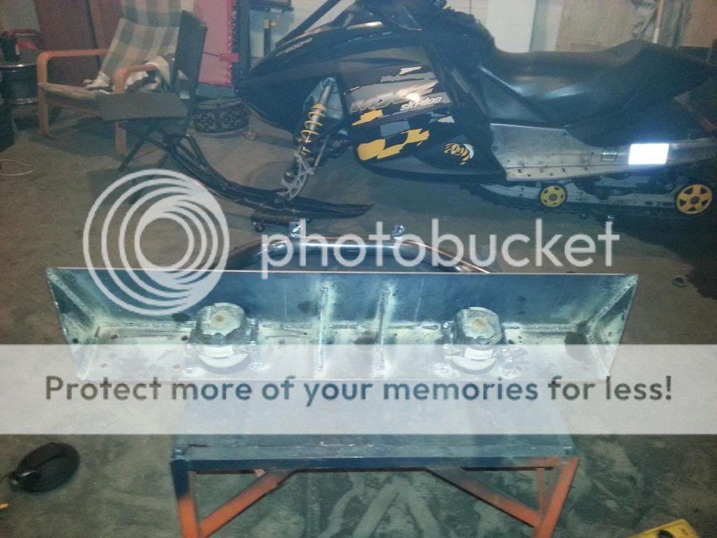

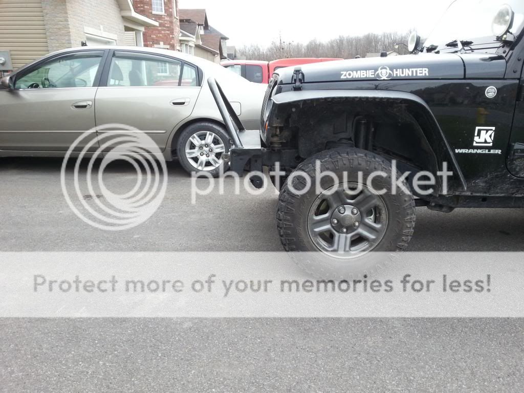

Well since I seem to always be fabbing something up for the Jeep I figured why not make a thread to give people ideas on designs and materials to use.
If you make your own armor post it up!
First stubby bumper (Not many pics)
3/16" plate, 3 inner gussets, fog light mounts and .188w stigner
Now owned by Tragyn
Second stubby, a little more plain (again forgot to take pics)
3/16" plate with .188w stigner
Sold

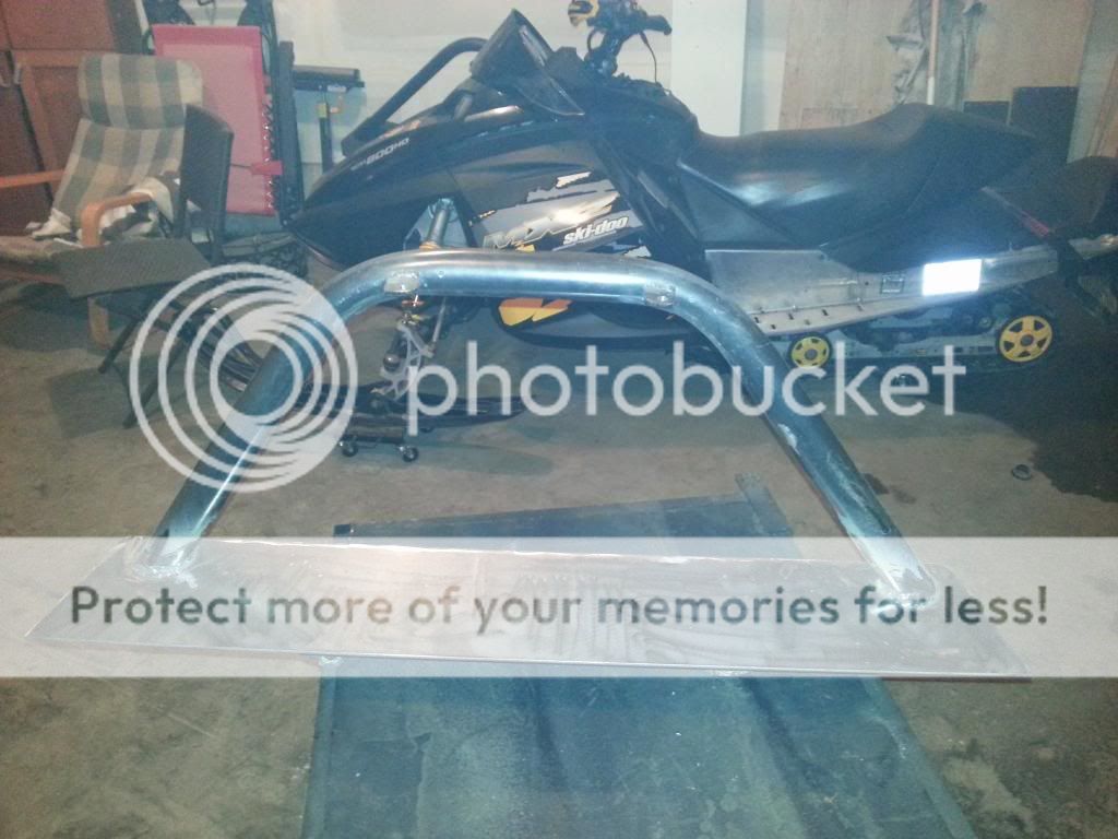

Started like this
Hated design so changed to this

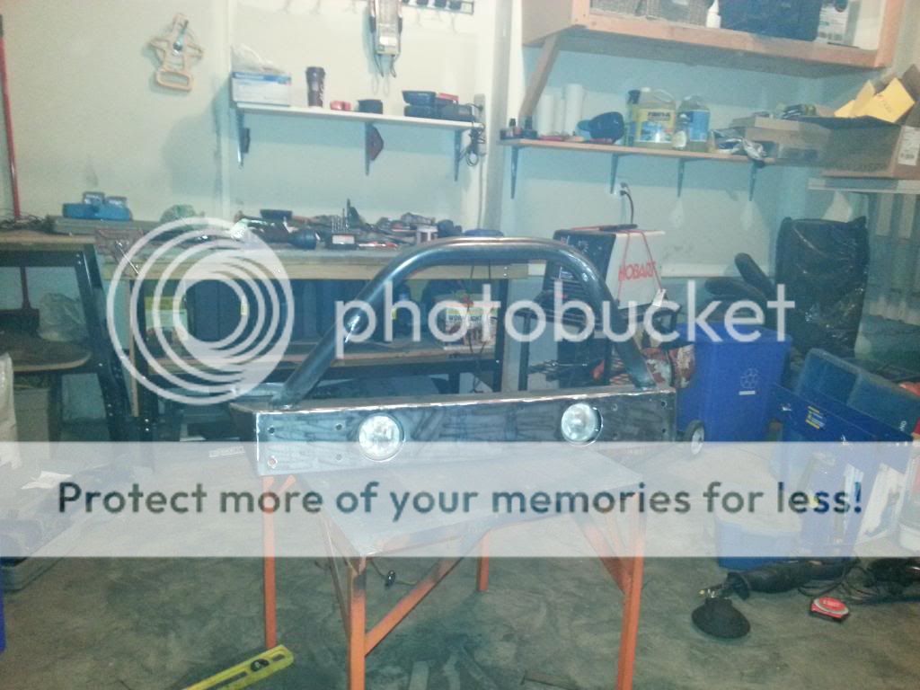

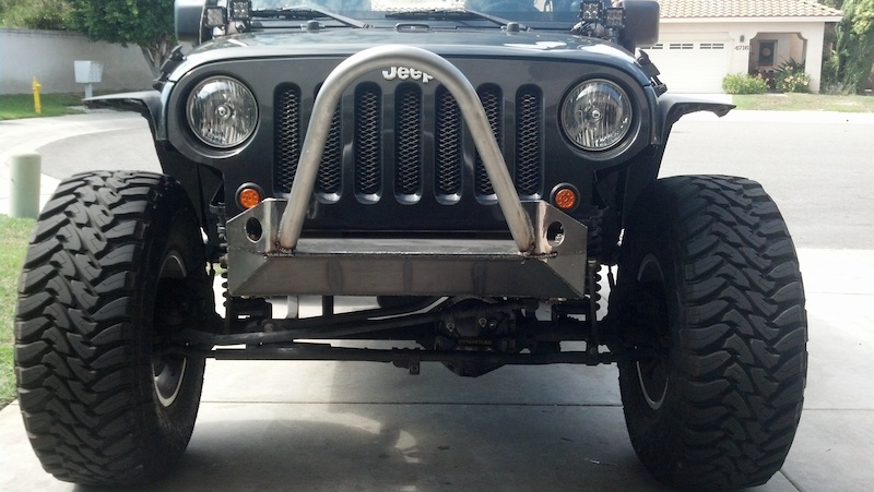

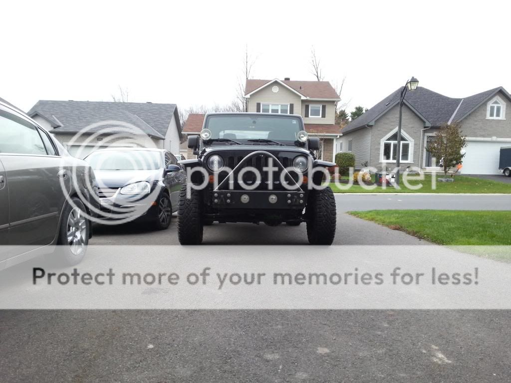

Just finished another tonight. Too dark for installed pics
Stubby, 3/16" plate, 2 gussets, fog light mounts, .188w bull bar with light tabs
Lets see how long this one stays on the JK before being sold

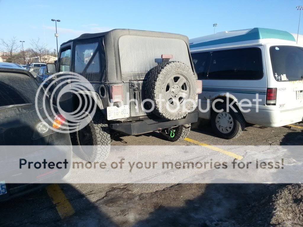

Rear bumper
3/16" plate, lower profile to help not damage body on flex, cross member skid, fits OE hitch

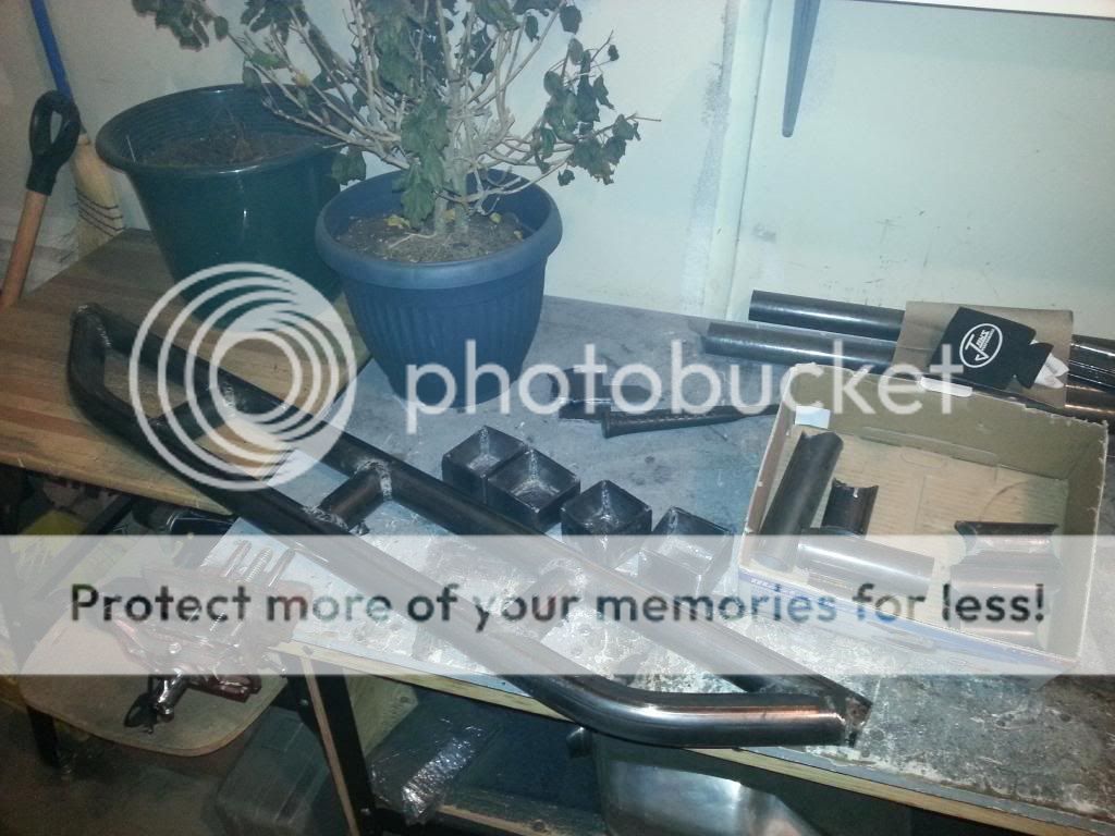

And last for now is the sliders
Fully bolt on, .188w tubing, 3/16" plate for mounts
Your turn

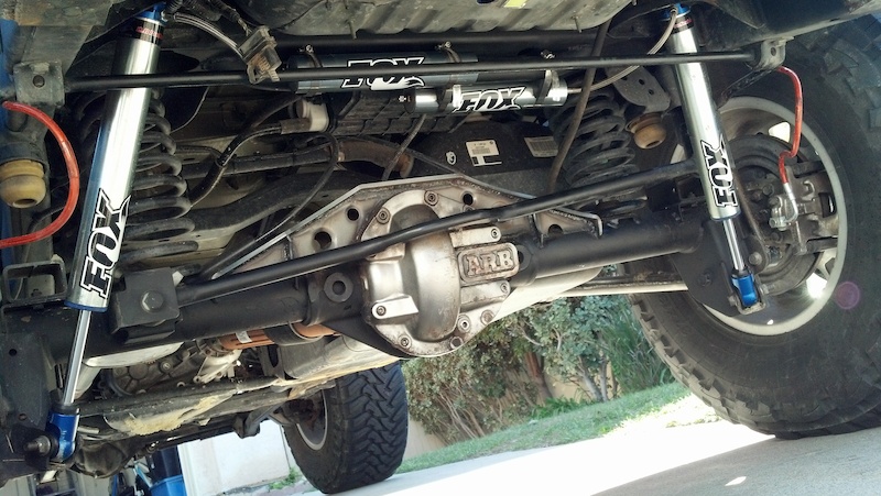

Made my track bar, tie rod, drag link.
Rear trackbar.

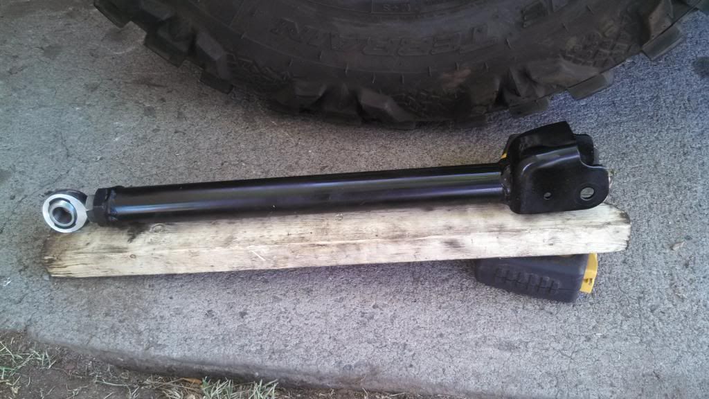

Made all 8 control arms.
Made a hitch cargo rack into a swing out rack
Rear shock relocation.
5 gallon tank holder.
Rock sliders.
These are just a few and some basic info... Some of these pics are obviously not the finished product.

Maertz you chopped your stock arms for the mounts right? Your making me want to build my own

yeah, the front axle side mounts have massive bushings and I was to lazy to weld washers over them or something so i reused that end. Thats the only part i reused... The rest is 1.5 x .250 wall dom on the control arms.

Ok cool, where did you get you joint mounts that go in the CAs?
Pic of bumper I juat finished

I get almost everything from my store or ballistic fabrication. Fastenal actually supplies ballistic with alot of there stuff.

I think i built all 8 for like 425 ish.. All double adjustable while on vehicle except the front uppers.

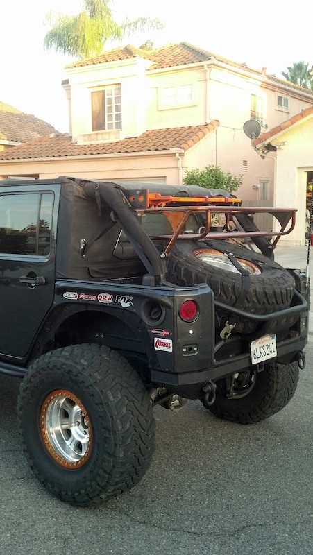

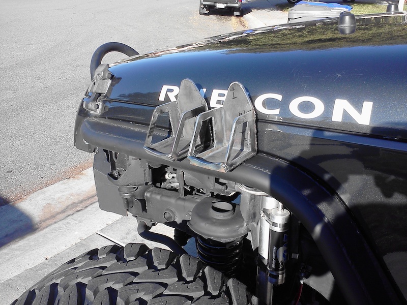

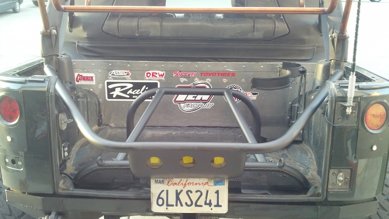

Posts: 800
Front bumper, rear bumper, fenders, rear armor, tire carrier, rear rack, shock mounts, dual rigid light mounts, slider tubes, and a bunch more little stuff...
