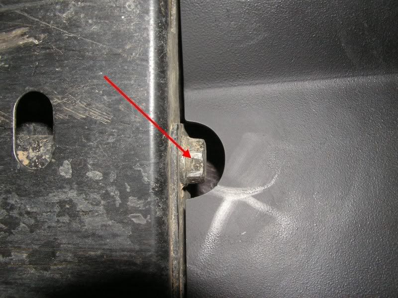

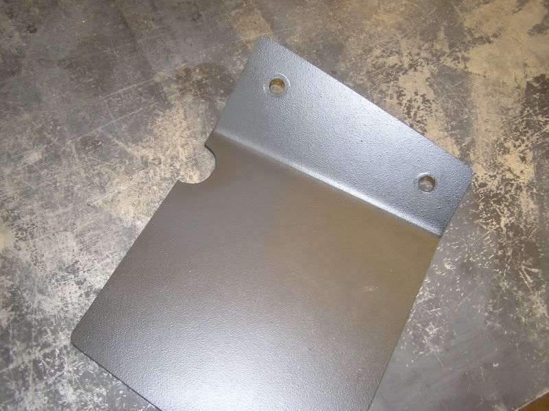

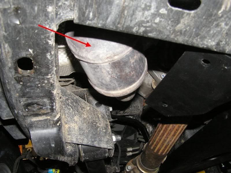

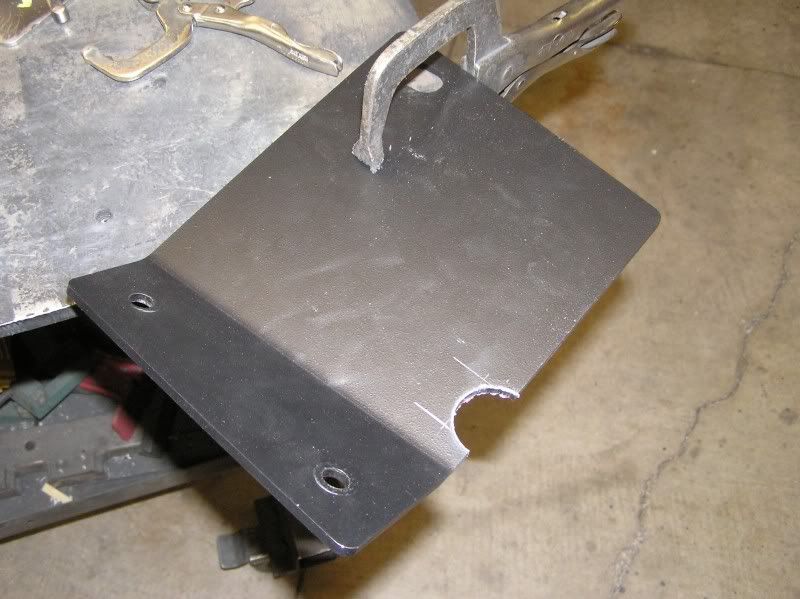

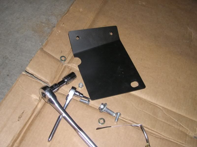

Forgot to add this part. When installing the part of the skid that covers the catalytic converter on the driverís side, I noticed that it didnít quite sit flush against the frame. Looking further I noticed that the reason was because it was hitting one of the bolts that attach the rear cross member to the frame. Even though it was slight, I just donít work like that. My solution was to remove the part that was making contact. Duh. Anyway, here are a few pics of how I did it.
Here's a pic of the catalytic converter to be covered.
Ruff cut with the plazma cutter.
Cleaned-up and painted.
Getting ready to install.
Installed and showing the bolt that was hitting the plate.
If they would just modify the bend on the main plate and the converter plate slightly, that wouldnít happen. Do I still like the RockHard skid, yup, sure do.
