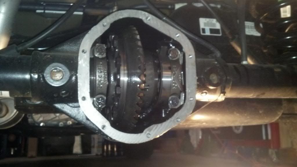

The ARB differential cover swap and JKS track bar. Can you say beefy?...

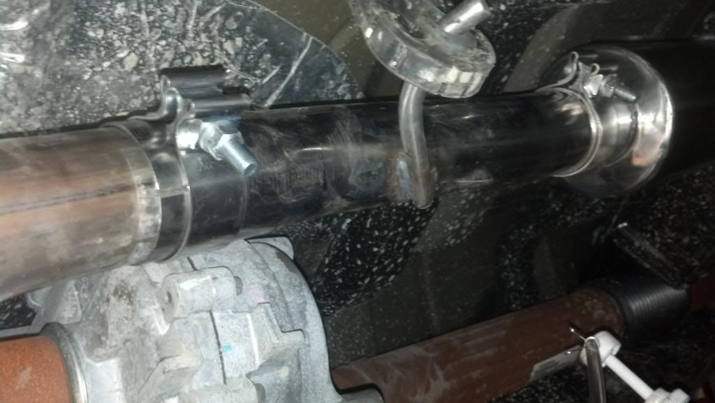

Here are the new MBRP components. I got this kit on AutoAnything.com for around $370.

Here are some pictures of the new MBRP exhaust installed. The stock system was a pain to get out even for a new truck(I ended up just cutting it) but the MBRP went right in.
This is the pile of stuff that came out...
And what went back in. Shiny/roomy...

I also attempted to swap in my JKS front track bar and ARB front differential cover but at stock height with stock bumpstops the two collided. The ARB is more critical/looks more bada$$ so out came the JKS, I was a little frustrated so pictures of the interference slipped my mind...
The two that wouldn't play nice...

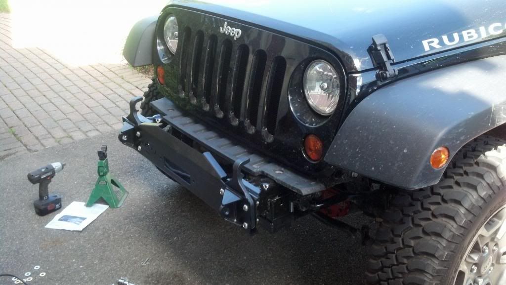

Next on deck was my Expedition One front bumper and swaybar skid. Both of these parts are pretty minimalist but they are relatively cheap and they get the job done. One thing to be aware of is the swaybar skid requires you to cut out the front frame bash bar. The additional ground clearance is great but even I was a light squeamish about taking a sawzall to the frame of a brand new $38k truck. It came unfinished so I pulled out a can of Rust-O-Leum black.
This bumper leaves the frame rails exposed so I started making up some templates for pieces to clean up the look...
Expedition One uses the stock tow hooks to align the bumper, if you choose to remove them you have to drill additional holes. I chose to leave them, even though I would never pull on them (the bumper has beefy shackle tabs) they are great for wrapping winch line or kinetic rope around when you are doing multiple pulls and don't feel like having to take gear in and out repeatedly.
