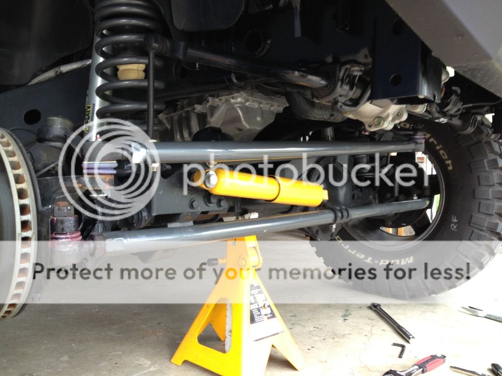

Anyway, just throwing out one option with everything put together for you. Definitely consider input from anyone else who gives it. I run all of this stuff with the AEV 3.5" lift (all bracket welded on the front axle) and love it. Here are a few of my setup...

And just to add, I personally wouldn't ream the knuckle and make your own drag link with leftover parts. That's just me. You only get to do that once and then you've got a bastardized setup until you replace the knuckle. My preference for running all the front end stuff from one company is that it should, in theory, all wear in a similar matter. And everything will match up. Spares are the same, etc.

Brianjw, did you straight drill your knuckle and use the tapered insert, or just ream the knuckle for your DL flip? I don't know how I missed it, but I just watched your video like 10 times, great job!

I drilled the knuckle and used the tapered insert from AEV. I later replaced the AEV drag link with the synergy part and just re-used the insert.
