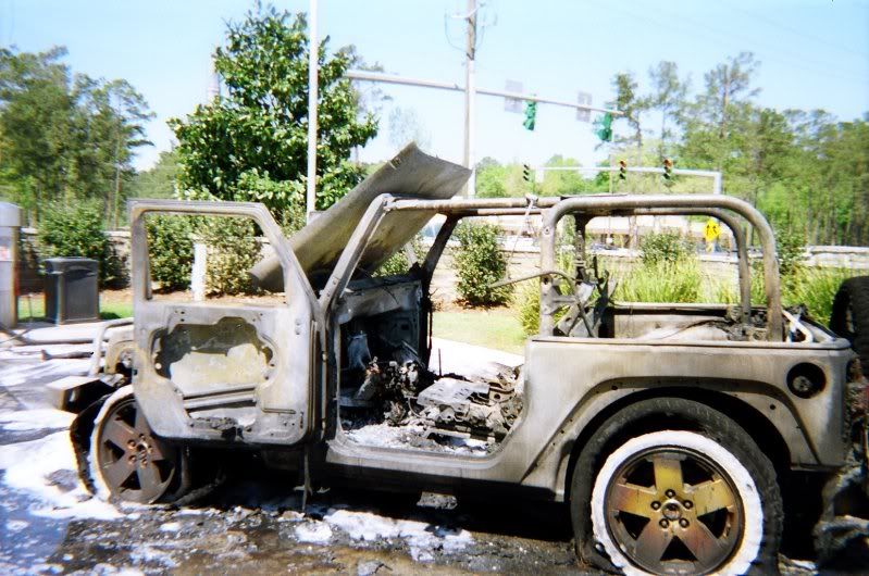

My Jeep caught on fire today while I was driving it. It was an 08 Sahara, pretty much stock. Only mods were a new bumper winch and lights. I was parked at a red light after approximately 15 minutes of drive time when somebody told me it looked like something was dripping onto my muffler and starting to smoke. Then a different car started honking and screaming at me to get out because it was on fire. I have no idea what happened. The last time it wasn't on the pavement was over a week ago and I wasn't even beating on it at all.
Anybody seen anything like this happen? Any insight on to what may have caused this?

I just noticed you said someone pointed out something dripping on the muffler(my bad)...Fuel leak?Oily rag or debris on the exhaust?

Any idea which area the fire started? Front, middle, rear? I've heard of a couple JK's burning but never a definitive source.
Out of curiosity, how long was it burning to get to that state? That sucks, glad you are ok.

well theres a serious problem if something was dripping on the muffler as there is noting but sheet metal above the exhaust. it was prob tranny fluid dripping on the exhaust up by the transmission (in the front/middle). glad you got out ok

there have been quite a few reports of unexplained fires in the past- all of them were 4dr automatics. Which pointed to a possible issue with the transmission fluid overflow. I think this is the first 2dr I've seen.

He said the back was on fire first. A witness said it was in the area of the muffler.
Looking at his pictures, it sure looks like it started middle/up front.

The reason I ask is, in prior fire threads, all jeeps had been in taller/dry grass which seemingly gets snagged up and around the catalytic converter. The cat is very hot, ultimately whatever is stuck up there will eventually burn when it finally gets dried out enough & reaches flash point.
It could have been wet weeds... who knows, but ultimately it will dry out and become flamable.
After time in the field, I like to take a quick "looksie" under the carriage to see what gets stuck on the bottom.

There is a problem with the automatics catching fire because the tranny fluid will overflow and leak out right on top the the exhaust. The pipe gets too hot and the fluid catches fire quickly spreading to the rest of the combustible fluids in the Jeep. I've read about a few of these happening on another forum.
