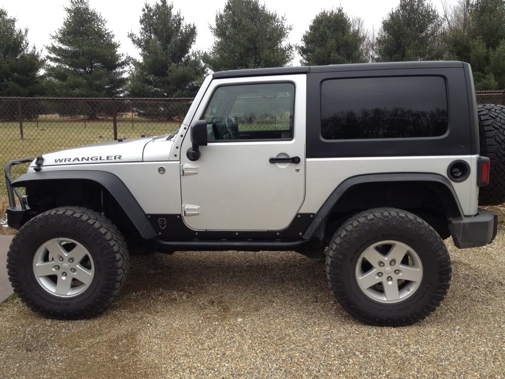

A few installed shots:
I would Definitely recommend these sliders to anyone wanting great looking, very strong, high clearance, and reasonably priced sliders! Another great JcrOffroad product added to my jeep

Is there anything that does between the armor and the body? Always loved that look but worried about water getting trapped and rusting it out...

I put rtv around all edges and just about everywhere between. I also put it on top so water wont naturally run down into it

Typically these kits (JCR, Poison Spyder,Genright, etc.) have gaskets and/or you can buy rubber gaskets for in-between the body and the plate. I don't think that would keep all of the water out anyways - you could alway coat the body/gasket/protection in grease before slapping it on or even silicone the top.

Those look great dude. Been eyeing a set of those for my rig. Seeing how well they fit makes me want them even more.

Looking great! These from JCR are a great option for sliders. They are nice since the come with the body side armor!
