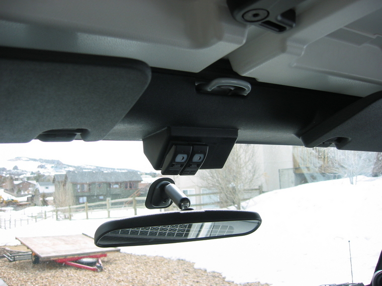

Originally Posted by riptide View Post
Why can't someone make a top panel
Why not just put the Daystar panel above the mirror like I did (and the guy whose pic I borrowed til I find my camera).
WOW that never occurred to me. The $20 solution to 12voltguy & Spod-guys very nice switch boxes (and unfortunately $400 price tag).
Now more questions about that. How'd you mount that? You do a write up on it? Depending on things, I might even get 2 daystar panels to stuff up there (don't need that many switches... yet)...

Another switch mount option - Above rear view mirror - JK-Forum.com - The Ultimate Jeep JK Wrangler Bulletin Board
This is the write up Grimscale used to mount his switches.

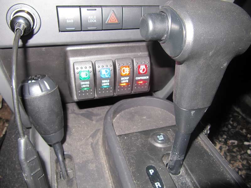

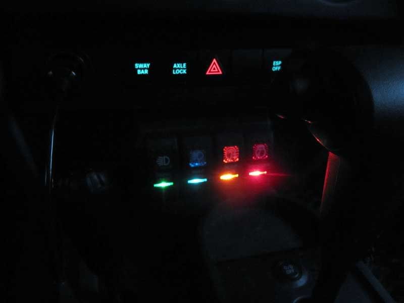

It's less flashy, but I used the Cooltech switch mount specifically because it fit in the same place as the Daystar but worked with the manual boot.
Nice thing was that I was able to mount a junction box on the back side of the plate, and then run a single ground and power line for all the switches.
JK SwitchMount w/LED Tip Switches
So far using four of the five switches with one ready to go when I get the rock lights installed.
I've seen these... and while I'm not set on having to have rocker switches (I've seen other configurations I like), I just don't like how this looks... sorry...
Great idea. That’s exactly what I did on my TJ’s, only I made my own box from radio shack. The JK’s didn’t exist yet, hence no daystar switch panels. I like them up there way better than hacking into the dash. It’s a little more work but the benefits are worth it to me.
